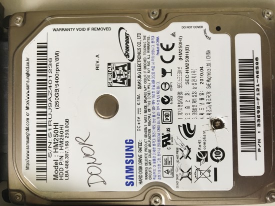

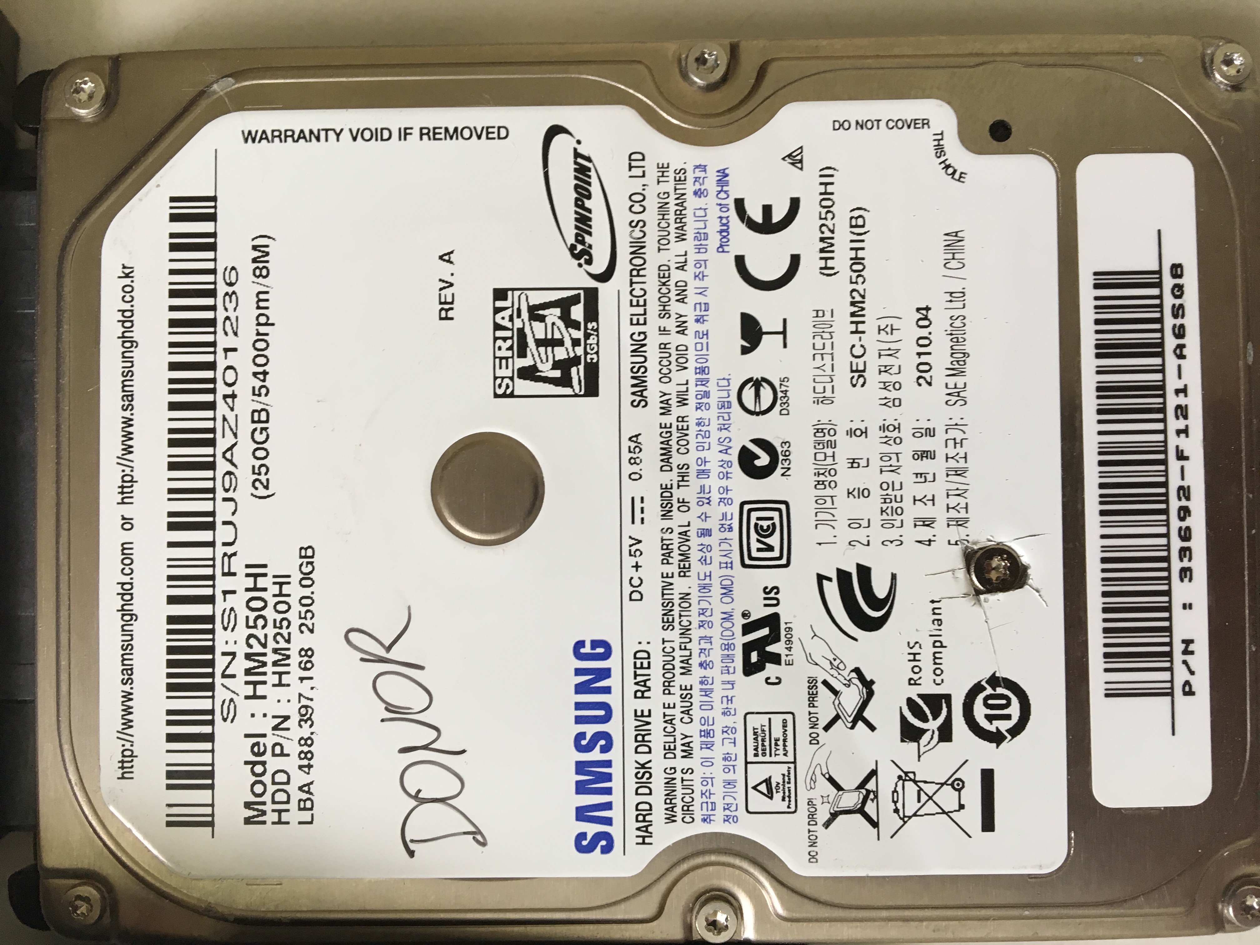

File comment: DONOR

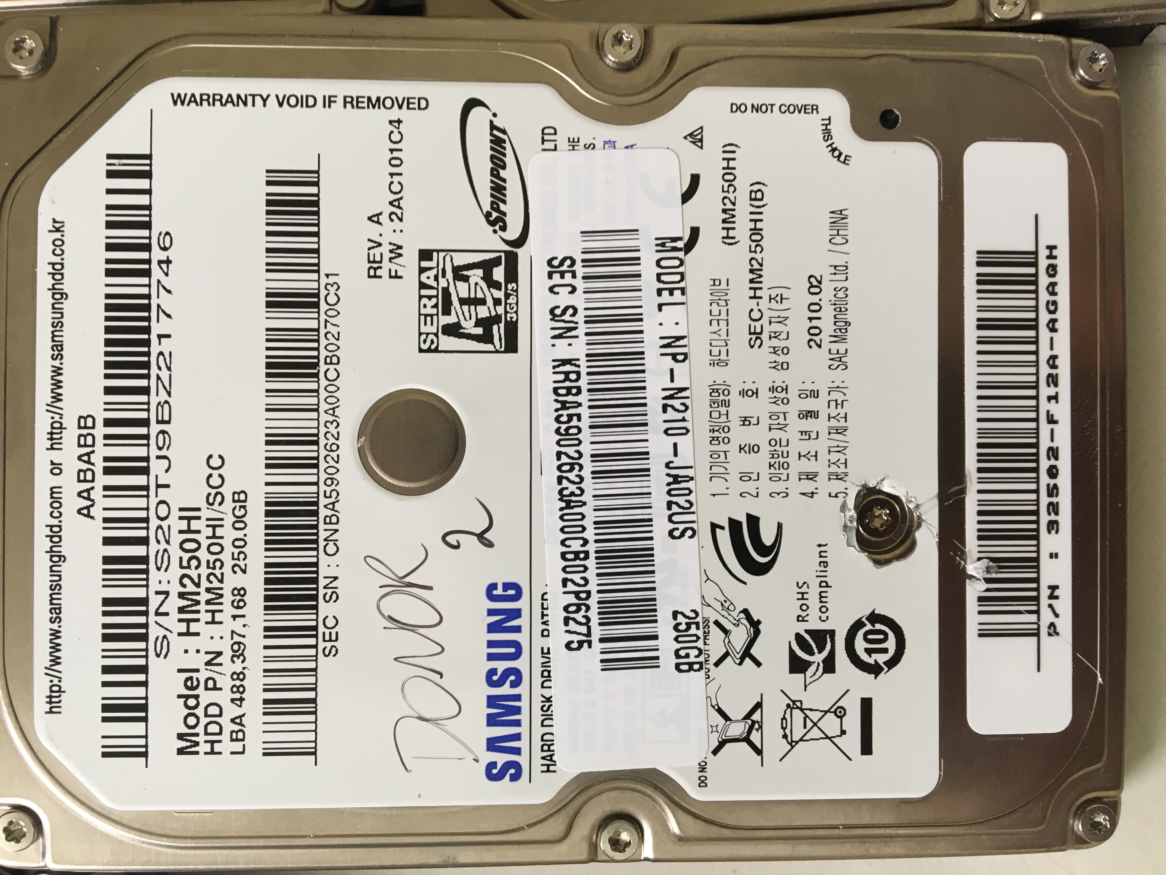

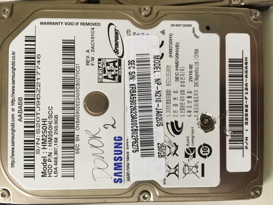

File comment: DONOR 2

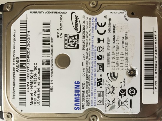

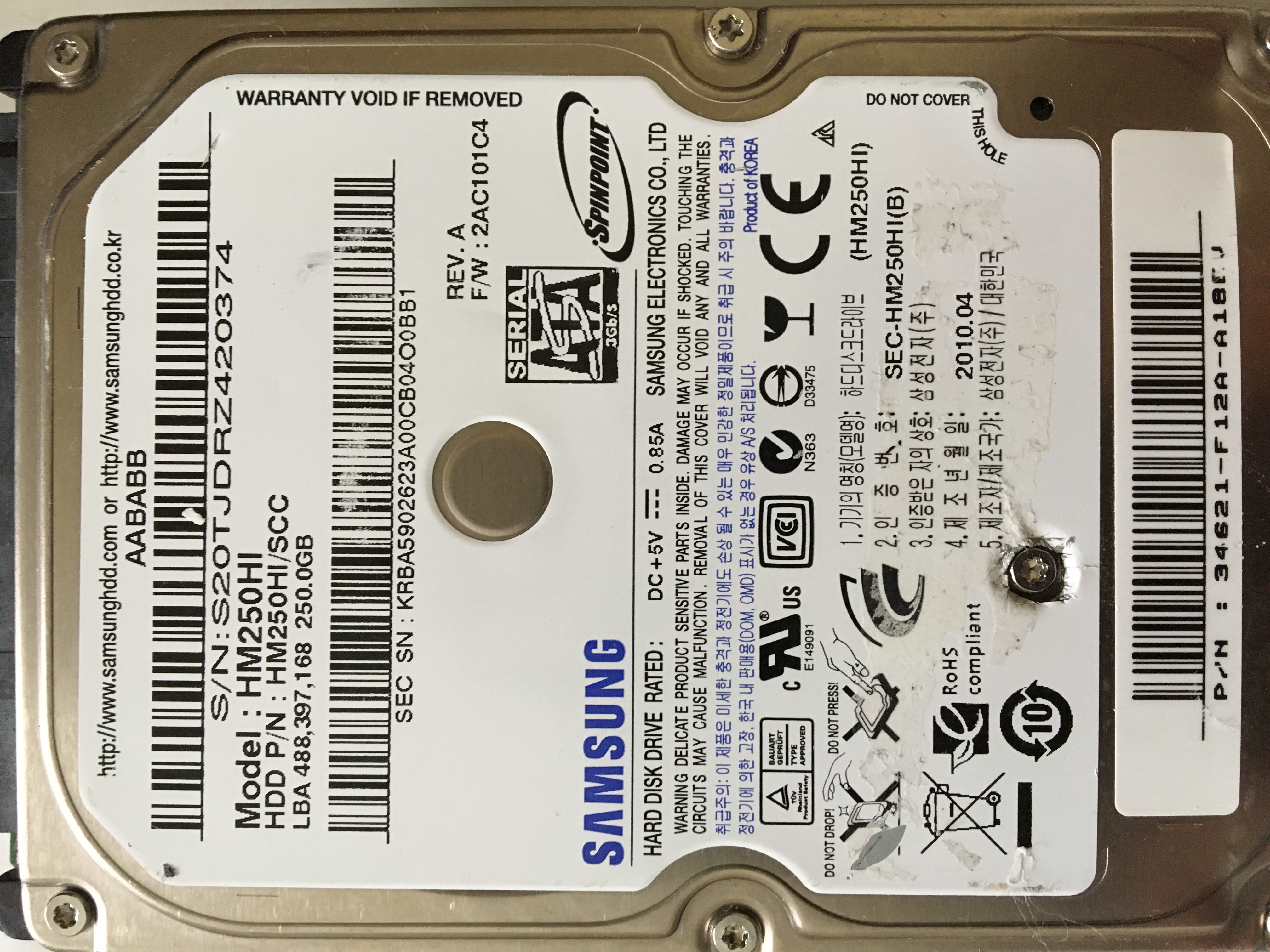

File comment: PATIENT
