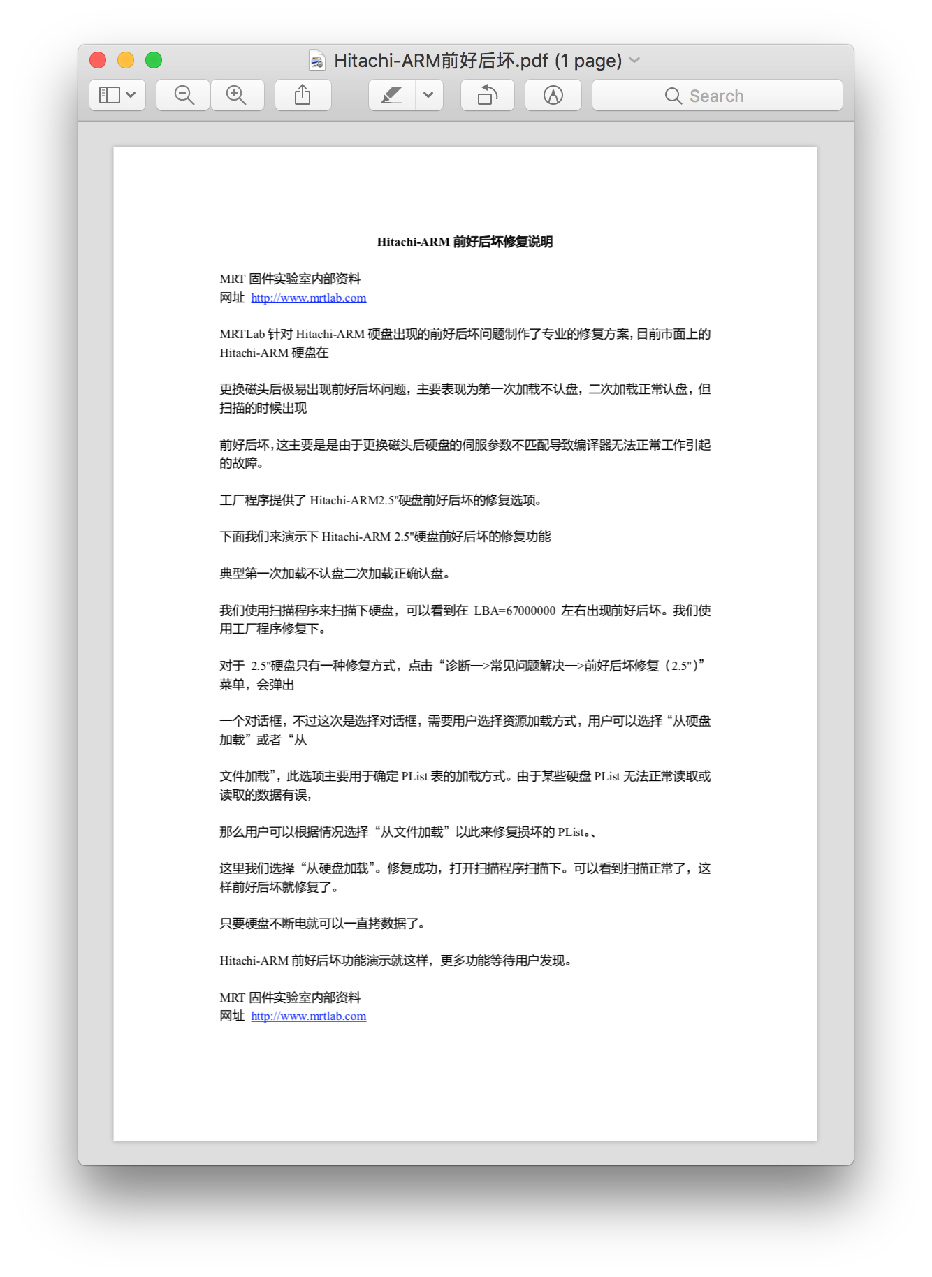

For people who don't believe me when I mention this level of concern -- USING THE U.S. site ... here's an example:
Repair the former after the bad when Hitachi ARM series HDDs change head
Author:Admin Source:MrtLab Hits:1866 Date:13/06/13
Hitachi ARM series HDDs have a common breakdown which is the former after the bad. This problem is usually the original head is breakdown and then changed a new head, after that it has the problem of the former after the bad. That is to say, the LBAs at the start of the drive are readable, but starting with a certain LBA, the drive is filled with UNC errors. This problem leads to the successful rate of data recovery reduced greatly after change head.
It's worth noting that Hitachi ARM HDDs have the former after the bad after change head, the root cause is the changed head’s fit parameters couldn’t match well with the original head’s fit parameters....
And, the PDF? Now THAT is a TREAT!
(Hoping they don't come after me for copyrights!
(Ace Labs would get a kick out of that)
Again -- THIS IS MRT'S US website ... ;)
