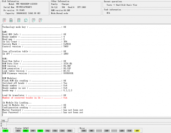

 Post subject: Reserved Track in SA - No UA Acessible
PostPosted: November 8th, 2021, 9:20
Joined: June 26th, 2019, 8:55
Posts: 43
Location: Indore, India
File comment: No User Area Accessible.
WD20SDZW-11Z3CS0 , IDs Perfectly , Read/Write Modules Perfectly .
But No Access to User Data . Gives Read ERR.

Just curious ...
The tool is reporting the reduced capacity that would normally be seen via USB, ie 3906963632 LBAs. The full UA capacity is 3907029168. That's a difference of 65536 sectors.

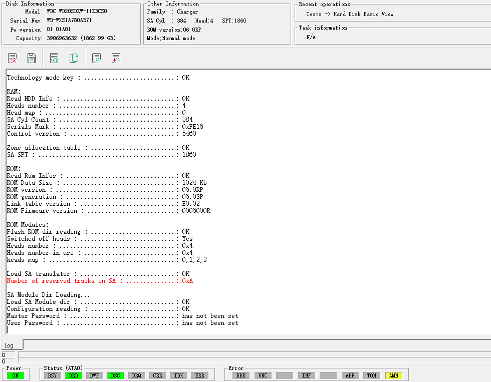

Hii Once again , I have got another charger drive with capacity 3906963632 ,
But there is some valid data recoverable, though sector zero (to some more sector) is junk .
