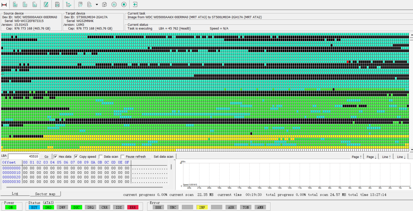

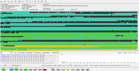

This hard drive is very slow.
I replaced the heads and it didn't help.
The patient's heads work on the donor.
MRT head tests show that the patient's heads are good (read and write) on the donor.
On the patient, with both the new heads and the original heads, only reading from head zero is possible.
Any solution?
Mr. William received no support.

Top surface has some damages, maybe also heads parking ramp is damaged.
Check is there are visible scratches with green light.
Other possibility is that donor heads might have pretty different MRjogs compared to patient heads.
Analyze patient and donor mod 47 for MRjogs comparing.

My sincere thanks for your comments.
There really is a difference using another PCB, but even so, there isn't much progress.
Sometimes I can recognize it normally.
Sometimes I can read the modules.
I'm researching this module 47.
Based on your response about media damage, would the damage be present throughout the media?
It's hard to believe that this would be surface damage.
data is readed, but very slowly

MJogs patient
Head 0 = 0x0CC1
Head 1 = 0x0D58
Mjogs donor
Head 0 = 0x0C8A
Head 1 = 0x0CF5
it's not far
 Post subject: Re: WD5000AAKX-00ERMA0 slow - any MRT solution?
PostPosted: April 24th, 2026, 12:03
Joined: July 8th, 2022, 20:06
Posts: 7
Location: Brazil, SC
Strange
Original heads work fine on the donor drive.
1º head swap
Donor 1 = heading with patient heads.
Patient = clicking
2º head swap
Donor 2 = heading with patient heads.
Patient = slow, same as the originals.
I switched the donor 1 heads back to the patient drive and it continues to read the entire hard drive perfectly.
3º head swap
I switched the donor 1, heads back to the patient drive and it was clicking
Donor continues to read.
I copied the donor's adaptives to the patient.
Any more attempts?
