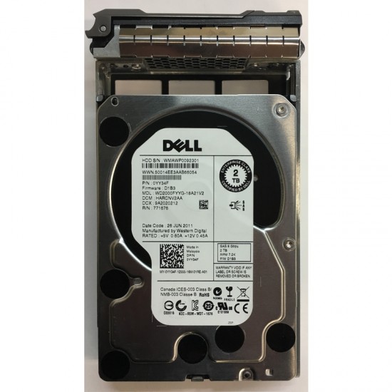

Hi
which is this family
thanks

 Post subject: Re: WD SAS 2TB
PostPosted: May 1st, 2026, 11:41
Posts: 17311
Here is an interesting thread where someone used a SATA PCB to access a SAS drive:
https://groups.google.com/g/datarecoverycertification/c/ZM1Yghm9rV4/m/5B5fT5lZEAAJ
I suspect that the drive in that thread began life as a 2TB, 6 head, SATA model, and was subsequently recertified as a 3 head SAS model.
My theory:
The SATA drive that was the basis for the hotswap was a 2TB model, presumably with a head map of 0b0000111111. The recertified SAS drive has a head map of 0b0000111000, but originally it was a SATA drive with a head map of 0b0000111111. This means that the patient drive originally had an SA on physical heads 0 and 1. Those are the heads that are being dumped by the 2TB SATA donor after a hotswap. The invisible SAS firmware modules are in the SAS SA on physical heads 3 and 4.
Does this make sense?

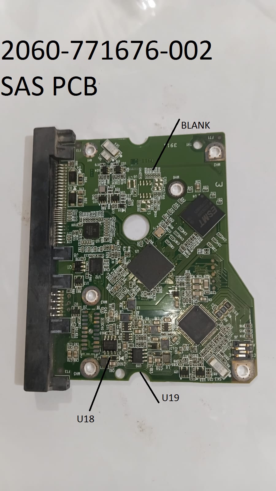

PostPosted: May 3rd, 2026, 6:50
Posts: 153
Location: Karachi
hi
this SAS PCB 771676-002
i think no ROM ic, the pcb is ROM-less
expecting HELP
PostPosted: May 3rd, 2026, 7:50
Joined: September 26th, 2016, 4:26
Posts: 127
Location: Russia
U12 - ?
PostPosted: May 3rd, 2026, 14:10
Posts: 17311
https://hddpcb.eu/1760-large_default/pcb-western-digital-2060-771676-000.jpg
PostPosted: May 5th, 2026, 15:42
Posts: 17311
I don't know how the terminal works on SAS PCBs, but if it works the same way as SATA, then choose a 2TB Green SATA family (if necessary) and dump the ROM via the terminal port using your terminal adaptor.
