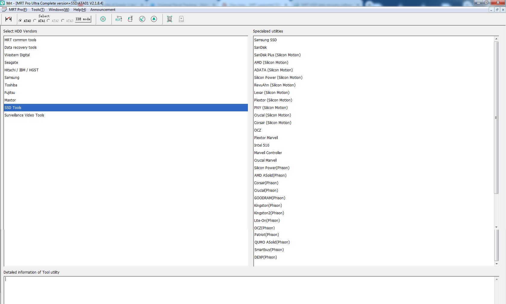

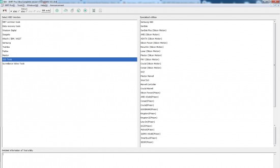

 Post subject: Re: MRT supported SSD controllers
PostPosted: November 21st, 2023, 9:30
Posts: 1740
Location: Verona, Italy
I've MRT 2184, this is the list of ssd utilies, i will manually write a list of supported controllers
Last version 2191 added HP H6008 (SM2258XT) utility and also the followings Phison controllers support:
- Silicon Power2 A55
- Patriot Burst
- GOODRAM IRDM
- Lite-On PH4
- Lite-On PH6
- Silicon Power A56
- Gigabyte GSTFS31
- Foxline FLSSDX6SE
- Apacer AS340
- Apacer AS350
http://us.mrtlab.com/download/uplist.html
