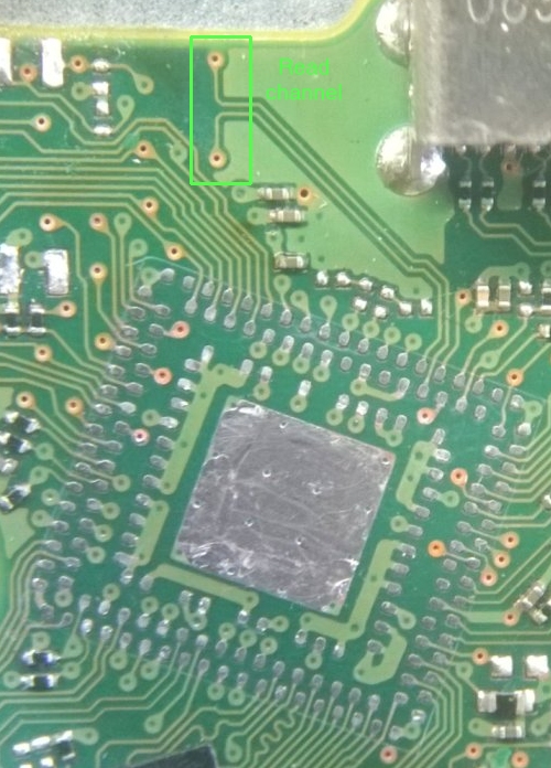

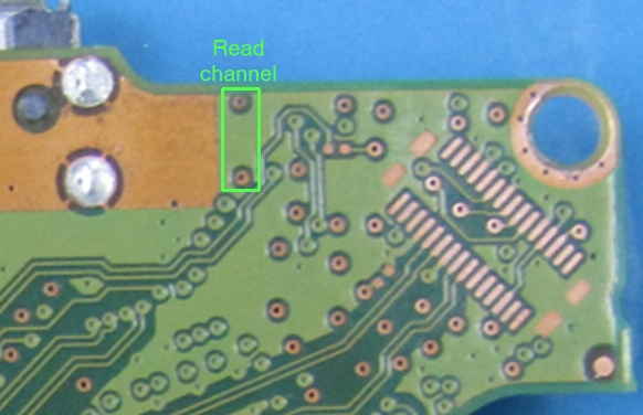

 Post subject: Where are TV9 and TV10 on PCB 810035
PostPosted: August 2nd, 2026, 0:30
Joined: February 20th, 2019, 23:54
Posts: 26
Location: USA
I need help locating the test points TV9 and TV10 ona PCB 2060-810035
A WD 4TB hdd stays on BSY, and I need to short it.
TIA
File comment: PCB 2060-810035
1.png [ 1.51 MiB | Viewed 362 times ]
 Post subject: Re: Where are TV9 and TV10 on PCB 810035
PostPosted: August 2nd, 2026, 6:34
Joined: July 12th, 2010, 4:38
Posts: 1454
Convert to SATA and then you can edit ROM (change zones for instance) and skip the bsy situation
ACELab partner
 Post subject: Re: Where are TV9 and TV10 on PCB 810035
PostPosted: August 2nd, 2026, 9:21
Joined: February 20th, 2019, 23:54
Posts: 26
Location: USA
Thanks for your time.
Let me give you some extra information on this case.
When connecting the drive, it gets stuck on BSY.
No clicking sounds
I am using MRT Equalizer.
Already extracted ROM, unlock it (with 411 disable), and wrote it back to the ROM chip.
But the drive still stuck at BSY.
That is why I'm asking for help locating TV9 and TV10 and see if I can force the drive to avoid the BSY state
I hope it makes sense
 Post subject: Re: Where are TV9 and TV10 on PCB 810035
PostPosted: Yesterday, 19:47
Posts: 17099
See this thread:
https://forum.hddguru.com/viewtopic.php?t=43533
The MCU is a Marvell 88i1054-NXZ2.
This PCB has the same MCU:
https://recuperodatos.com/disco/western-digital-wd20ezaz-22l9gb0-hdd-3-5-sata-2000gb-595-21683
Here are photos of top and bottom:
https://img01.obyava.ua/classified/0/2537/5412/5q21poqeongckuat.jpg
https://img01.obyava.ua/classified/0/2537/5412/3mjr5ohlk4bm6wyc.jpg
You can see TV9 and TV10.
Here you can see the exposed area under the MCU. The read channel is visible. You can trace the read channel pair to the underside of the PCB. They appear to be the two vertically aligned vias immediately to the right of the USB connector.
https://forum.hddguru.com/download/file.php?id=24238&mode=view
 Post subject: Re: Where are TV9 and TV10 on PCB 810035
PostPosted: Today, 13:56
Posts: 17099
I think these are the read channel locations.
Read_channel_1.jpg [ 207.11 KiB | Viewed 51 times ]
Read_channel_2.jpg [ 108.38 KiB | Viewed 51 times ]
 Post subject: Re: Where are TV9 and TV10 on PCB 810035
PostPosted: Today, 14:13
Joined: February 20th, 2019, 23:54
Posts: 26
Location: USA
Thanks fzabkar !!
Very valuable information!
