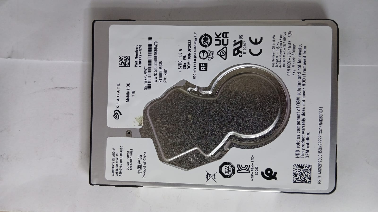

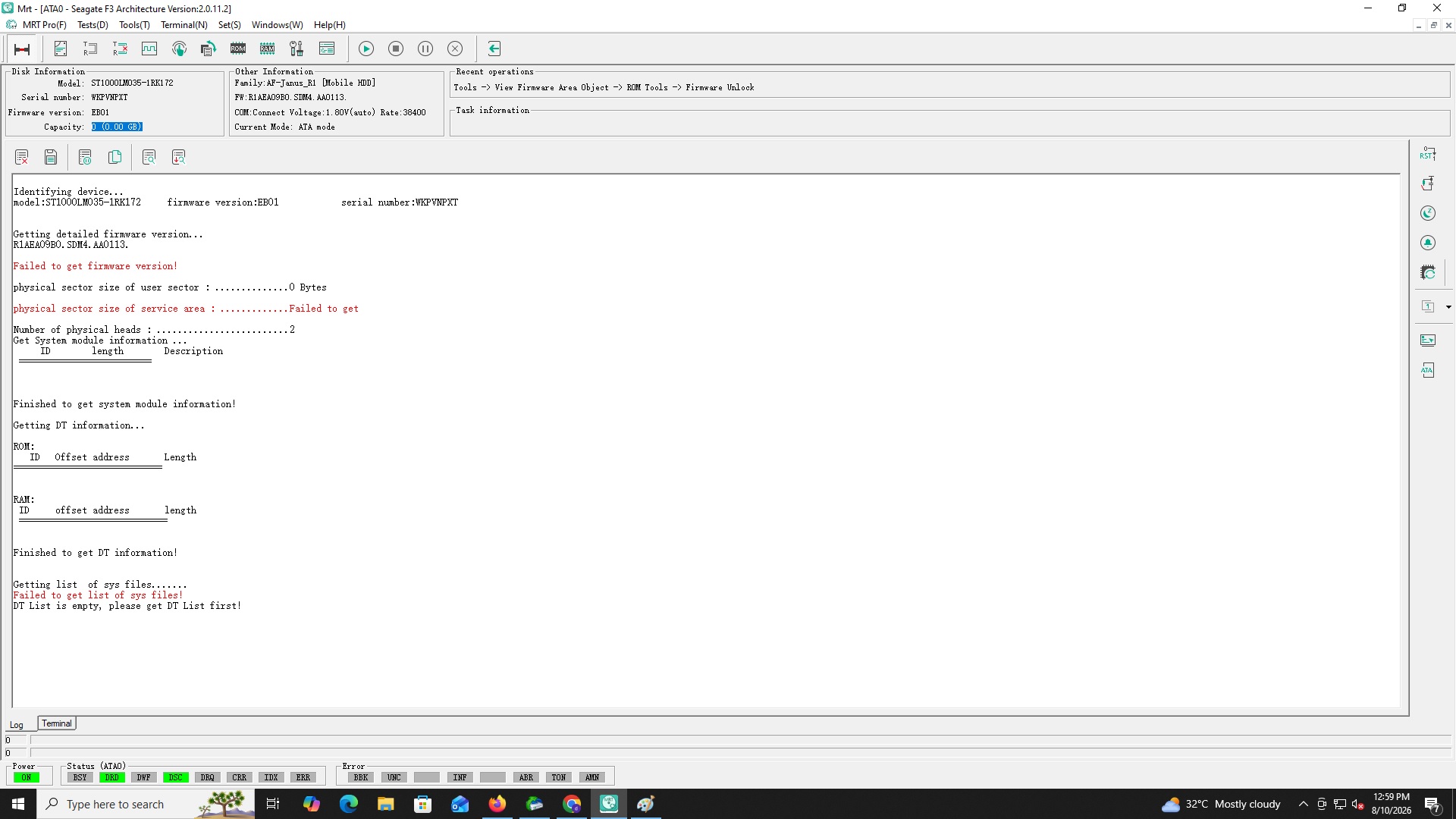

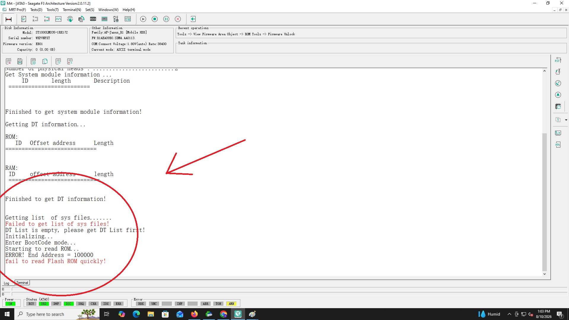

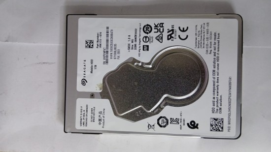

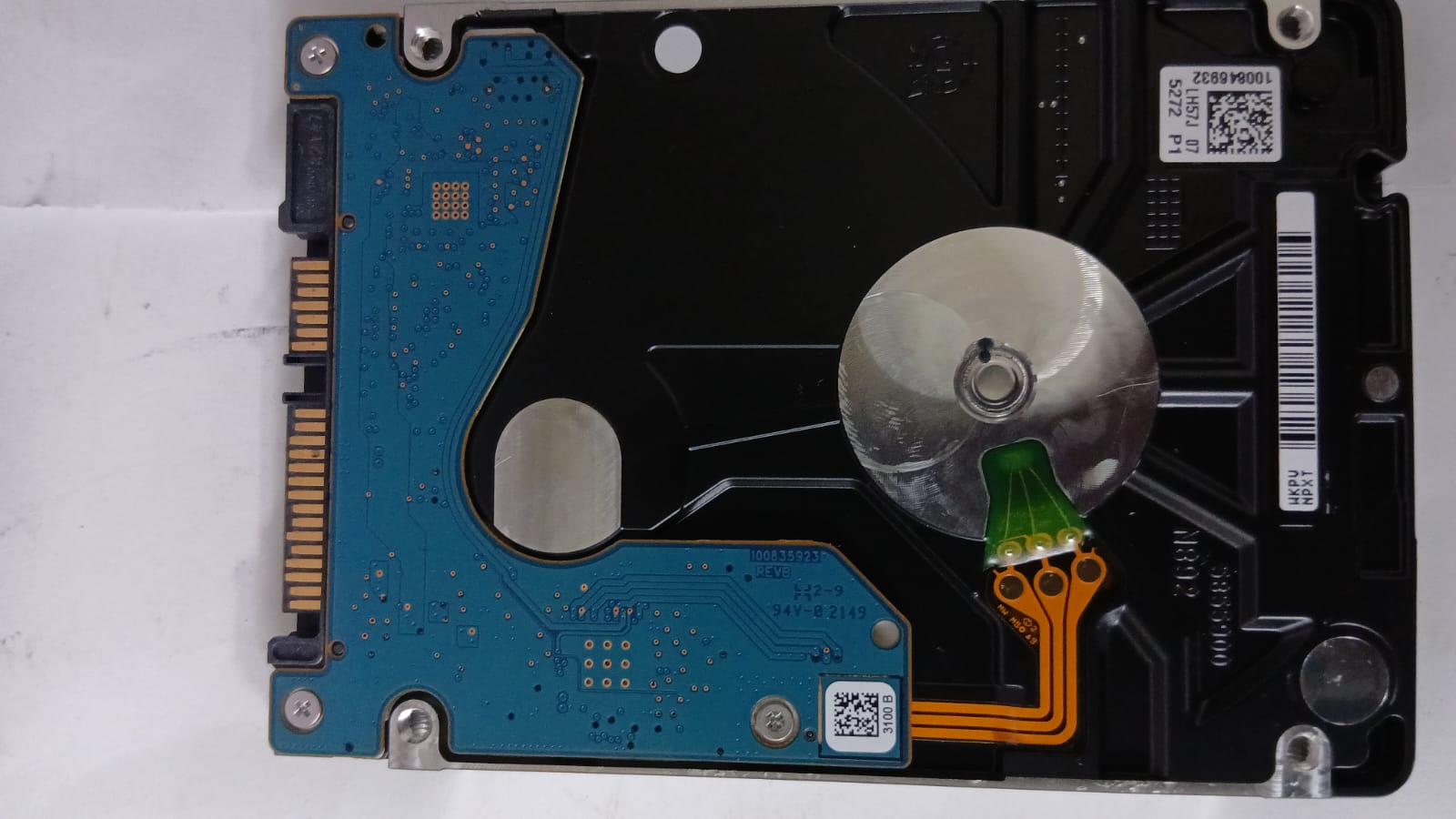

 Post subject: Seagate Rosewood unlock problem
PostPosted: Today, 4:06
Joined: May 6th, 2013, 2:48
Posts: 84
ST1000LM035-1RK172
EB01
0 (0.00 GB)
WhatsApp Image 2026-08-10 at 13.10.03.jpeg
WhatsApp Image 2026-08-10 at 13.10.03.jpeg [ 138.73 KiB | Viewed 40 times ]
WhatsApp Image 2026-08-10 at 13.10.20.jpeg
WhatsApp Image 2026-08-10 at 13.10.20.jpeg [ 118.68 KiB | Viewed 40 times ]
1.jpg [ 252.93 KiB | Viewed 41 times ]
2.jpg [ 305.73 KiB | Viewed 41 times ]
 Post subject: Re: Seagate Rosewood unlock problem
PostPosted: Today, 5:33
Posts: 841
Location: Pakistan
bootcode is locked... you need to read rom chip via programmer, unlock it and write back via programmer...there is underling translator problem as well, which can be fixed easily once you have access to SA.
donot regen translator.
regards
wasim
Data Recovery Pakistan
