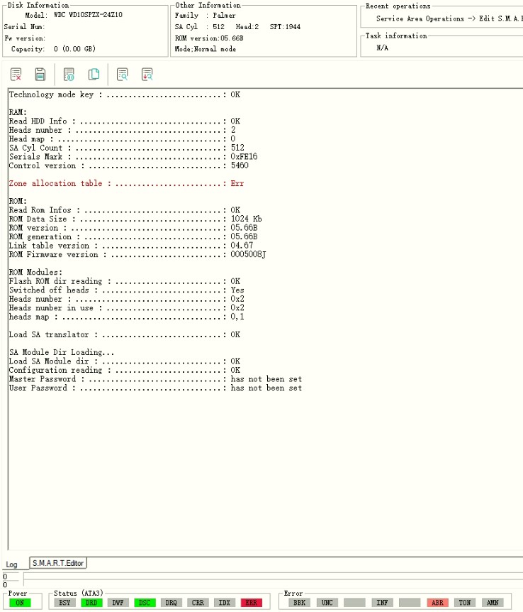

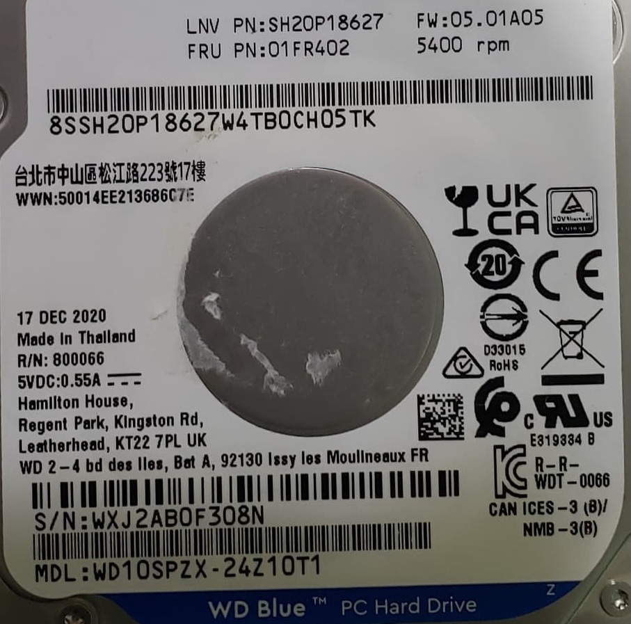

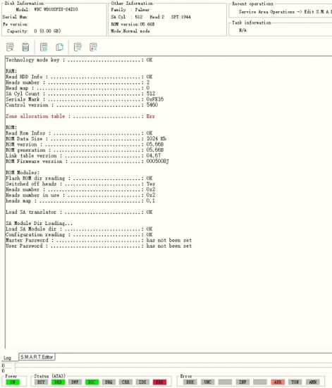

 Post subject: WD ROM Help
PostPosted: Today, 4:08
Joined: April 9th, 2021, 3:47
Posts: 149
Location: Yemen
Could someone help me repair this ROM please ?
ROM.rar [639.48 KiB]
Downloaded 10 times
WhatsApp Image 2026-10-25 at 4.04.19 PM.jpeg
WhatsApp Image 2026-10-25 at 4.04.19 PM.jpeg [ 218.58 KiB | Viewed 254 times ]
 Post subject: Re: WD ROM Help
PostPosted: Today, 4:50
Joined: May 30th, 2005, 17:07
Posts: 548
Why do you think there is an issue with the ROM?
Mikippp
 Post subject: Re: WD ROM Help
PostPosted: Today, 5:35
Posts: 844
Location: Pakistan
a donor ROM can also be used if you know certain information about the original ROM.
but again as Mikippp said why you think there is a problem with the ROM.. what is behavior of drive with original ROM ?
Data Recovery Pakistan
 Post subject: Re: WD ROM Help
PostPosted: Today, 6:04
Joined: April 9th, 2021, 3:47
Posts: 149
Location: Yemen
Mikippp wrote:
Why do you think there is an issue with the ROM?
Mikippp
After unlock it and reflash it to the chip it give no sign of life
 Post subject: Re: WD ROM Help
PostPosted: Today, 6:08
Joined: April 9th, 2021, 3:47
Posts: 149
Location: Yemen
MindMergepk wrote:
a donor ROM can also be used if you know certain information about the original ROM.
but again as Mikippp said why you think there is a problem with the ROM.. what is behavior of drive with original ROM ?
When i turn on the hdd it only gives the model number
 Post subject: Re: WD ROM Help
PostPosted: Today, 8:22
Joined: April 9th, 2021, 3:47
Posts: 149
Location: Yemen
now i have this issue
1.jpg [ 113.67 KiB | Viewed 157 times ]
 Post subject: Re: WD ROM Help
PostPosted: Today, 8:40
Posts: 17314
It appears that the drive is identifying itself with the information in the ROM:
Analysing active 0x0D module ...
Firmware Version = 05.01A05
World Wide Name = 50014EE213686C7E
Model Number = WDC WD10SPZX-24Z10
Serial Number =
That suggests that it cannot read, or make sense of, module 0x02.
Are you able to upload 0x02?
 Post subject: Re: WD ROM Help
PostPosted: Today, 9:04
Joined: April 9th, 2021, 3:47
Posts: 149
Location: Yemen
It appears that the drive is identifying itself with the information in the ROM:
Analysing active 0x0D module ...
Firmware Version = 05.01A05
World Wide Name = 50014EE213686C7E
Model Number = WDC WD10SPZX-24Z10
Serial Number =
That suggests that it cannot read, or make sense of, module 0x02.
Are you able to upload 0x02?
this one ?
02_ByID.rar [1.6 KiB]
Downloaded 8 times
 Post subject: Re: WD ROM Help
PostPosted: Today, 9:11
Posts: 17314
That looks OK. The model number is longer -- WD10SPZX-24Z10T1 (SA module 02) versus WD10SPZX-24Z10 (ROM module 0D).
 Post subject: Re: WD ROM Help
PostPosted: Today, 9:36
Joined: April 9th, 2021, 3:47
Posts: 149
Location: Yemen
That looks OK. The model number is longer -- WD10SPZX-24Z10T1 (SA module 02) versus WD10SPZX-24Z10 (ROM module 0D).
yes
what should i do now ?
 Post subject: Re: WD ROM Help
PostPosted: Today, 10:10
Posts: 17314
I have no idea. Yours peers would know better than me.
