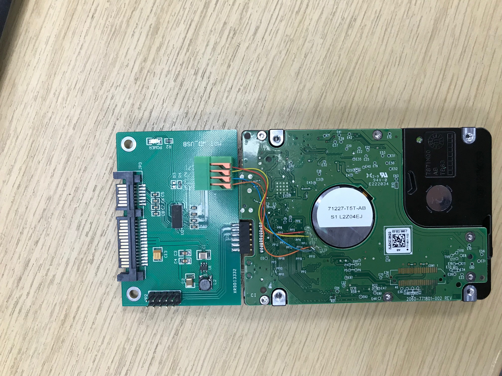

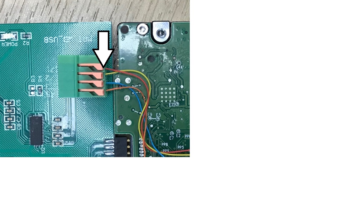

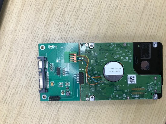

I bought one of these out of curiosity and was determined to get it to work!
Here's how I've wired it up....

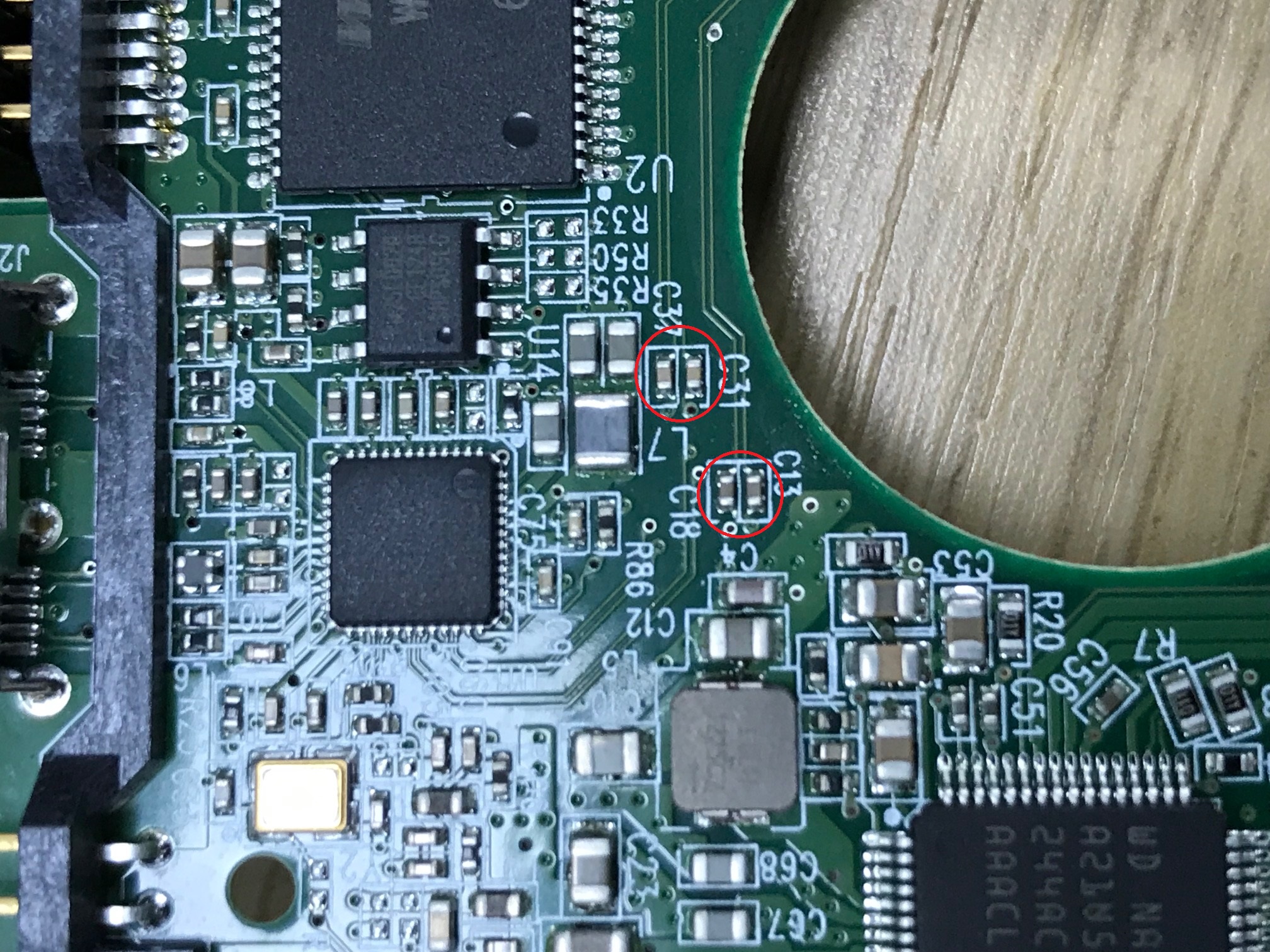

And these are the caps I removed...

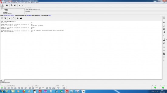

So I connected it up to a SATA port on PC3K with no USB power and drive spun up OK, but stays BSY.
Thought it might be my wiring or the drive itself. So checked wiring (all OK) and tried another drive... same.

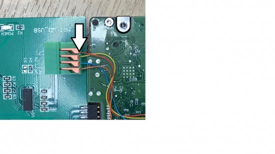

But with buggering around with it, I disconnected the wire to E17 on the green block while power on....

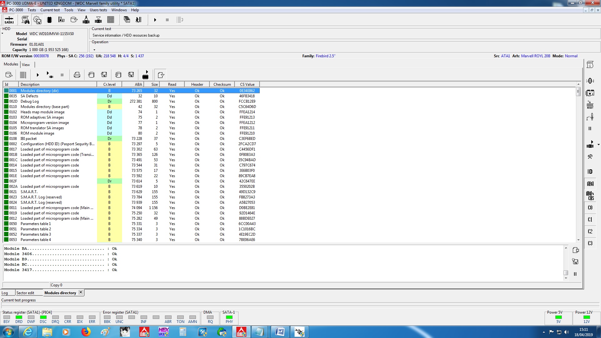

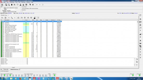

And then pushed the red wire in and voilà!! Full ID, FW access, the lot!......
In fact, it works with any one of the 4 wires disconnected and then connected after power-on. But with all 4 connected, just get BSY.
No USB power required :-)

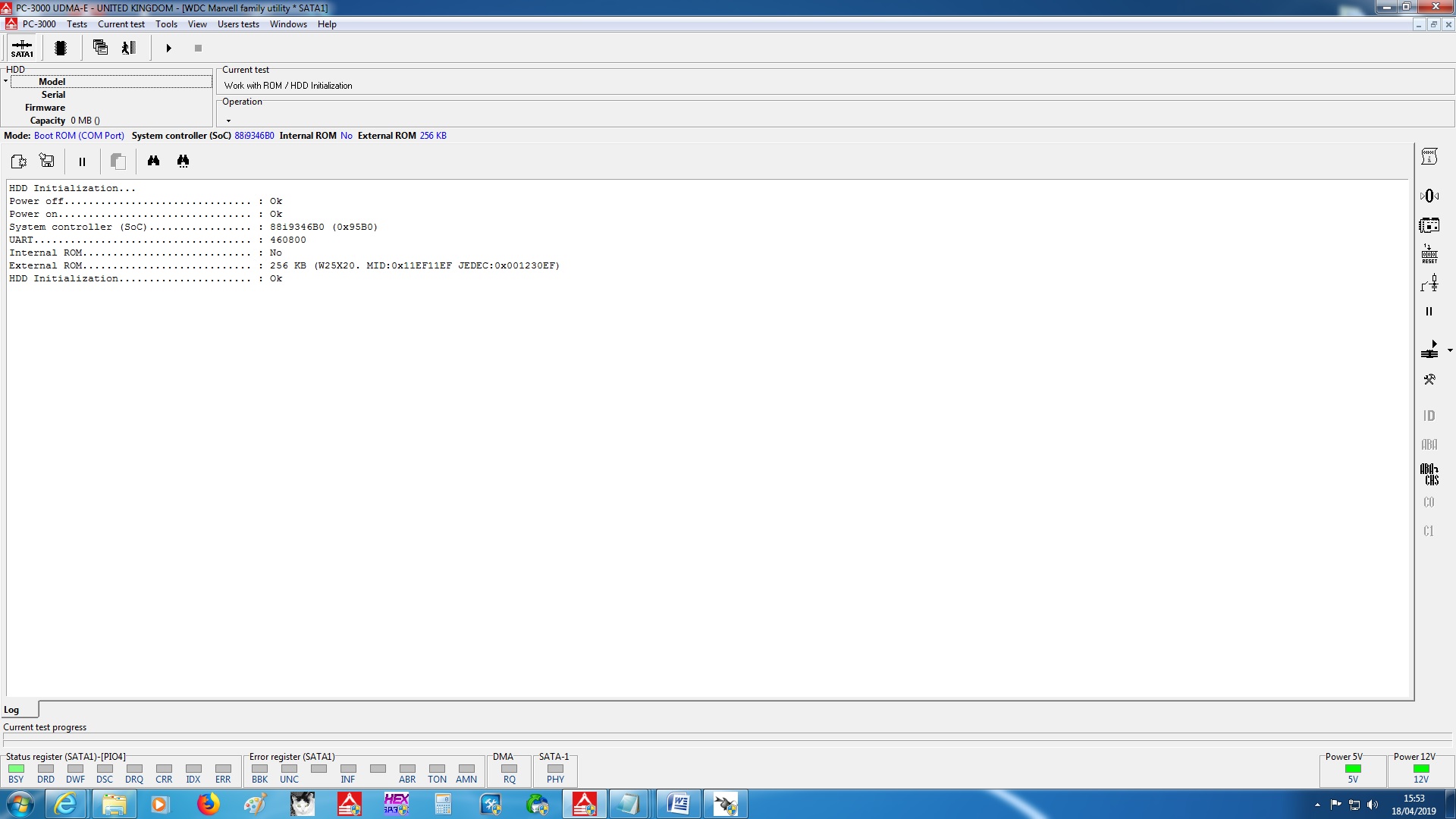

PostPosted: April 18th, 2019, 10:55
COM connection works too...

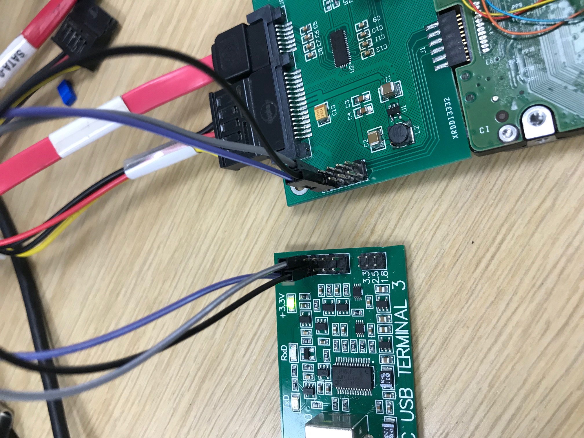

Wired up like this...

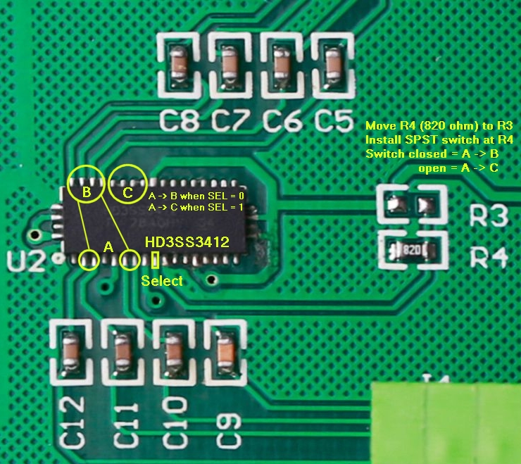

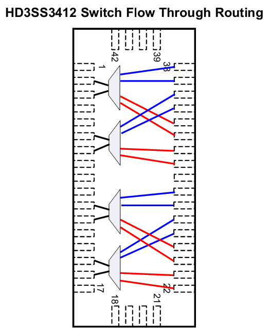

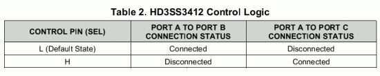

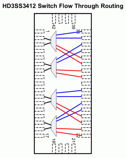

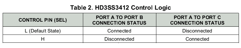

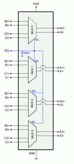

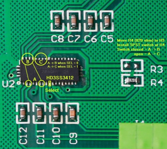

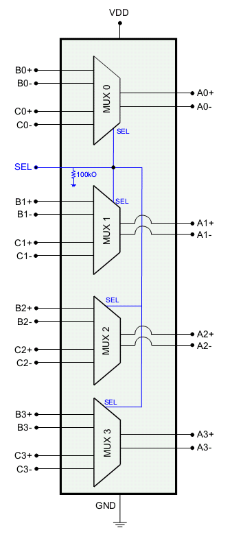

If this "BSY problem" persists, the following modification should make things easier:
 Post subject: Re: New Mrt User, please guide me How to Connect Wd Hard Dis
PostPosted: April 18th, 2019, 18:03
Thanks for your input.
I do understand the logic behind your suggestion and would like to try it, but struggling to locate a source of a small enough SMD SPST switch in small enough quantities.
Happy to try it for curiosity but don’t wanna spend too much!
PostPosted: April 18th, 2019, 20:25
Posts: 17215
Use an ordinary sized switch and run wires to the pads. No need for smt.
If the PCB allows it, there may be a way to drill a hole to accommodate the switch, or you may be able to anchor it at one of the screw holes.

An alternative solution would be to short the pads of R3 with tweezers. This will pull the SEL pin high and disconnect both SATA pairs. This procedure should be safe, although inelegant. However, it would serve as proof of concept prior to embarking on any modifications.
