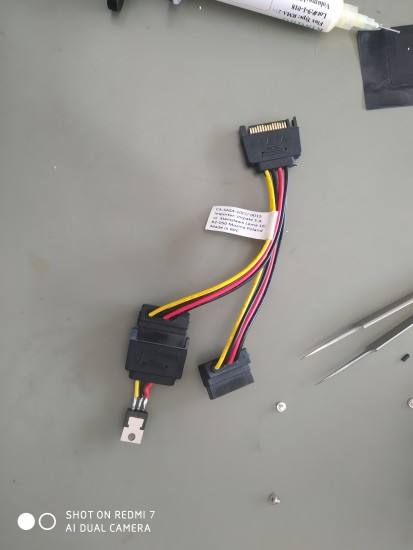

Observing the operation of the MRTLAB, I see that the voltage of the 5v drops to very low levels. I have been able to observe damage in the 5 volt power tracks to the tps2420, which is why I have jumped from the card's 5v power input to the 4 vin pins of the tps2420, with which I have achieved that the voltage of the 5V does not lower me as much and at the moment it works, I think that it is a failure in the size of the tracks of 5v. At the moment it works well for me.
Incidentally, the TPS2420 is configured for a 3 to 4 amp current draw. I think it is a design flaw, because if there is a short, a lot of current can pass through the tracks for a brief moment and can damage them slowly, it would have been better to configure it for a maximum of 2 Amps. It's just an opinion.

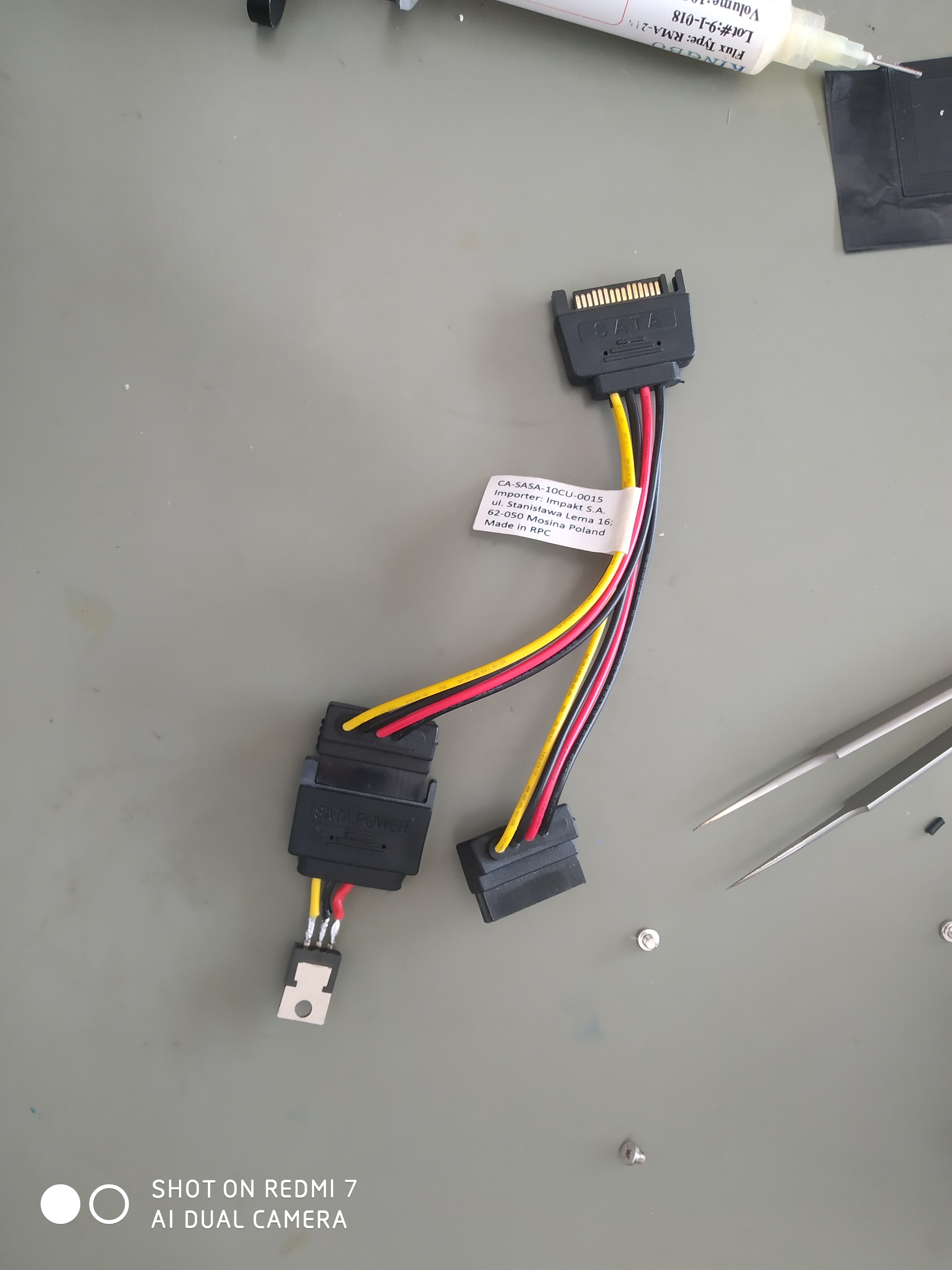

Another way to solve the problem of falling 5v is without touching the card, place a 7805 between the 12v and 5v gnd.

This would factor the heatsink for the 7805.

The problem is not found in the tps2420 and removing them could cause damage to the card in case of connecting a hard disk with the short circuited tvs.

To my knowledge, MRT does not have monitoring of the channel voltage and as you say, it could be monitored, but what I was looking for was stability in the hard drives, because they did not work properly and it seemed that they were wrong and when they did they did not work properly. adequate in some cases.
At the moment I will replace the lm7805 with an LDO.
Thanks for the idea.

An LDO is only necessary when the input-output differential ("drop-out") is less than ~2V. In any case I would think that your modification would upset the PSU's regulation of the 5V rail. It just doesn't seem right to me. :?

These 3-terminal regulators only regulate properly when the difference between Vin and Vout (the "drop-out voltage") is greater than a specified minimum. If Vin is too low, then the output will be unable to maintain the rated voltage/current.
A Low Drop-Out regulator is optimised so that it can operate with a low voltage difference. For example, an LM1117 LDO regulator has a drop-out voltage of 1.2V. This means that an LM1117-5.0 regulator will operate correctly at input voltages as low as 6.2V. OTOH, an LM7805 has a drop-out voltage of 2V, so it requires a minimum input of 7.0V.
https://www.ti.com/lit/ds/symlink/lm1117.pdf
https://www.ti.com/lit/ds/symlink/lm340.pdf
Also, your proposed arrangement connects two regulators (the 7805 and the PSU itself) to the same rail. This means that each regulator will be fighting the other. That's a bad idea.

Thank you very much for the clarification on the ldo. You are right in the analysis but the great input impedance that the lm7805 has in the output I think will help. At the moment solve the problem, but as always your analysis is precise and rigorous.

If an external source with relay control is used using the 5v of the MRTLAB output power, I can already work stably. I have done tests connecting directly to MRTLAB and external power supply and the outputs of MRTLAB gives unwanted effects.
