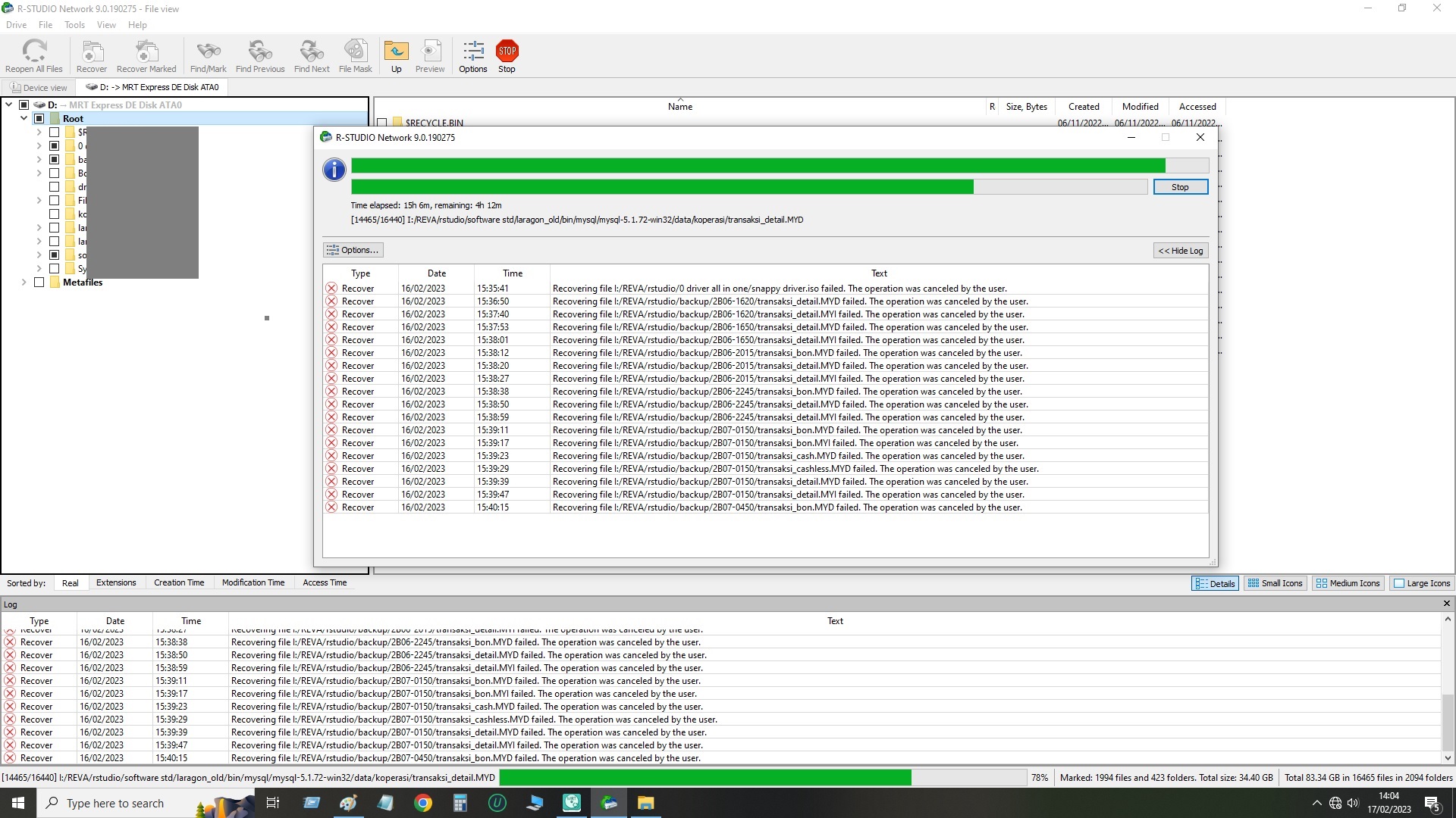

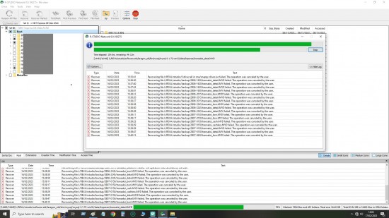

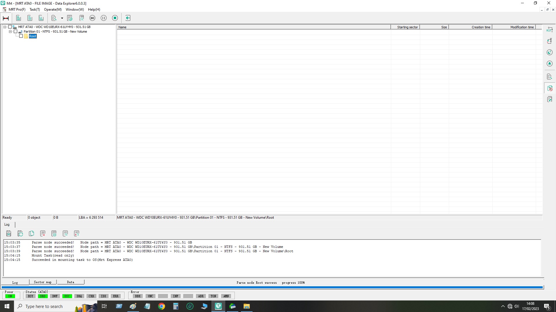

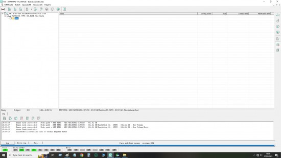

I know that following action taken is not 100% correct, but in time being [SOLVED] my problem. Due to need data urgently and need to solve before week end,
I done with DE successful :
DE about 30%, then manually I stop.
Mount the drive, in read mode
Activated R-Studio, scan and read file, saved those read file.
It is successfully, although small amount bad files skipped.
Thanks.
