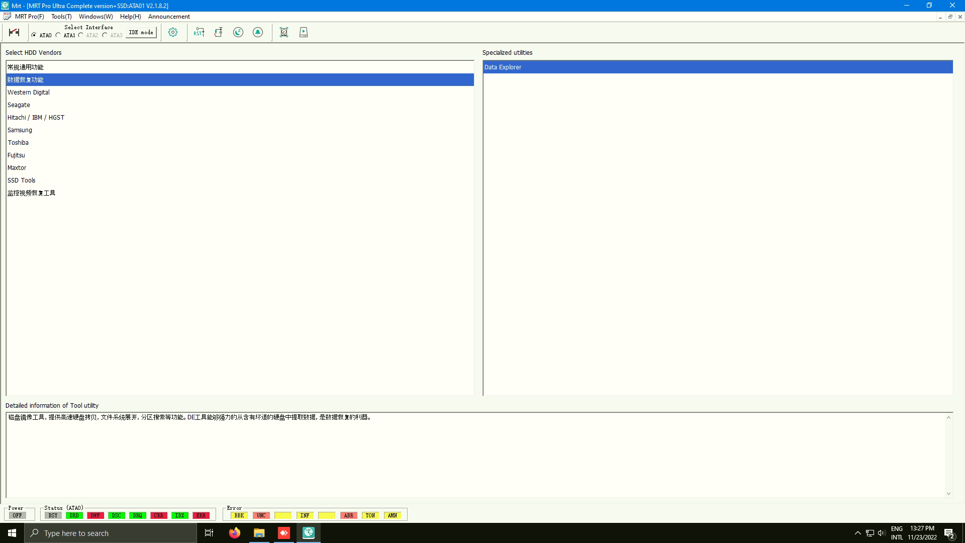

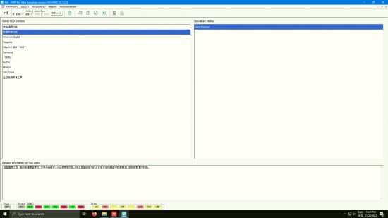

Version 2182 is out .....but , as usual, they screwed something, some menus are in chinese ....Can't they do a test before releasing a software??

MRT 2.1.8.2 is currently chinese version .
English version may release in some days .

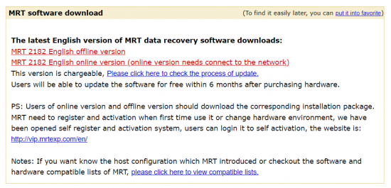

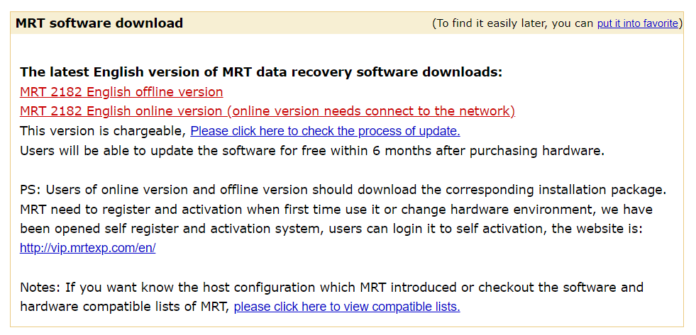

Posts: 2592
If so, why do they provide the link to the English version on their site?
I sense that their low cost approach translates to having limited staffing. Having some good beta testers would help, but sometimes companies get beta testers setup who provide absolutely no feedback and are just looking for a free product update.
