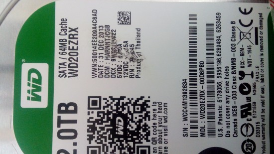

Hi
I need LDR for this hdd.

What ROM version?

pclab wrote:
What ROM version?
I don't know, this hdd detect as a model only!
No FW, No ROM version...
MRT engineer says need to load LDR

If you can read the ROM you can find the ROM version around line 0x3D750 just under the letters ROYL if you view it in Hex. It should be something like 00200049 or similar.

ROM Version: 01.32B

00010032 is the rom version you are looking for the loader.
