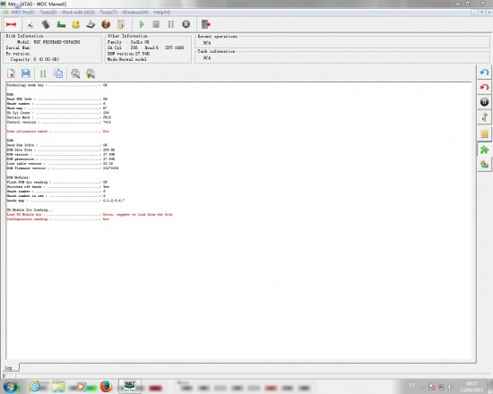

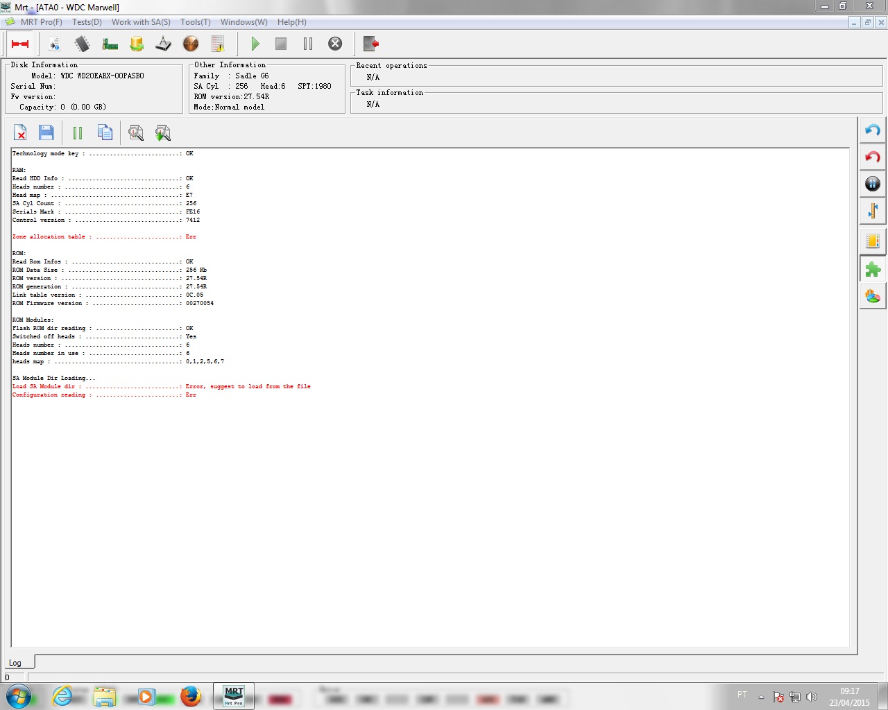

The original ROM recognized the disc with the wrong size and a lot of crazy characters in device name. I bought a firmware for this HD this site: http://www.hddfirmware.net/product/wdc- ... 986609zip/ and with a help of a universal EPROM burner made a backup chip content 25LD020 and saved him the purchased ROM. From there the disc recognized with the correct name without displaying the crazy characters, but the size is wrong it shows only 1.3 tb and not 2 tb. The MRT PRO says it has error in RAM that the ROM is correct

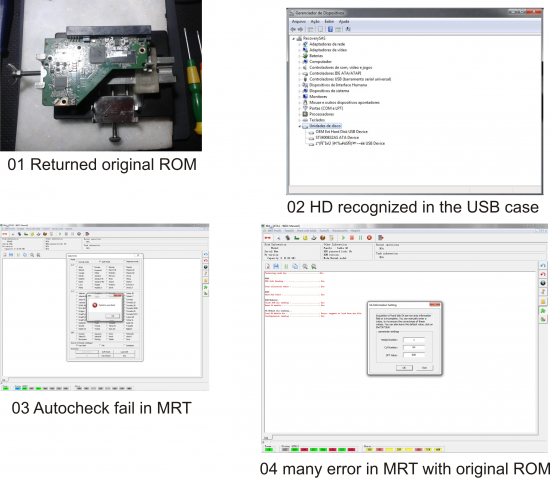

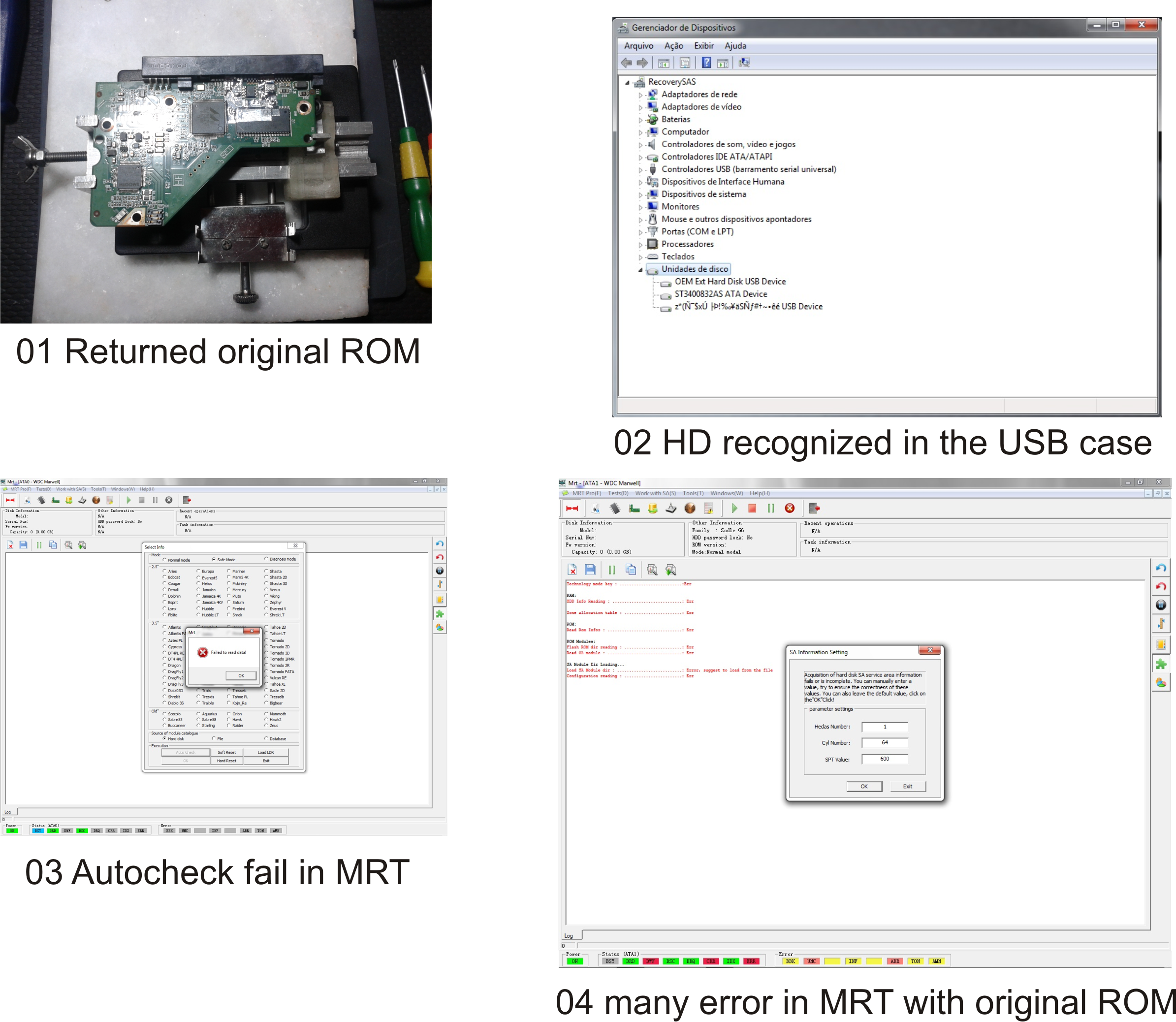

Done! The original ROM was returned to the chip, please see in attached image the results.
 Post subject: Re: WD20EARX 00PASB0 HDD firmware hire for remote access
PostPosted: April 24th, 2015, 3:55
OK.
Does the drive spin up as normal and stay spinning?
Or does it spin up, click a little and spin down?
Or spin up and sit for a few minutes without clicking and spin down?

The motor turns ordinary without strange noises and remains spinning ...
