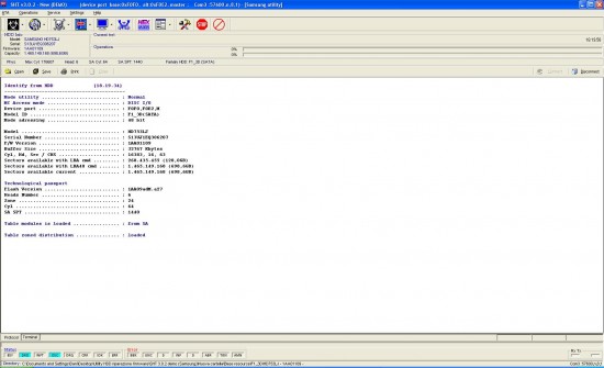

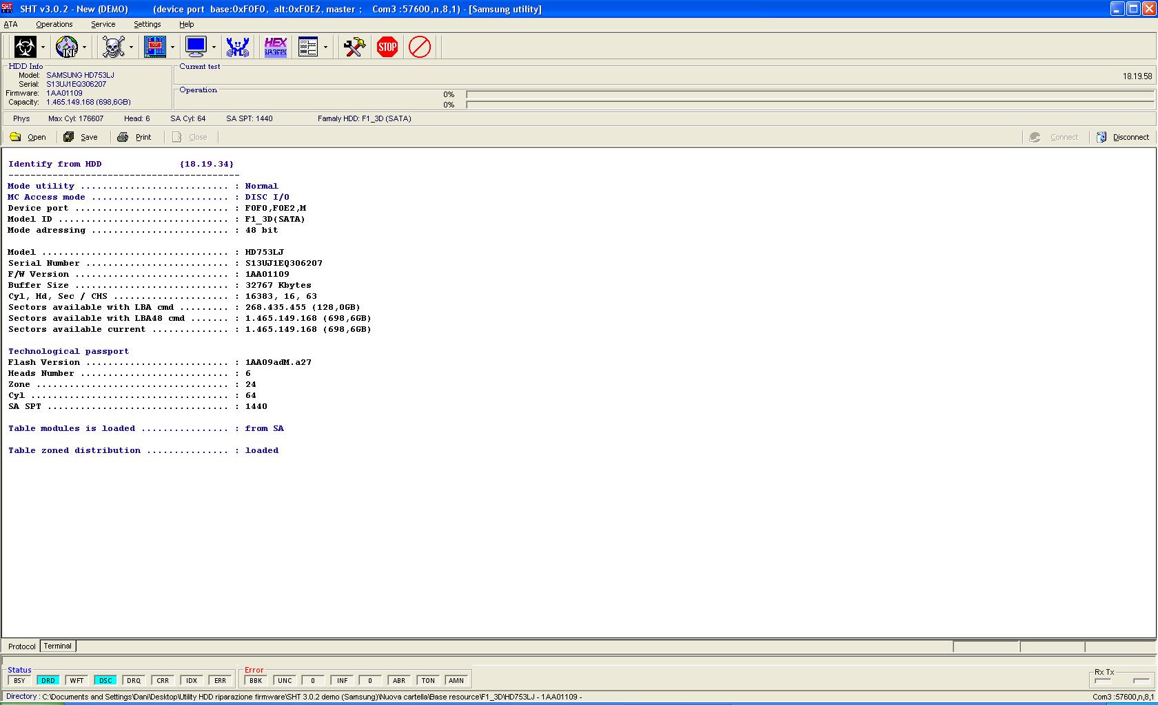

 Post subject: Re: MRT - Version 2.0.4.2 [ Does Not Support Samsung HD753LJ
PostPosted: May 31st, 2015, 12:37
Posts: 1768
Location: Verona, Italy
I was able to backup all SA mods, tracks and rom with SHT, solution was to untick 'slave' option. :)
I backup with any problem, i like SHT ....
MRT for samsung sucks :evil:
