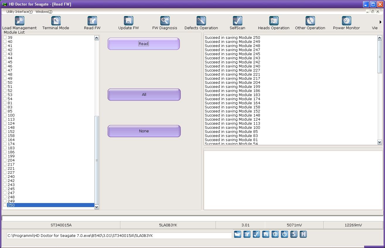

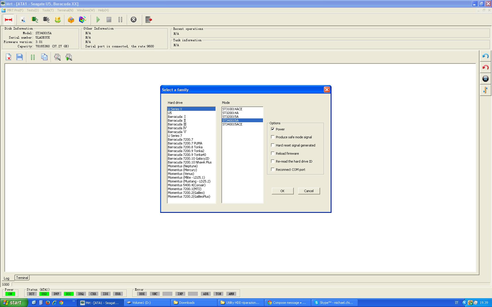

This is another good drive, it hasn't any problem and i can read and write on user area.
MRT detects it with correct ID and register status DRD - DSC are correcty on.

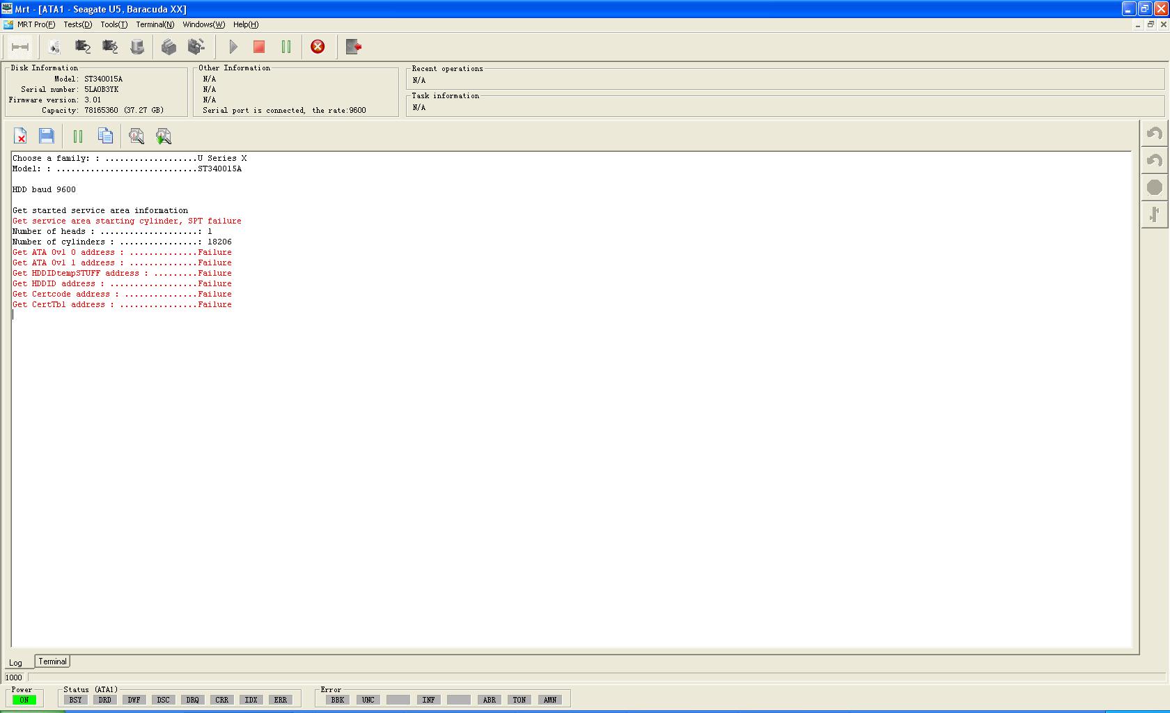

Now i want to backup mods, but MRT is not able to access correctly into SA
As you can see it fails, probably because it search SPT of U Series X drive.

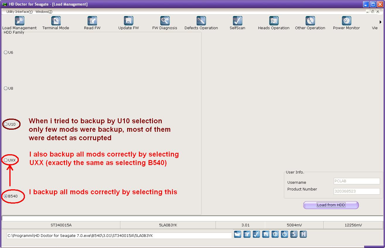

Drive ST340015A is not U Series X family but it's B540 family as written on this SalvationData post:
http://www.scribd.com/doc/10963736/How- ... del#scribd

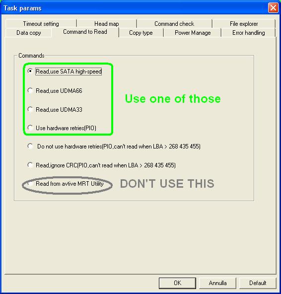

For those who use MRT to recover just few data, i suggest them to use 'image marked item' or 'image current item' instead of 'save marked item' or 'save current item' in FILE EXPLORER.
After that needed files were imaged, extract them on a third drive via R-Studio.
If you used save function instead of image function, that would explain why a lot of files where corrupt (or not recovered at all).

 Post subject: Re: Another MRT bug - ST340015A - No SA access
PostPosted: June 10th, 2015, 3:39
Posts: 1768
Location: Verona, Italy
digisupport wrote:
I used FE to save files after imaging
Don't save files with FE, just image them in MRT FE then save files with R-Studio.
