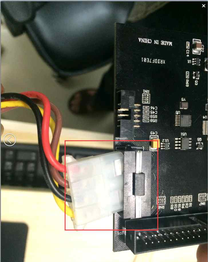

 Post subject: Re: mrt epxress fried - supports answer: How to cross power.
PostPosted: October 7th, 2015, 15:16
Joined: April 22nd, 2010, 16:58
Posts: 31
Location: Irvine, California

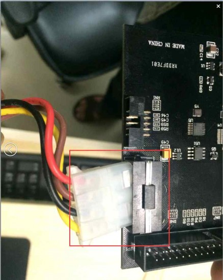

So I asked MRT how it was even possible to cross the power.
They kindly explained it to me with this picture:
Its the card - out of the computer - with the power crossed.
Do they understand that this card is installed in the computer?
That means that the computer is powered-off
then the card is inserted into the slot and screwed in.
and the D-shaped power connector is inserted into the card.
Then the computer is powered up - its basically permanent.
You run the software, attach your seagate, and click power-on....or should I say FLAME-ON !
Once its setup - you don't touch it anymore - its been this way for months.
So they are suggesting that I must have randomly decided to disrupted the working
setup and replug the power to the card !?
yeah... right... its either that or their new cards protection circuit didnt work
nah couldn't be that...must be stupid end-user... china design is perfect.
So to all the other cards that fry the same way - it will be the same answer.
Here for you enjoyment is a helpful guide in how to cross power !

What are the markings on the 4 square ICs (U7, U8, U9 ...)? If these are the power switching MOSFETs, then it should be easy to confirm whether they have any internal overcurrent protection.

After receiving message about the damaged card, our engineers checked carefully according to the information you offered and determined that should be caused by reverse connection of power cables. As there is short-circuit protection in the chip, it is not possible that shorted Seagate can make it burn. If it could be the problem, we should have received many complaints of burnt cards since MRT Express card was released in April. There is no doubt that our R&D team has taken the security factors into consideration, which is the most important for a product.
By the way, we all know the two-layer MRT Pro card was re-designed into one layer (MRT Express)according to our scheme. The new device is with smaller volume, easier installation, better dispersion and more stable performance. I’m sure that it is much better than the old version, and that is why it is called hardware upgrade -- to optimize the hardware design. It is common sense for each engineer that testing each part of the tool is essential before the design is finalized. And we have much more strict standard for products we send abroad. That is also the reason why we’re still testing MRT Ultra (4 SATA + 1 IDE) card in our country before releasing the English version to global market, which has been long-expected among DR technicians around the world. In addition, as the most MRT tools we sell abroad are online version, the sale depends largely on the product performance as users can stop paying for it whenever they don’t feel like it. We will not take the risk of losing our clients. On the other hand, sometimes there can still be non-human damage of the card after it leaves factory for various reasons, long way of shipping, different voltage and temperature etc. As a rule here, after we confirm the hardware problem, the user can get a new card for free from local distributor or from us directly.
As for your case, we never doubt your expertise because it can sometimes happen even with the highly-experienced engineers when you operate with less caution. To solve the problem, we offered you the final solution -- send you a new card with the hardware cost borne by you, which is reasonable. But you refused and insisted that it is not your fault, then came with much complaints and unpleasant words. In my point of view, if you really want to get the problem solved, this is not a good choice.
You have been offering various opinions and demands about the hardware and software part of MRT tool. As you said, we should take them as good willingness to improve this tool. Taking a look into our forums and other online communication tools, we can easily find that you said much about this tool. And we answered them one by one with no neglect whatever it is. While the truth is, there is no tool that can get 100% satisfaction for a certain user. The needs of each person can be various, while it is not a customized tool, and no matter how much we want it to be perfect overnight, it has to be developed step by step and every breakthrough needs a lot of time and energy. It is the same for all DR tools.
In a word, I honestly suggest you contact us to get a new card so as to get this problem solved for good. We don’t want to lose you as customer who have used this tool for about 1 year and we’re here with the hope to do better.

Am I to understand that people who claim to be professionals take an unknown drive and plug it into their US$3K and $10K hardware without performing the most rudimentary tests prior to doing so? A cheap multimeter costs less than US$5, and a simple resistance check across the drive's supply inputs should take less than a minute.
In any case, how is it that PC3K failed to alert the user to an overcurrent condition? Doesn't PC3K produce a V-I graph, and wouldn't this graph have told the OP that there was a short on the HDD? If so, then why didn't the OP address the short circuit before proceeding? Moreover, if the drive didn't spin up, why didn't this prompt the OP to examine the PCB?
If the MRT card really is a clone of an Ace Lab product, then this would explain why both cards appear to have the same design problem. I agree with the OP that the power switching part of the design should be implemented as a separate low cost module, and this module should ideally be repairable by the user.
As for whether it is possible for the OP to have reversed the Molex connector, I would ask several questions. Do the 4 power switching ICs (?) receive their logic power from the D-connector, or do they get it from the motherboard? If the control logic gets +5V from the D-connector, and the ICs are spec-ed for supply voltages less than 12V, then a polarity reversal should have killed all 4 ICs, not just one.

I didn't mention overvoltage. I was referring to overcurrent. ISTR that these tools produce a current-versus-time graph for each of the supply voltages (not V-I as I previously stated).
If you stand by your claim that you did not wrongly connect the power plug, then allow me to confirm it for you by providing the information I requested. I promise I won't use these "secrets" to manufacture my own card.
