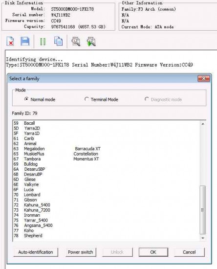

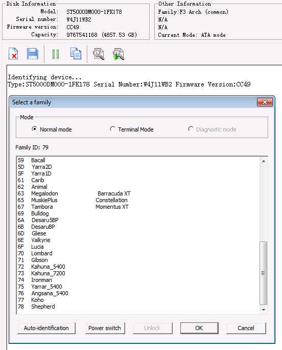

Got a new 5tb seagate. Testing with mrt.
MRT doesnt seem to recognize family
Diagnostic port is locked.
Gets family ID 79 - but there isn't one....

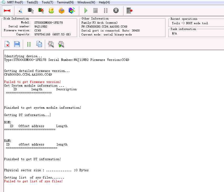

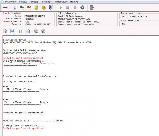

Heres the log screen after detection attempt:
Identifying device...
Type:ST5000DM000-1FK178 Serial Number:W4J11WB2 Firmware Version:CC49
Getting detailed firmware version...
CFA5000D0.CCD4.AA1000.CC49
Failed to get firmware version!
Get System module information ...
ID length Description
Finished to get system module information!
Getting DT information...
ROM:
ID Offset address Length
RAM:
ID offset address length
Finished to get DT information!
Physical sector size : .............. :0 Bytes
Getting list of sys files.......
Failed to get list of sys files!
Could not read rom by serial or ata.
Tried reading rom by BOOTCODE.... it seems to be able to get into bootcode mode but didnt read the rom.
