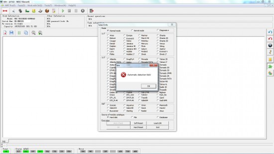

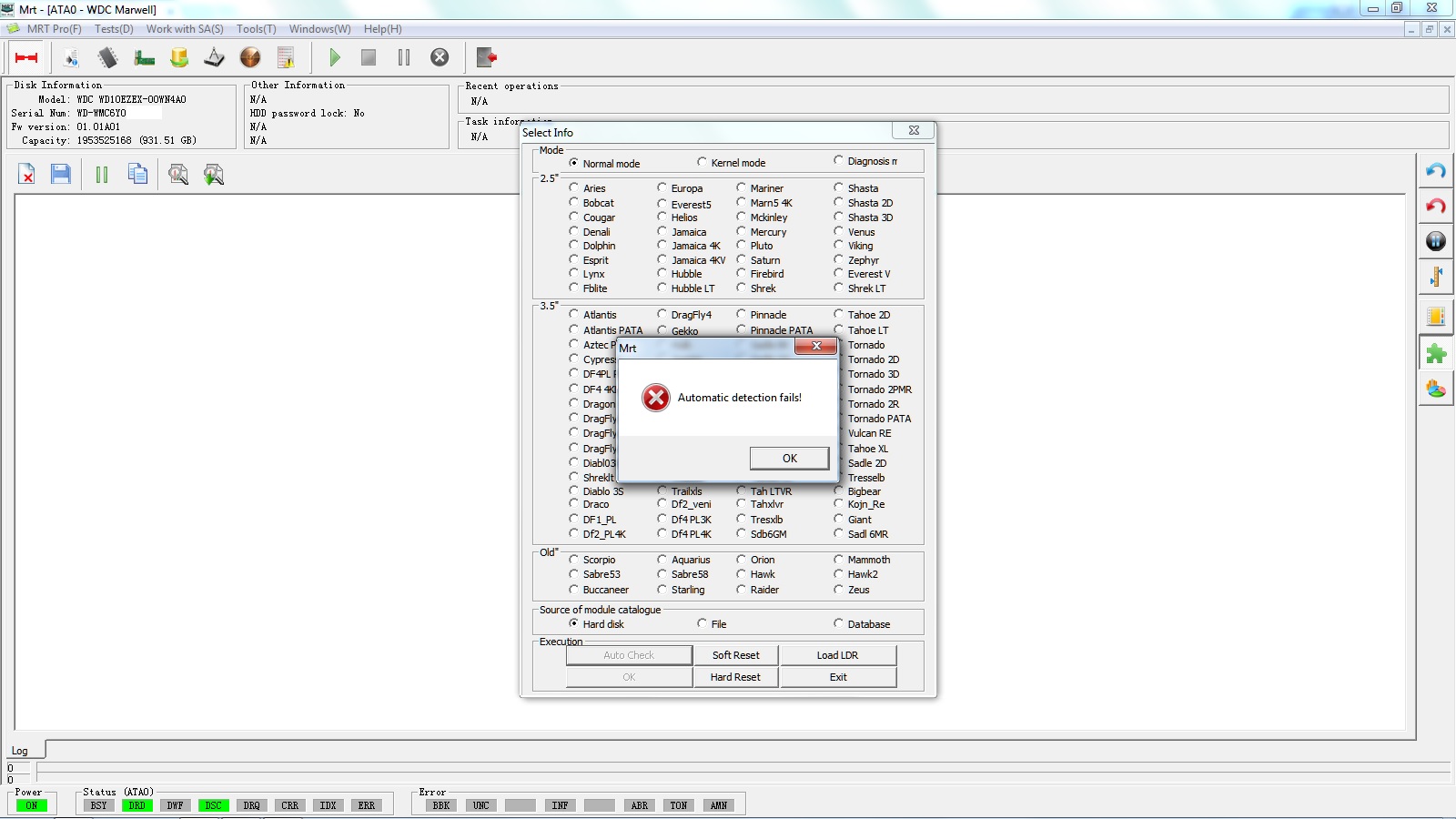

What about family of this hdd?

That's WD Blue / Tresselb family, if my memory serves me right.
You can verify that by analyzing the SA, look for "TRESXLB".

its TRESXLB"2" family (new family, not supported)
