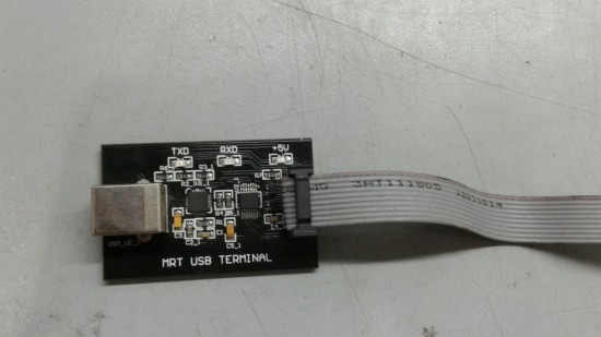

i have bought mrt. please help me how to use terminal.
i tried it but not working.

connection on terminal is wrong. you should see white dot on terminal and red side of your cable should be there... hope it will help.

Didn't get it please upload picture.

Just plug your cable in the other way on the USB adapter so that the red edge of the cable (pin 1) is connecting to pin 1 on the adapter.
