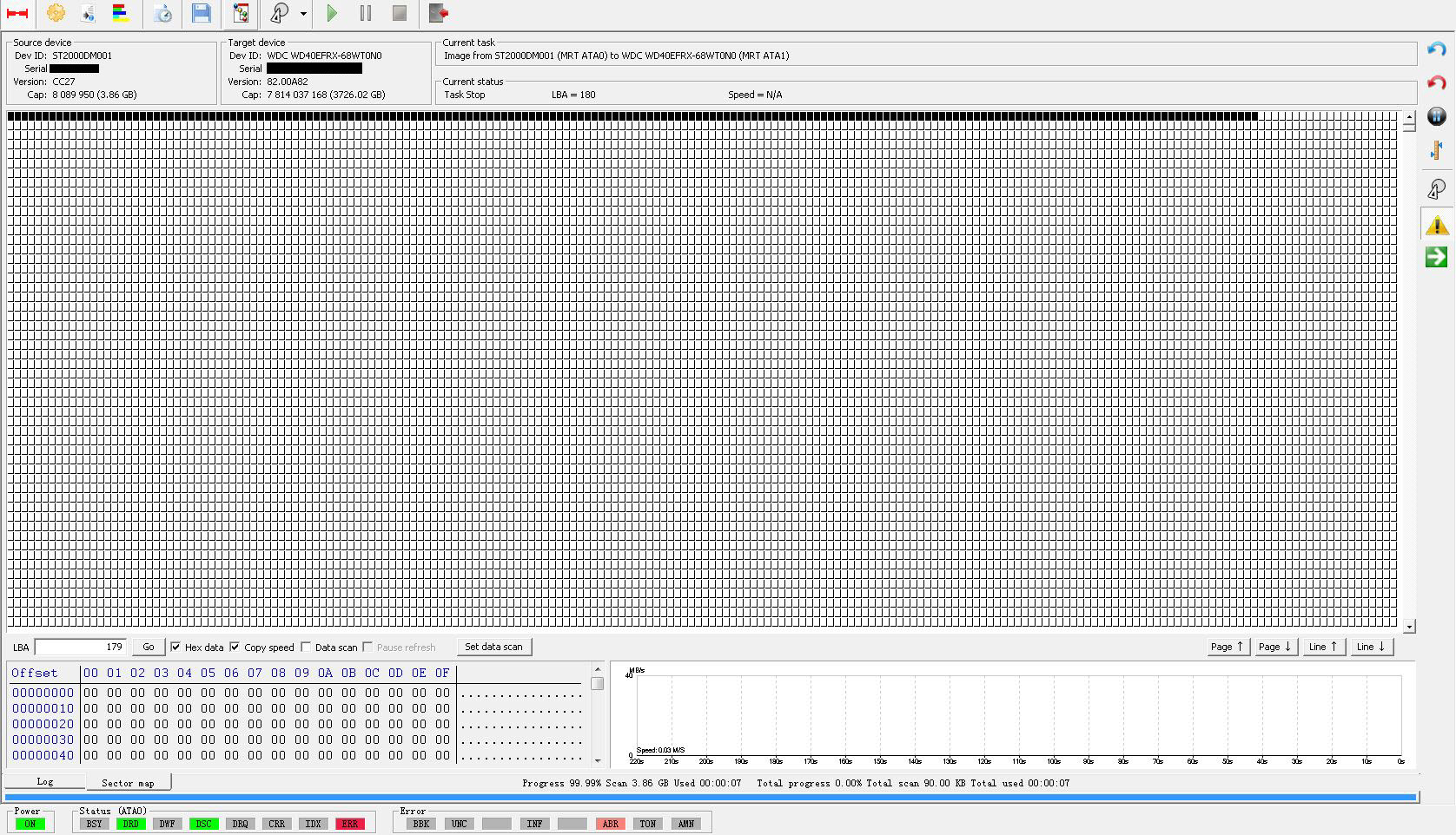

I have a Seagate hard drive (ST2000DM001) with a capacity of 2 TB. But when I attach it to the MRT it only shows a total capacity of 3.86 GB.
When I tried to mirror the hard drive failed readings.
Has someone maybe an idea why that is?

you can fix this issue by choosing disk in mrt common tools==disk scanning tools==tools==set max LBA

Is the drive spinning?
If it spins, clicks and spins down, heads are gone.
For this model, most likely Media Damage too.

FAIL  Servo Op=0100 Resp=0003
Seems to be bad heads? Thanks for your support.
