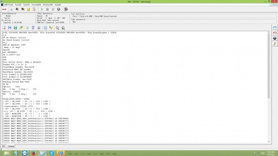

please someone help to solve this HDD problem.
please find attachment.

Try save drive with hot swap method

Modules list had been taken from head 1 that means there is some problems with head 0. Drive got in HALT, some critical errors in SA elements. You can try hot-swap, or change the heads.
