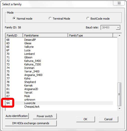

Well,
Can Someone Tell Me What Is The Family Code Of 94 Family MRT is Referring To

Here:

vx1 wrote:
Here:
Thanks Man ,
Can someone Tell Me what All Drive Model No's Are In This 94 Series

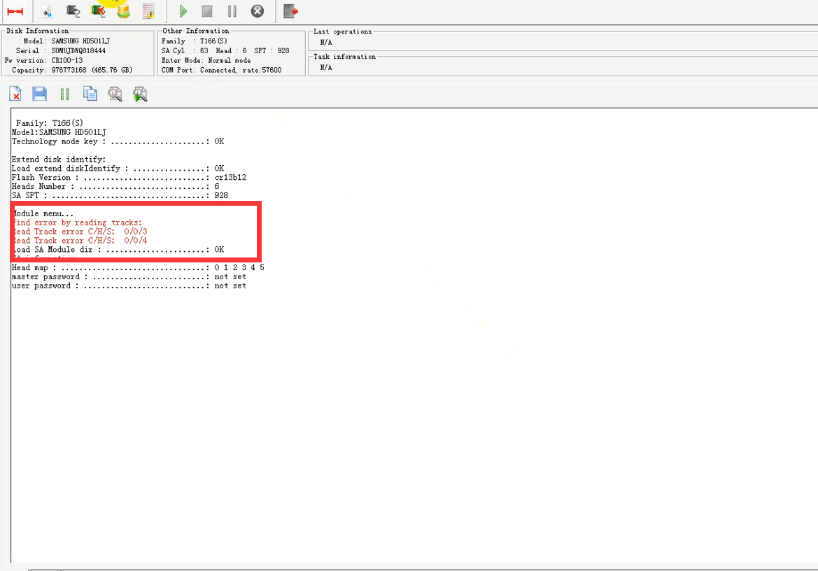

Samsung utility still has a lot of bugs, here i post a video as an example that doesn't work for T166 family.
Last MRT version is even worse...

Hello!! :D Guys you serious? Family name for ID 94 is Pharaoh Oasis and LuxorLite is SoC (drive hardware) of Pharaoh Oasis drive :)
I solve same issue of Pharaoh Oasis drive with PC3000 last year. If you need to unlock techno mode in such drives use "F3 Arch (Common)" Utility.
http://www.mediafire.com/file/a0emr0zeh ... family.wmv
software encountered a problem related to track reading process,so the firmwares displayed in the list were fake ones, which means it is impossible to gain access to actual firmware while the act of reading tracks fails

This is MRT bug!!!
It reads error on track 0 also on good T166 donor drives.
Sediv works very well with it, i don't have PC3000 but i'm sure that also PC3000 would work great with this drive.

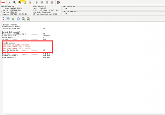

MRT 2057 vs Sediv 5232 - Samsung utility works good in sediv
I made this video to demonstrate that this is a real bug, not HDD defect.
I used good donor drive.
http://www.mediafire.com/file/7k5qngr78y5c922/
Hi, sir, thanks for your questions and support.
This is caused by module list load errors in some Samsung series, now we have fixed this problem, it will be solved in next software upgrade.
