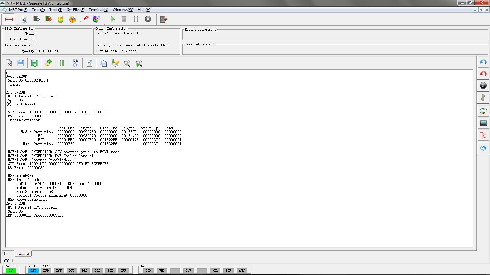

Hello MRT
I try to short pin this hdd but can not access to T>
No noise or clicking sound!
What is the main problem?

Likely bad sectors leading to firmware corruption within one or more of the typical sys files in relation to SIM error 1009.

Can not repair SIM error with MRT...

It should be a sys file problem, which could be resolved manually, as long as you can get the patient drive in ready state. All is needed is to check which file sys is damaged and repair it or replace it.

Problem with FID 17A.

get Terminal Access you can Read 17A & write from Donor.

If MRT works properly with Y-Modem and HDD can write in SA, so use T>w17a
