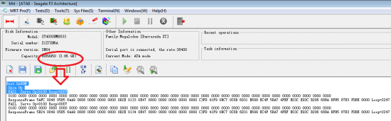

 Post subject: Seagate ST4000NM0033 SHOW 3.86GB INSTEAD 4TB
PostPosted: February 5th, 2018, 21:37
Joined: February 5th, 2018, 21:31
Location: Colombia
When I am trying To Virtual BOOT CODE , Rom Reading Failed
Can You Suggest Solution Please
See file added

judging by the log, the drive is not in BOOT CODE mode

Hi
Virtual Boot works only for DM series.

Heads are bad (servo 007)
+1 and or media damage
but IIUC the OP wants to read the ROM in boot code mode
