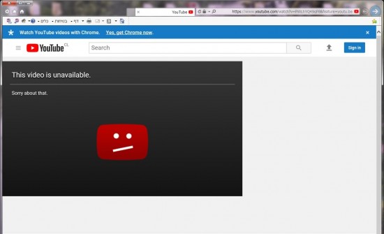

https://youtu.be/PWLhYQ49qP8
https://youtu.be/09fszTYzjtQ
https://youtu.be/11a2ecTYTc0
This was also known issue with salvationdata,putting links that don't work,I waiting to see the problems I mentioned works in samsung and wd 2.5" 500gb drives.

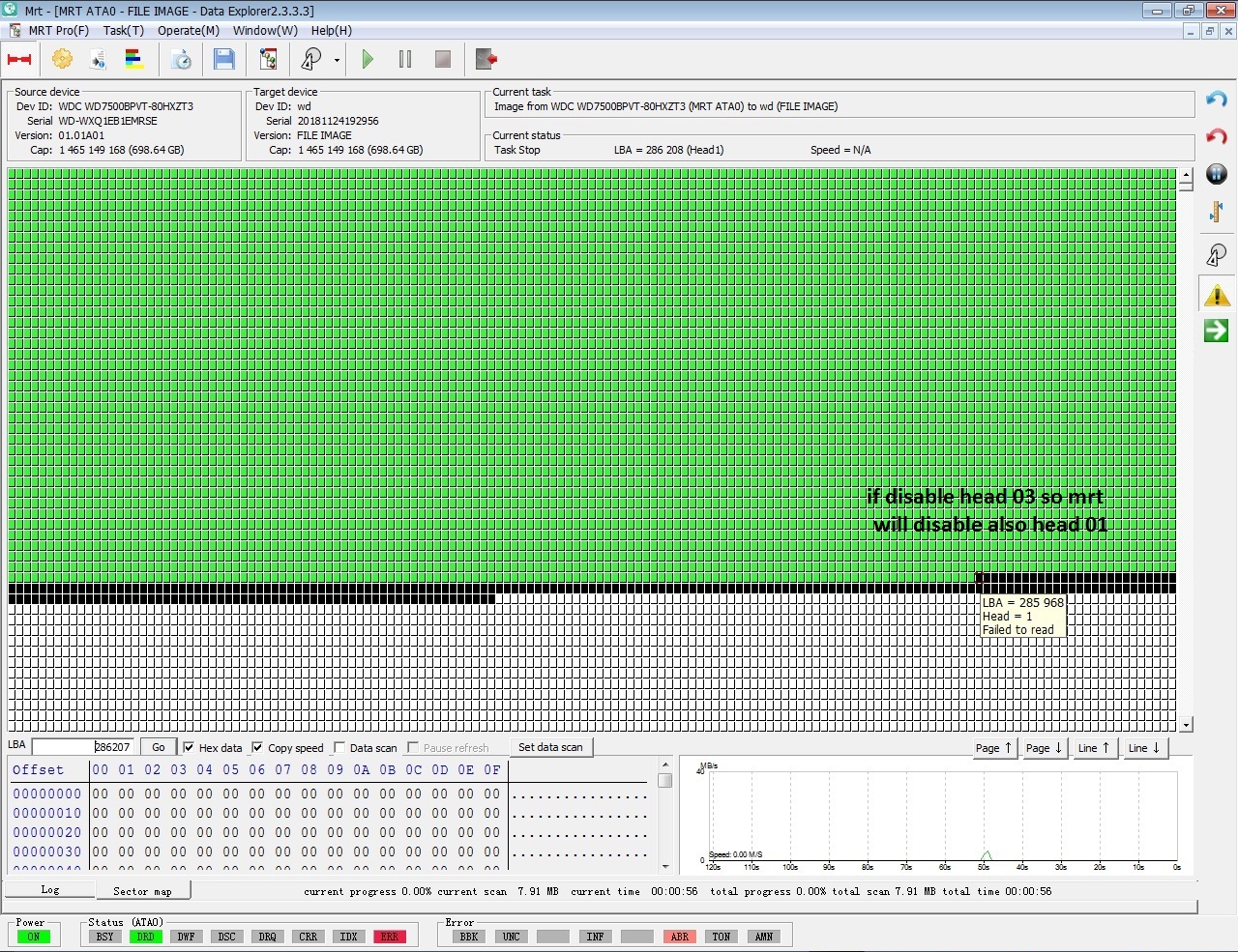

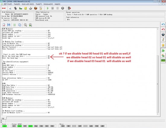

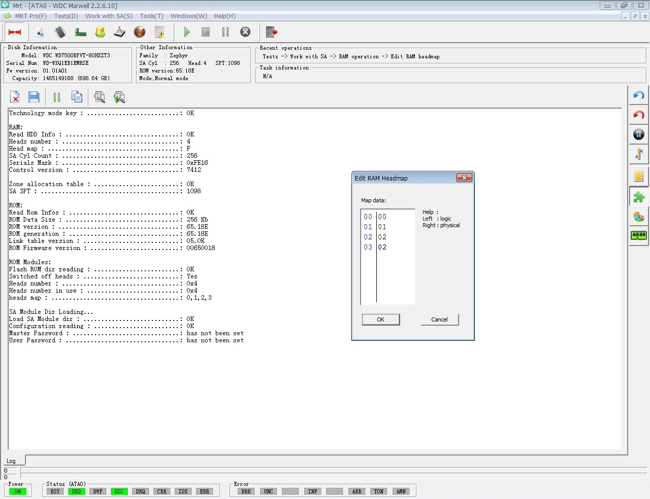

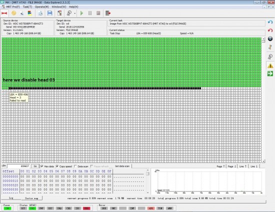

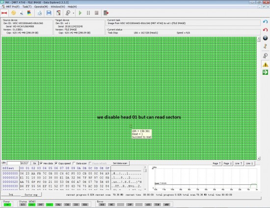

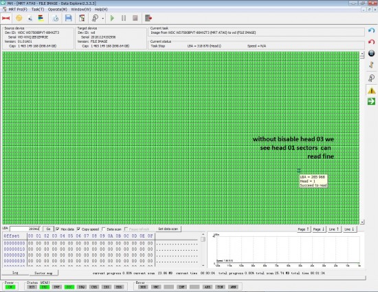

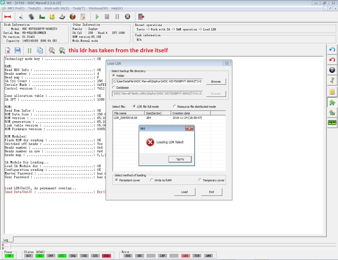

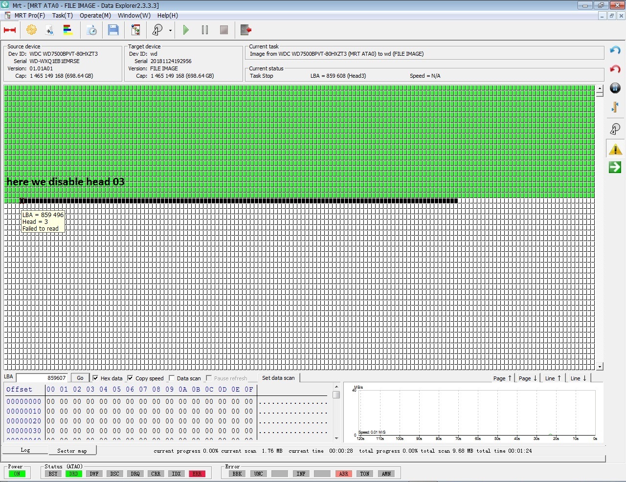

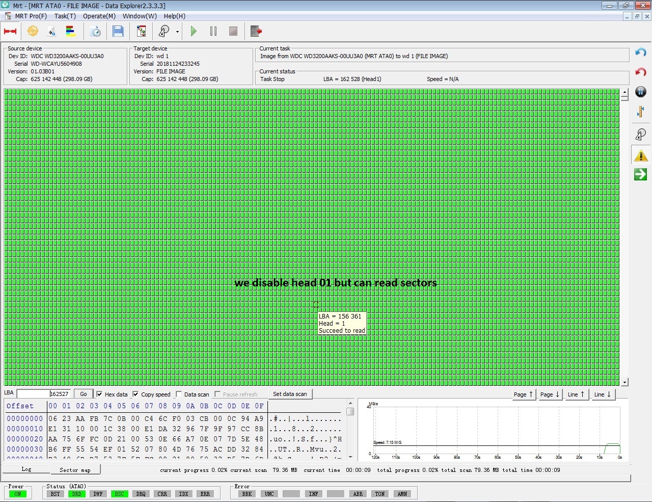

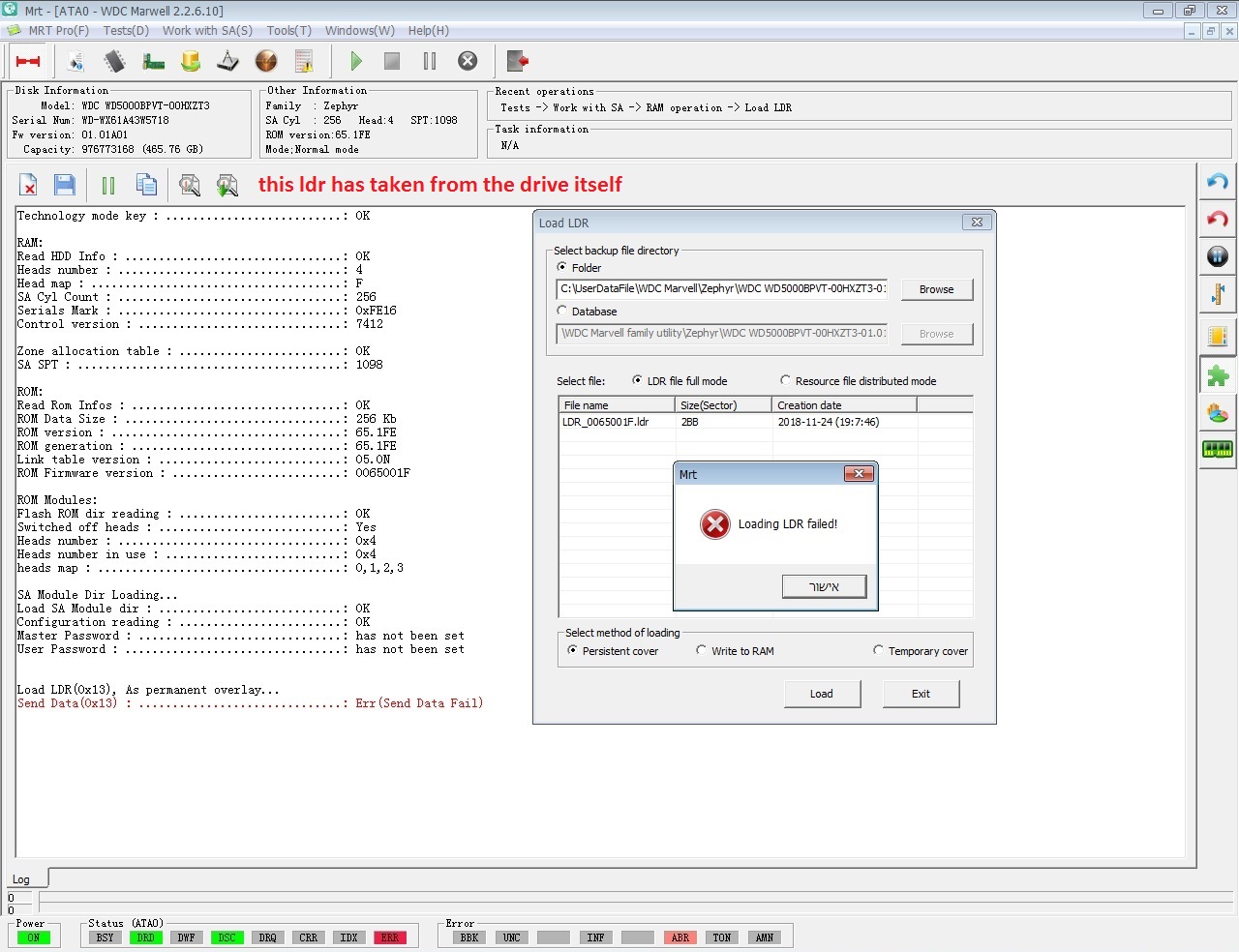

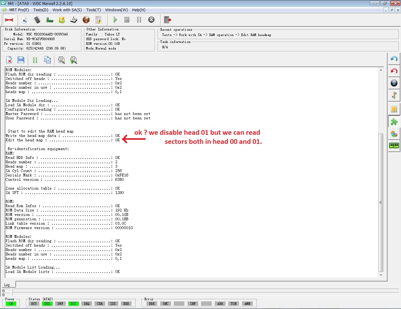

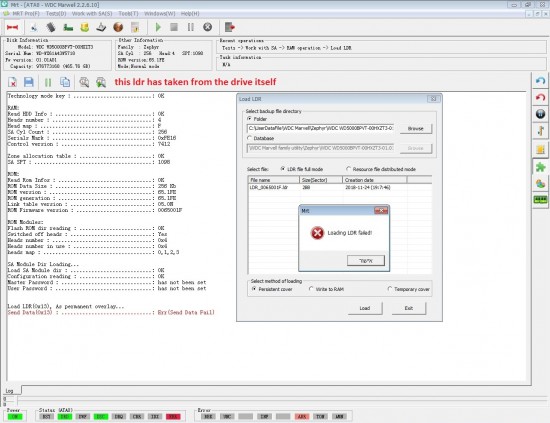

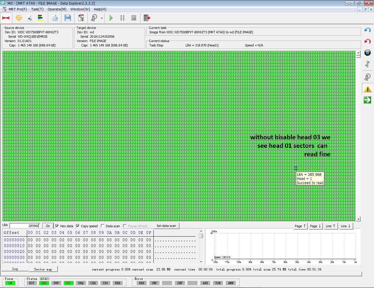

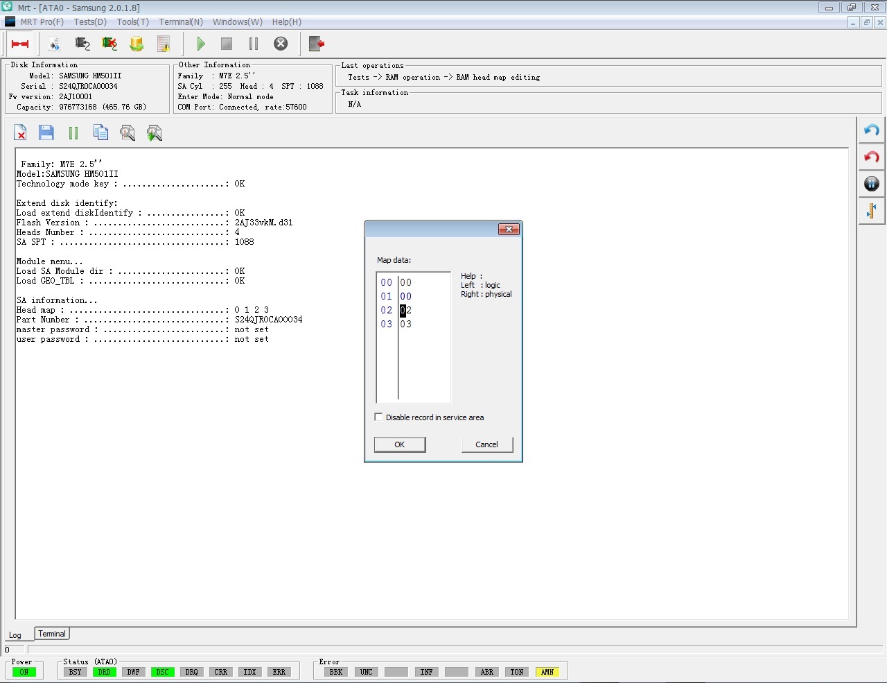

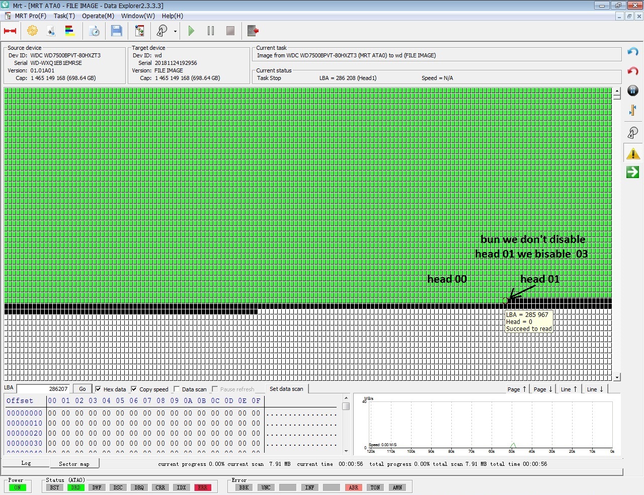

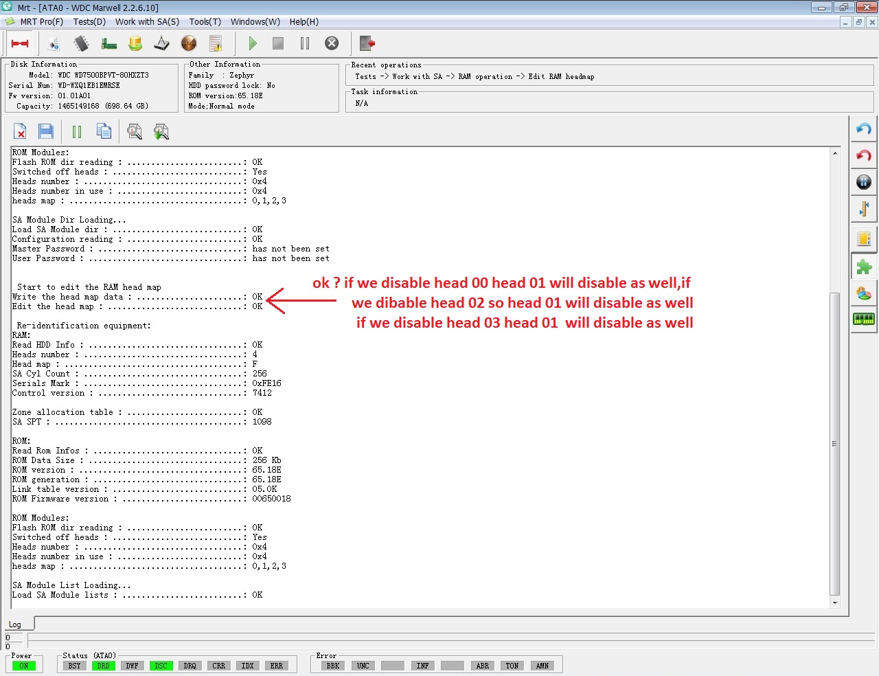

Smoothly in one out model of hundred,you are developing mrt to work with one model then moving develop the next function leaving most models unsupported with the first function ?
otherwise there is no explanation how accidentally all drives in my stock does not word with this functions,ace lab and dolphin lab do not work that way,there are basic function who should work widely in most drives models.
Baside,when written in mrt "ok" or "succeeded" it is not necessarily true as I will describe below with screenshots.

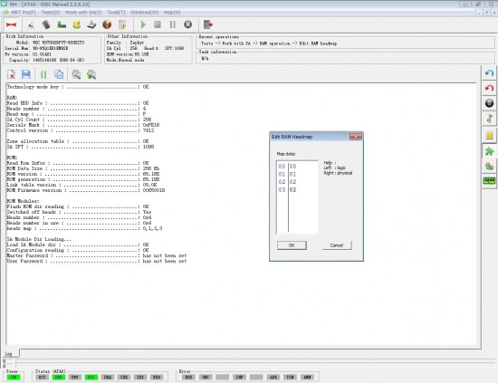

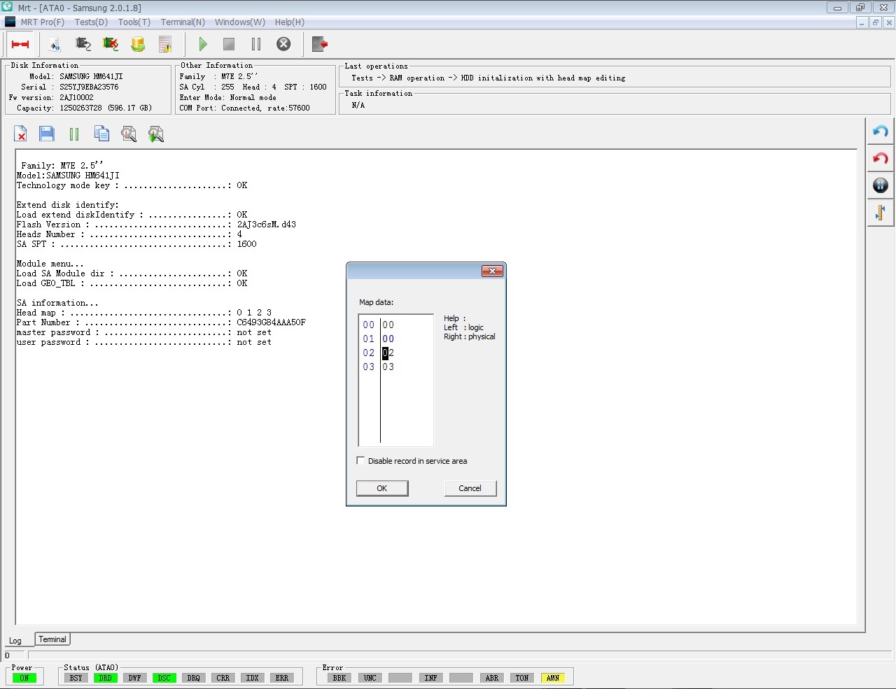

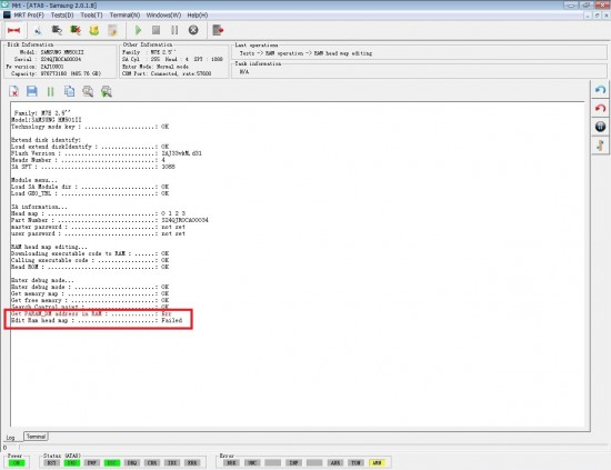

And here edit head in ram as mentioned in mrt video not working in samsungs drives.
mrt samsung edit Ram head map failed another model.jpg [ 217.99 KiB | Viewed 32262 times ]

 Post subject: Re: MRT Support
PostPosted: November 25th, 2018, 14:51
Joined: November 5th, 2015, 18:00
Posts: 82
Location: in the lab

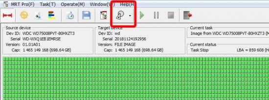

Do you want to disable a head, to avoid use in scanning?
Use this function here:
Here you create the headmap and choose which head to use in the scan.
Make sure this works for what you need.
VEXUS Data Recovery

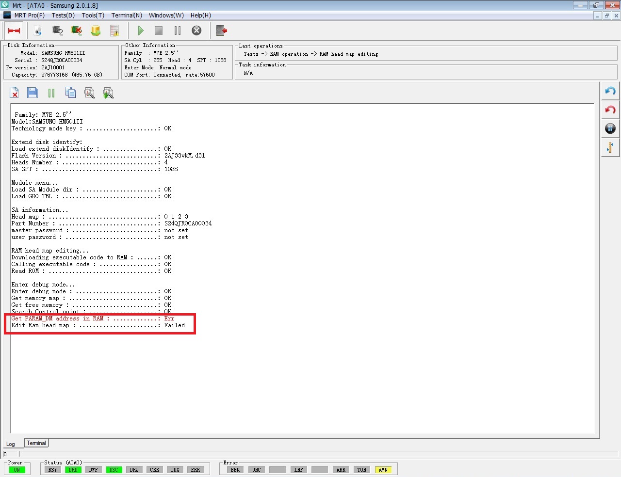

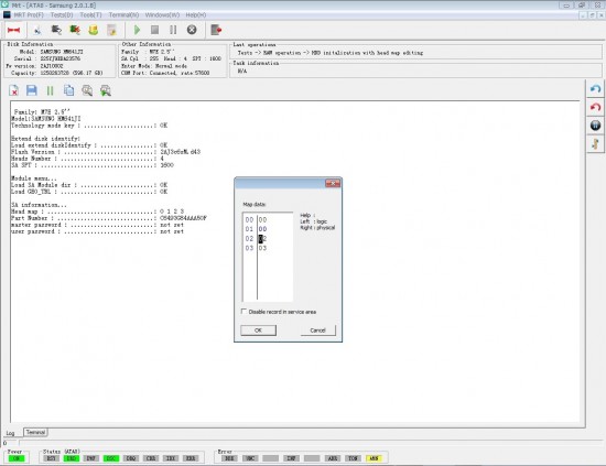

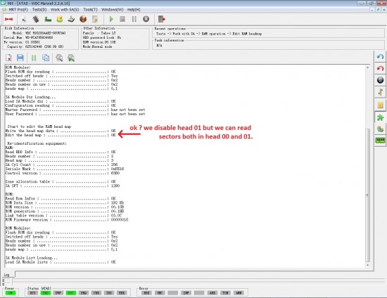

Headmap in DE and edit head in ram are completely two different functions used for different situations ,I need the edit head in ram to work,I just use data explorer to prove edit head in ram does not work at all or properly.

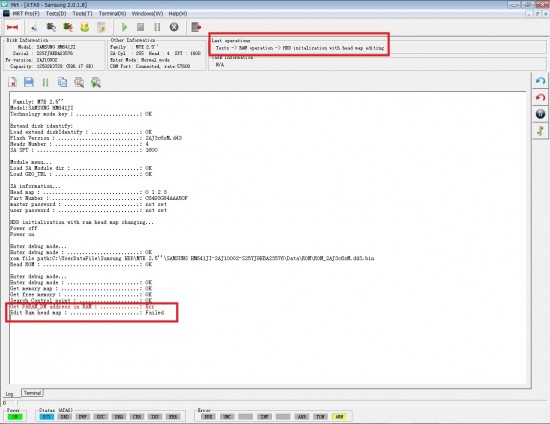

yuji22 wrote:
The latest version of MRT is 2.1.2.8 What version is he using ?
Nice try to mislead, MRT speaker! I'm using the latest version 2.1.2.8 and this is the main software version,what you see in the screenshots it's the wd or samsung repair software versions.

Jirbun wrote:
Thanks for your suggestions, we have fix the bug, hope you can feeback us more.
We have upload the video as below:
https://youtu.be/v3HfaPpS3I8
