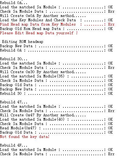

Dear spildit mrt use two method the first trying load from sa backup and if fail go to method two is rebuilding the 47 from mod40 like the attached picture.
