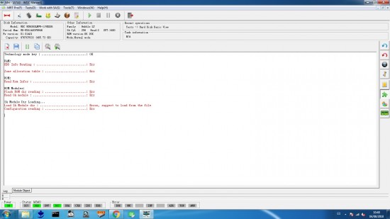

I have a hard drive WD5000LMVW-11VEDS6.
The disk has the heads ok, and it reads completely by id, track and ABA if I deactivate the 0x411 module, but at the moment that the active one can not read anything.
I try to repair slow response, but it does not do anything.
Any suggestions

I have full access to the user area, but not to the SA.
To access the SA I have to deactivate the module 0x02 or EL 0x411.
Some idea to repair this problem?

this is a sed drive just disable mod 411 and you have access to all modules make backup and solve slow responding mod02 and clear mod 32 enable 411 and you can copy the data full speed.

I have all the data saved, but when I delete the 0x32 module I do not have access to the data. I may be doing something wrong. I'm going to recover the SA by clues and try it again.

You shouldn´t "delete" the 0x32 module, just clear some parts of it.

Actually I deleted a part of the module data and it works perfectly.
