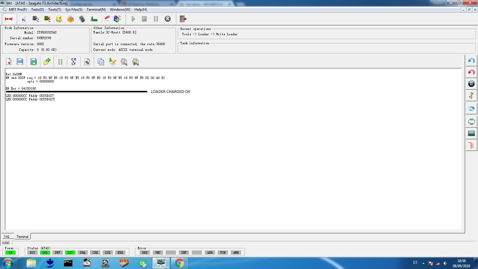

This disc has the upper plate with a deep groove. striped dish.
I changed the heads and modified the ROM with the MRT to adapt it to the new heads.
The disk tries to start with the same noise as before changing the heads and stops.
I get to load the LDR without problems, but the disk after loading the LDR still does not turn.
In the terminal it leaves: "LED: 000000CC FAddr: 00258B57"
For the depth of the disc I am afraid of spoiling the new heads, since it is about 5 mm from the outside of the disc and I think that is where the SA is written.
Before continuing with the album if someone gives me a suggestion, I could help.

Una imagen de la mrt

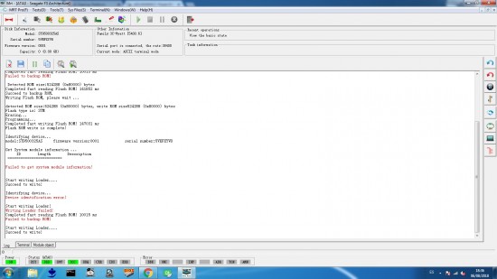

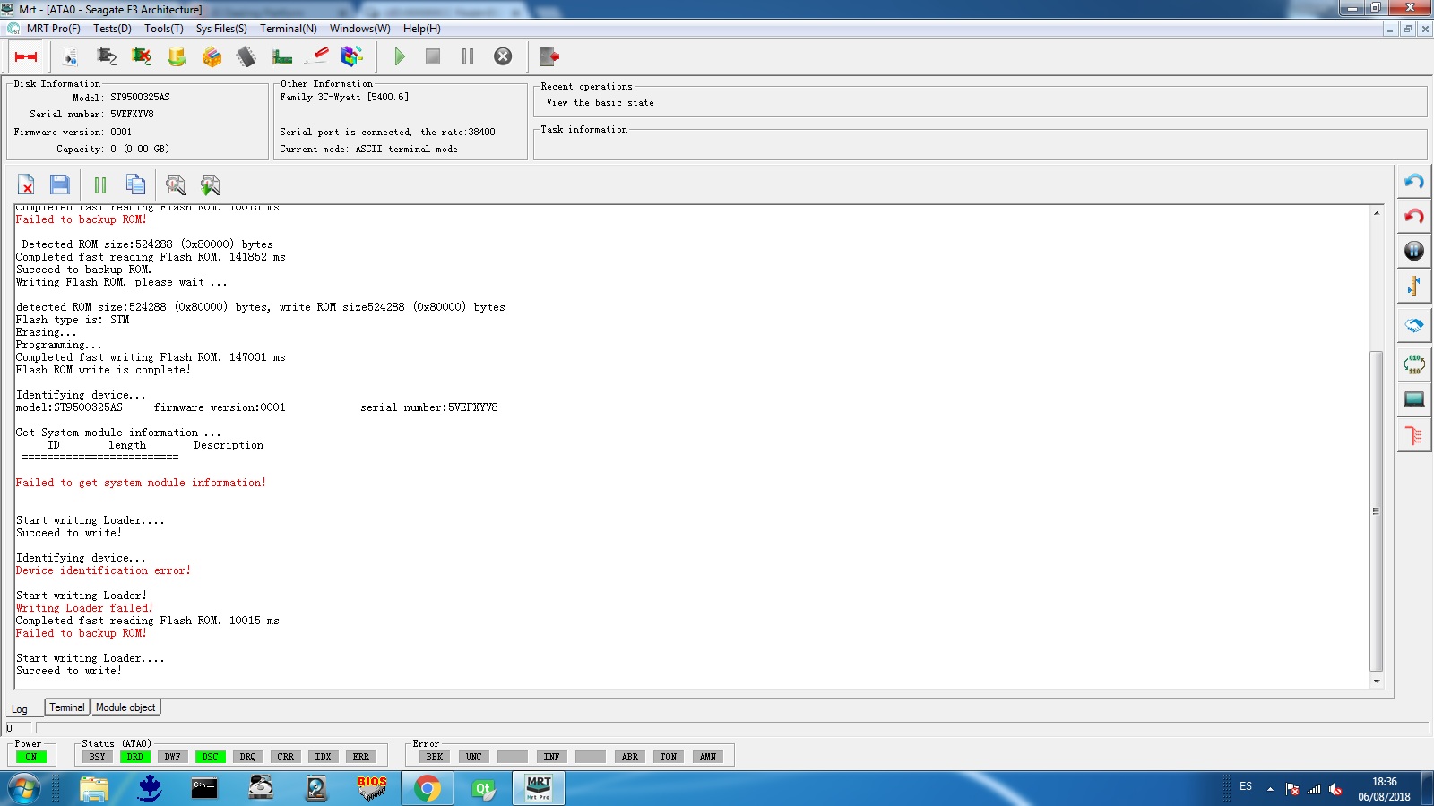

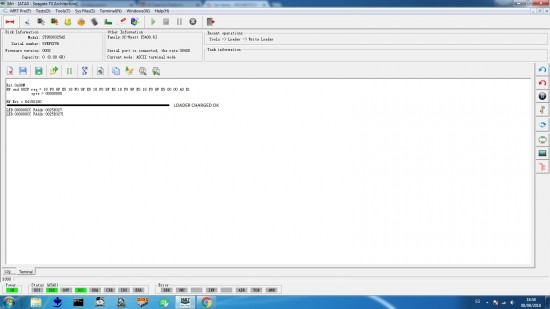

can you show some screenshots of terminal interface?
 Post subject: Re: MOMENTUS 5400.6 - striped dish
PostPosted: August 8th, 2018, 13:05
Posts: 474
Location: spain
Try to read the disc and after a while the engine stops and enters rdy.
If you try to do something with the disk, which I really do not know what to do, enter BSY.
When it enters LED CC .....; I lose connection by terminal.
At the same moment that it gave symptoms of being bad the heads should have disarmed the disc and verify the state of the heads. Now I think I have lost it.

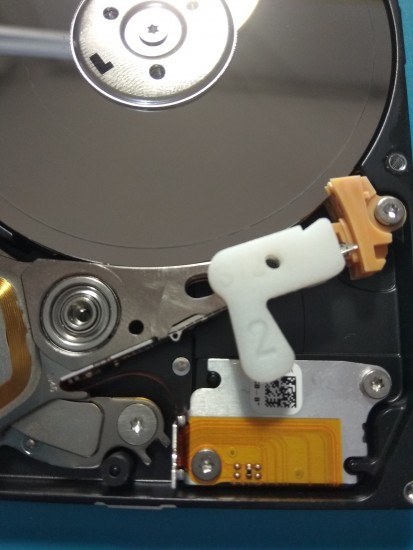

I have asked for another donor for the album.
I will change the plate, heads and adapt the ROM.
I put an image of how the disc is.
The sound of the HDD did not make me think it was scratching, but I should have examined it first.
