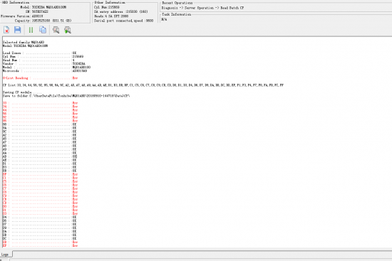

 Post subject: Model: TOSHIBA MQ01ABD100M ( G-list Error )
PostPosted: September 10th, 2018, 5:59
Joined: September 10th, 2018, 5:48
Posts: 97
Toshiba 2.5" 1TB
G-List Error
Smart Cleared
G-List Clear Error
User Sector Error, Any Help or suggestion?
Selected family:MQ01ABD
Model:TOSHIBA MQ01ABD100M
Load Zones : .........................:OK
Cyl Num : ............................:215669
Head Num : ...........................:4
Vendor : .............................:TOSHIBA
Model : ..............................:MQ01ABD100
Microcode : ..........................:AXG01UA9
G-List Reading : .....................:Err
CP list:33,34,44,56,92,95,98,9A,9C,A2,A5,A7,A8,A9,AA,AD,AE,B1,B3,BB,BF,C1,C5,C6,C7,C8,C9,CB,CD,D0,D1,D3,D4,D6,D7,D9,DA,DB,DC,DD,EF,F1,F3,F4,F7,F8,FA,FB,FC,FF
Saving CP module......
Save to folder:C:\UserDataFile\Toshiba\MQ01ABD\20180910-144718\Data\CP\

CP Saving module is ok!

Can you upload the resources, including a ROM and track dump?
I suspect that most of the CP errors are bugs in your tool.

I think the problem should be no accessing SA/Data area. Probably bad heads or media damage, since he can only read CP from PCB and nothing from SA...

Track 1 damaged, need to read it first, than write it to repair the logical damage.

There are several "Err" CPs which are ROM resident, eg 33, 92, 95. I believe these "errors" are due to a bug in the tool rather than a damaged ROM. A ROM dump would enable us to confirm this. In any case these false errors are obfuscating the real problem.

MRT does that even on healthy drives, so I don't care it too much.
