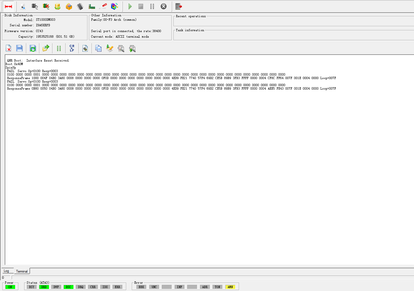

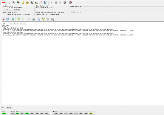

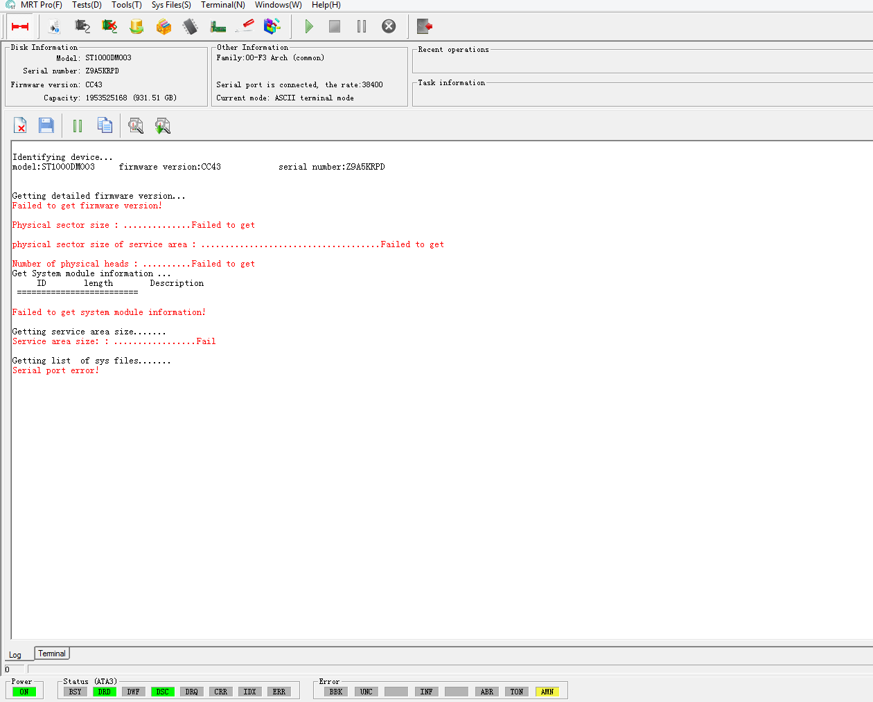

Drive spins up in starting and spins down as terminal message appears.
i think virtual loader might help.
i am looking for the loader file please help and support with suggestions.

The first thing you have to do is unlock the firmware.
With this you will have access to read the SA.
Once you have access to the SA, make a complete copy of all the resources of the SA, if it leaves you and then you will know that it is not a problem of heads.
I think that disk can be easy to solve, but do not rush.

Tried Virtual Boot, Error in exchange commands.
Not Successful.
Head Swap Done, Same result.
Any more solution?

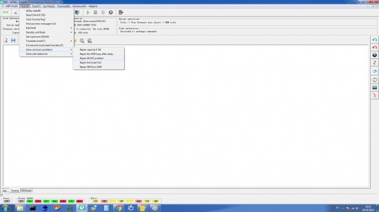

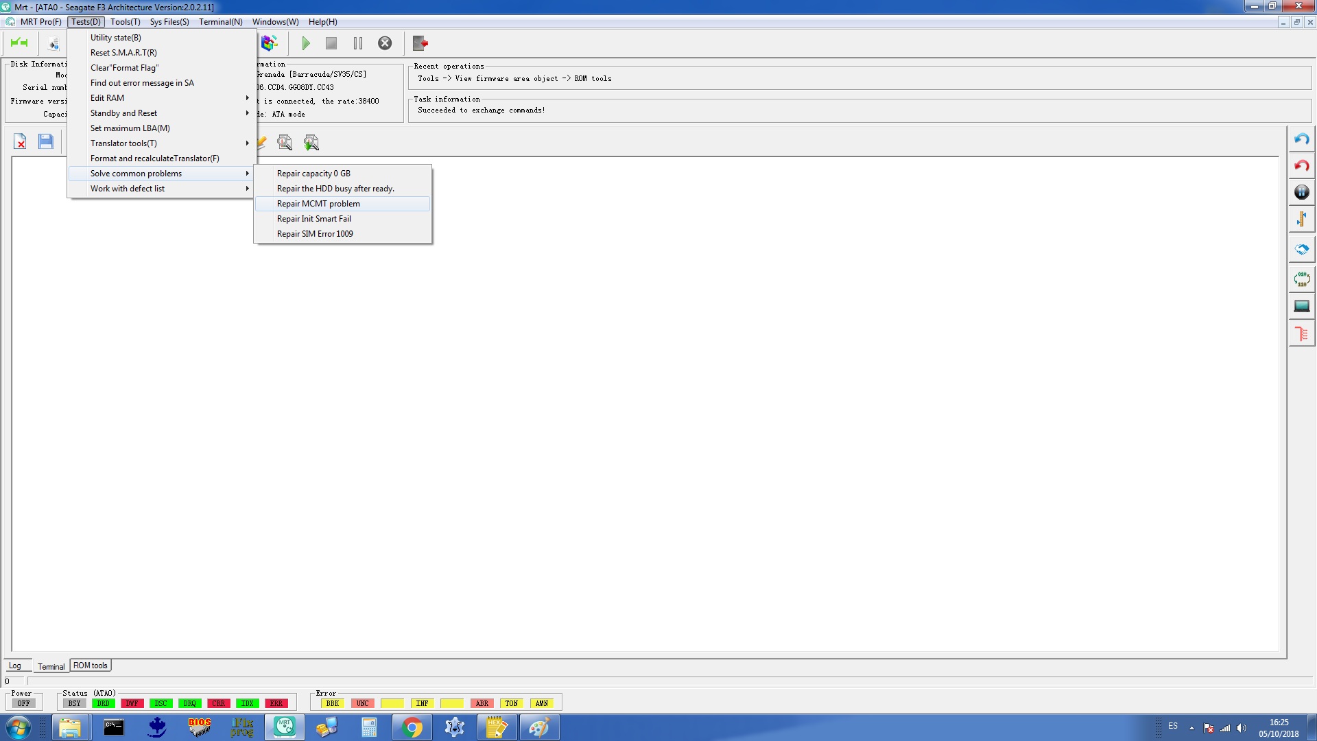

I would do the following:
First unlock the firmware to access the SA.
Then repair mcmt problem.
And I hope you have access to the data.
I hope they have not damaged their heads.

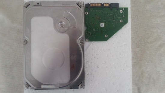

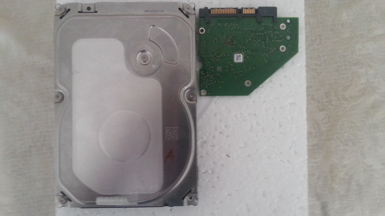

Strange HDD doesnt have sticker originaly.
No info about HDD.
PCB:100749730 revA
PCB died. Client send me a donor PCB. Lucy Its compatible.
I removerd patient ROM . Readed. And writed to Donor PCB.
Here ROM Patient.
ROM.rar [264.83 KiB]
Downloaded 903 times
Also Head swap necesary. Heads died.
How could I chose donor for head swap.. I need help.

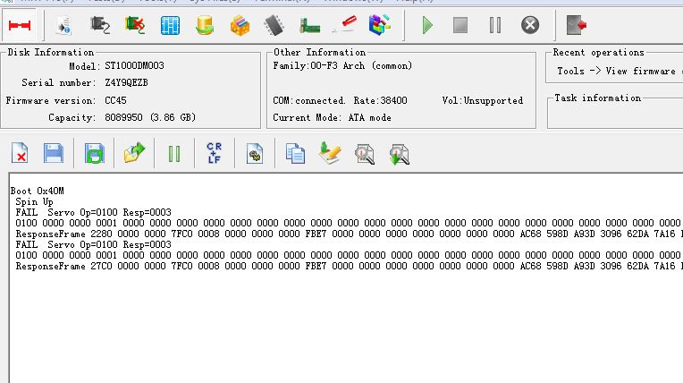

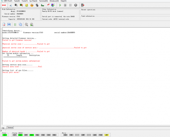

No terminal access. Not get T level or anything. Stopping after
Boot 0x40M
Spin Up
FAIL Servo Op=0100 Resp=0003
0100 0000 0000 0001 0000 0000 0000 0000 0000 0000 0000 0000 0000 0000 0000 0000 0000 0000 0000 0000 0000 0000 0000 0000 0000 0000 0000 0000 0000 0000 0000 0000
ResponseFrame 2280 0000 0000 7FC0 0008 0000 0000 0000 FBE7 0000 0000 0000 0000 0000 0000 0000 AC68 598D A93D 3096 62DA 7A16 FBF3 FD00 BF21 F4A1 0000 007F 0004 0000 FFF7 0004 0010

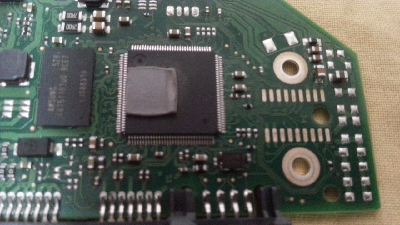

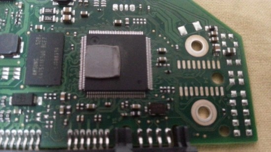

Is ıt read channel marked with circle?

I hope not this drive is a client case, you really need some basic training.
ROM for that drive will tell you all you need to chose the right donor.

HDD owners saying drive not opened. But opened before. No filter inside. Ramp mounted wrong so head stacked front ramp. Sticker removed by someone. I saw when look again drive cover closely. I am not sure about if that rom original. So guarantee paper come with drive. Drive model number different on that paper.
I have 2 donor. But don't know whether possible to get data if ROM not original.
Look like I would spend 1 random donor . Look like this would be a bad experience and I would spend a donor. I don't like Seagate also.

If ROM is not original, you can't do nothing to recover it.
