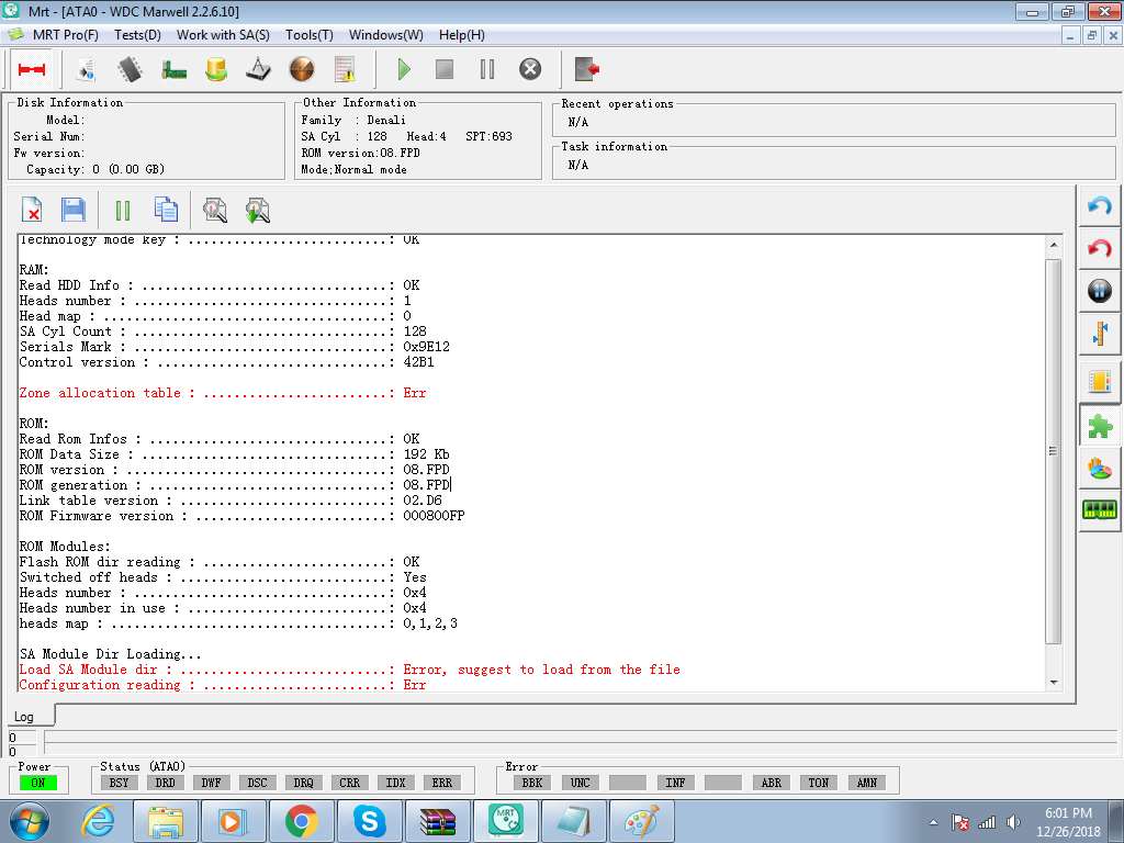

 Post subject: Zone allocation table : ........................: Err
PostPosted: December 26th, 2018, 8:33
Joined: December 25th, 2018, 3:15
Posts: 11
Location: Varanasi
WD3200BEVT-75A23T0
in MRT Show Error
Any Solutions
 Post subject: Re: Zone allocation table : ........................: Err
PostPosted: December 26th, 2018, 10:43
Posts: 1749
What's the drive behavior? (Clicking)?
ATA registers shows nothing? Is the drive spin down?
If yes, then most likely a head/s problem.
PostPosted: December 26th, 2018, 11:08
Posts: 11
Location: Varanasi
hard drive sping ok
head test ok
no clinking sound
PostPosted: July 22nd, 2021, 17:46
Joined: July 21st, 2020, 23:30
Posts: 5
Location: Porto Alegre
Spildit wrote:
Block SA access at start up by shorting points on PCB. Load overlay, load DIR to RAM (initialize dir). Try to check modules.
Similar procedure with WDMarvel (you need to adapt it to MRT) :
http://www.hddoracle.com/viewtopic.php?f=193&t=2339
If it doesn't work :
http://www.hddoracle.com/viewtopic.php?f=193&t=2343
If you get servo errors, etc you might have bad head(s) and/or pre-amp.
Please "adapt" my guides to your MRT tool as i've written my guides to WdMarvel / HRT.
Hi, these links are broken, do you have saved examples?
