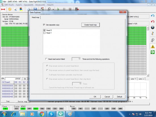

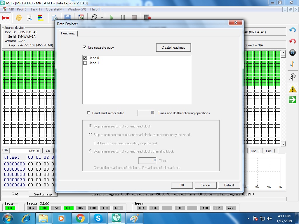

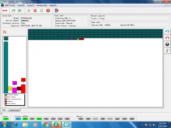

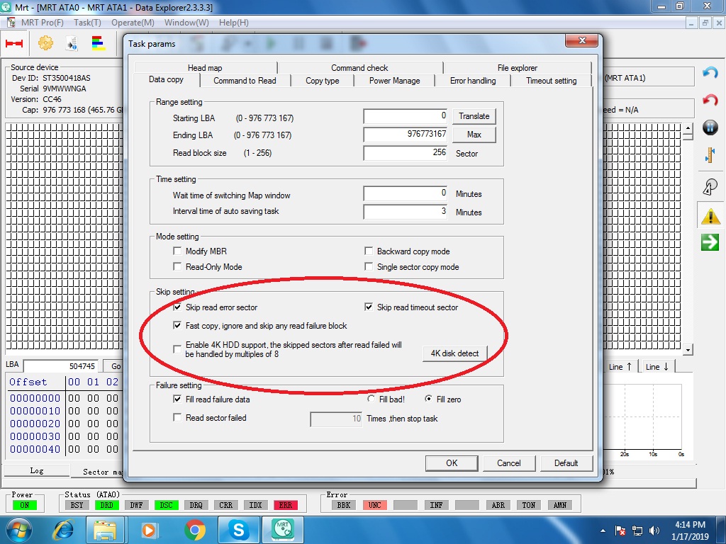

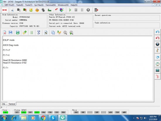

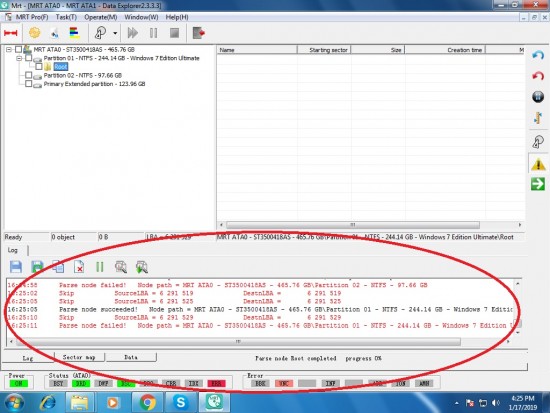

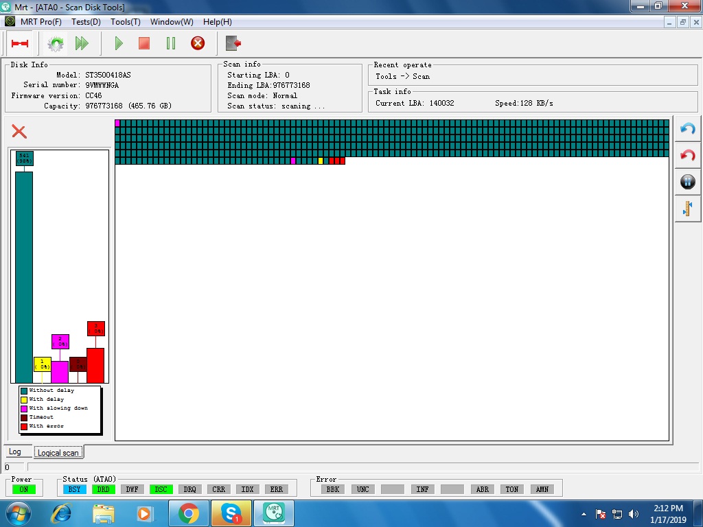

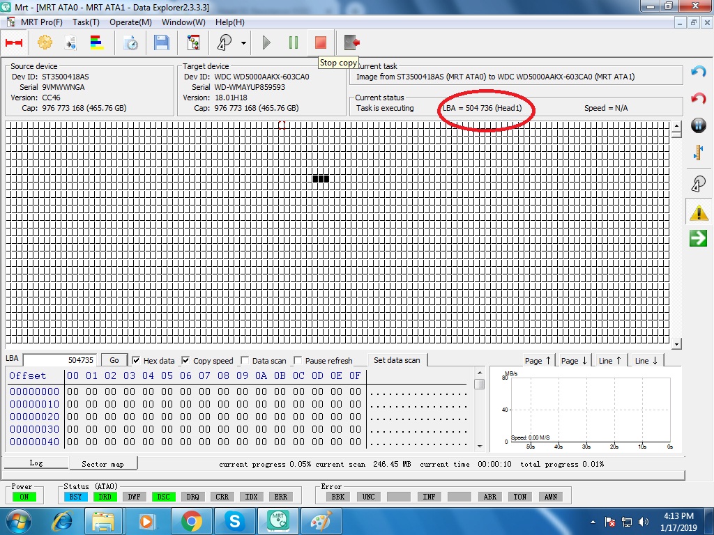

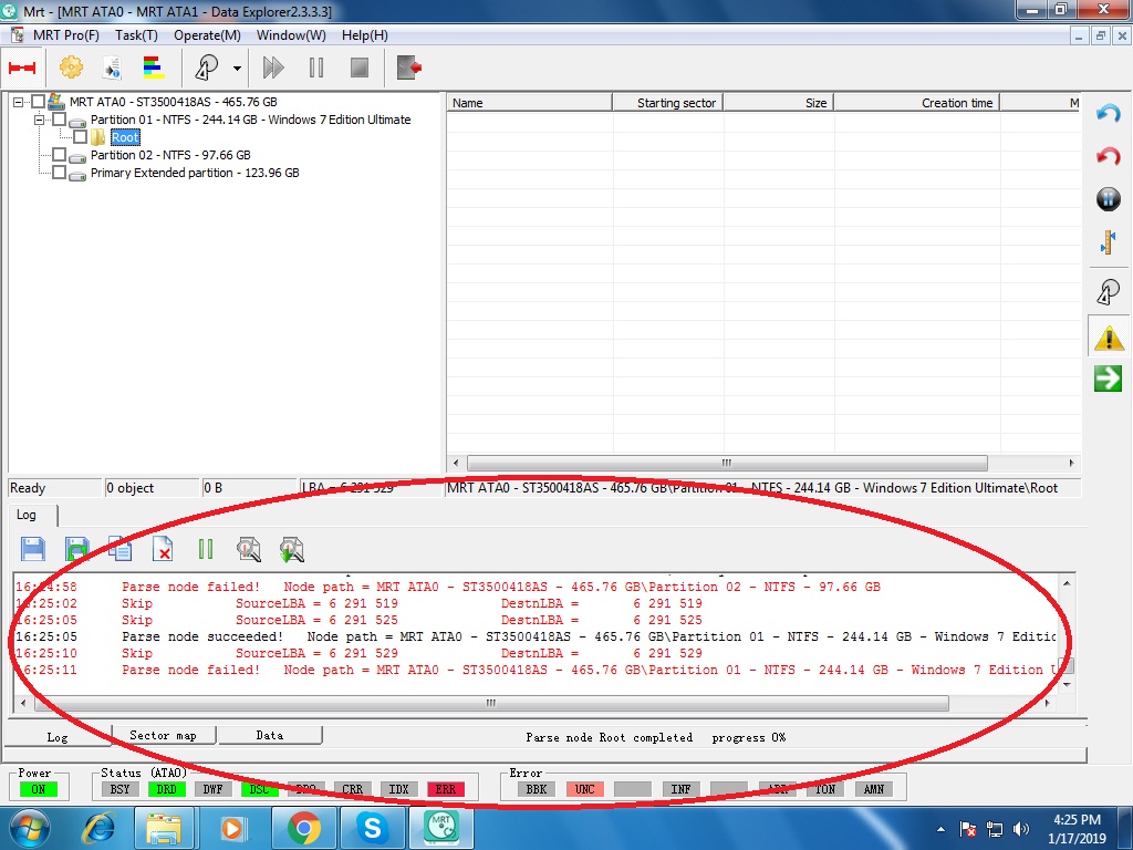

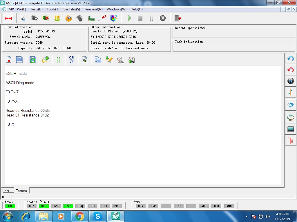

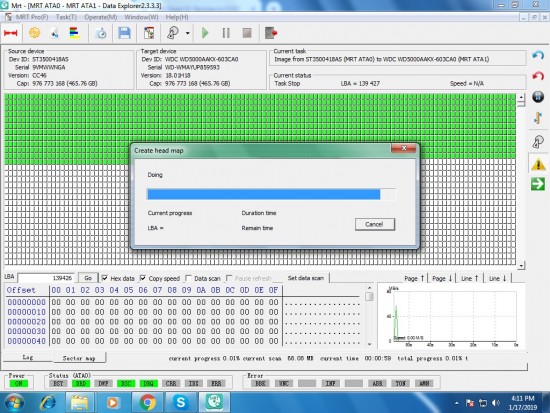

Hello friends
how to recover a data ?
 Post subject: Re: bad sector
PostPosted: January 17th, 2019, 8:16
Posts: 842
Location: Pakistan
need to change heads
Data Recovery Pakistan

can possible to recover data via MRT ?

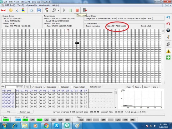

PostPosted: January 17th, 2019, 10:42
Both heads stop reading at the same point or does one head read further than the other?
PostPosted: January 17th, 2019, 11:39
Joined: May 6th, 2013, 2:48
Posts: 84
yes both heads stop reading same time.

Abdul Rauf wrote:
I stand corrected, its definitely partial sector access, you probably messed up translators without considering the defects from NRGlist.

Spildit wrote:
The PC-3000 have that "fork" method option to fix translator that can be very usefull on this sort of sittuation ...
Even the Salvation Data HD Doctor for Seagate have an option to deal with this (that works like "Leonardo Method" - http://www.hddoracle.com/viewtopic.php?f=6&t=196 ).
For MRT you can use the instructions provided by MRT staff on those mentioned MRT articles or if it fails you can check the entioned example of how to fix this using SeDiv and apply the same method to MRT.....
Please do tell us if you do make progress with this recovery !
MRT Technical Staff see my case on tv next working day.

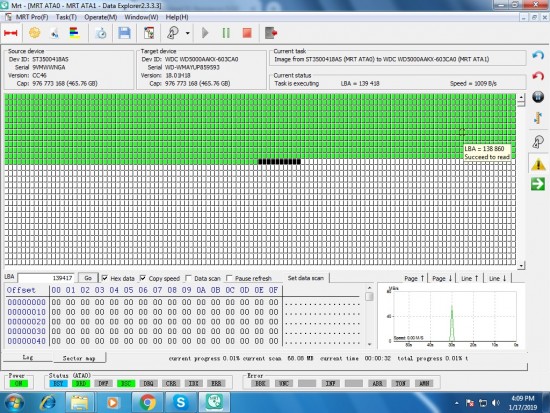

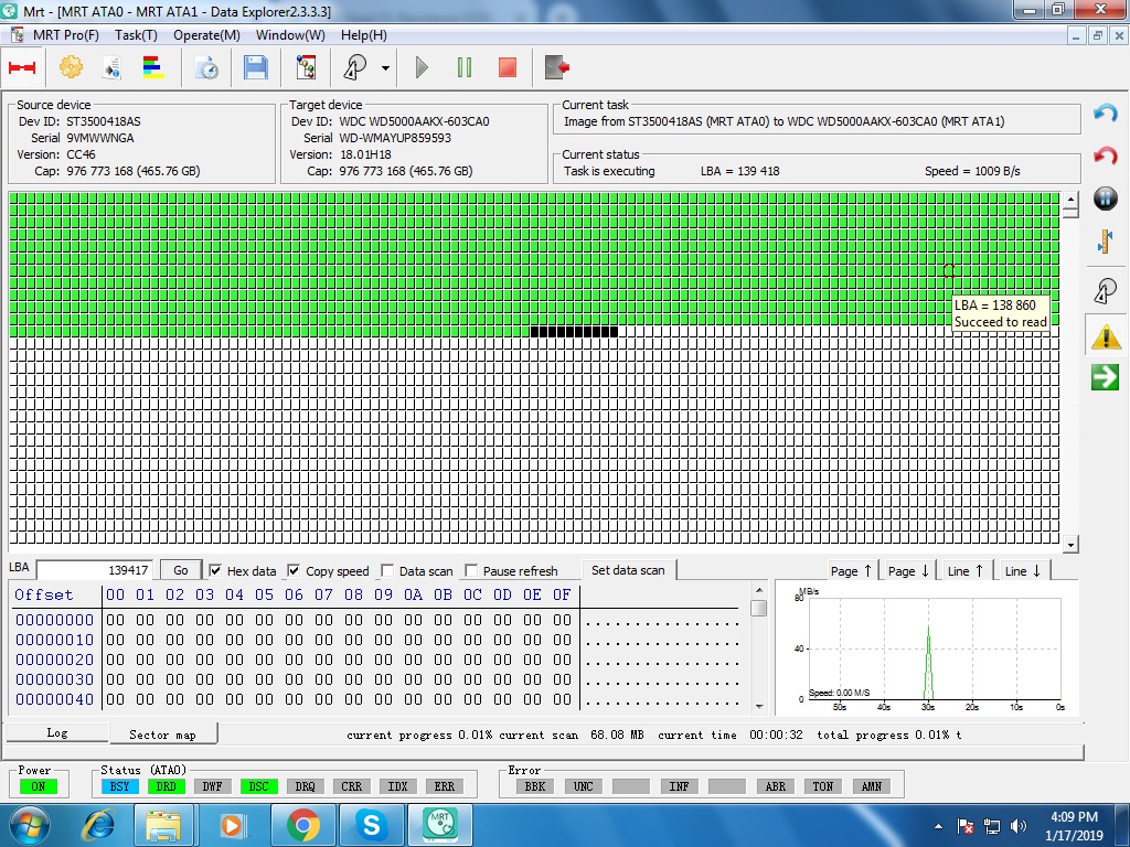

PostPosted: January 29th, 2019, 10:11
Posts: 489
Location: Usa

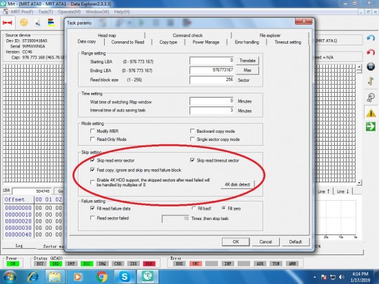

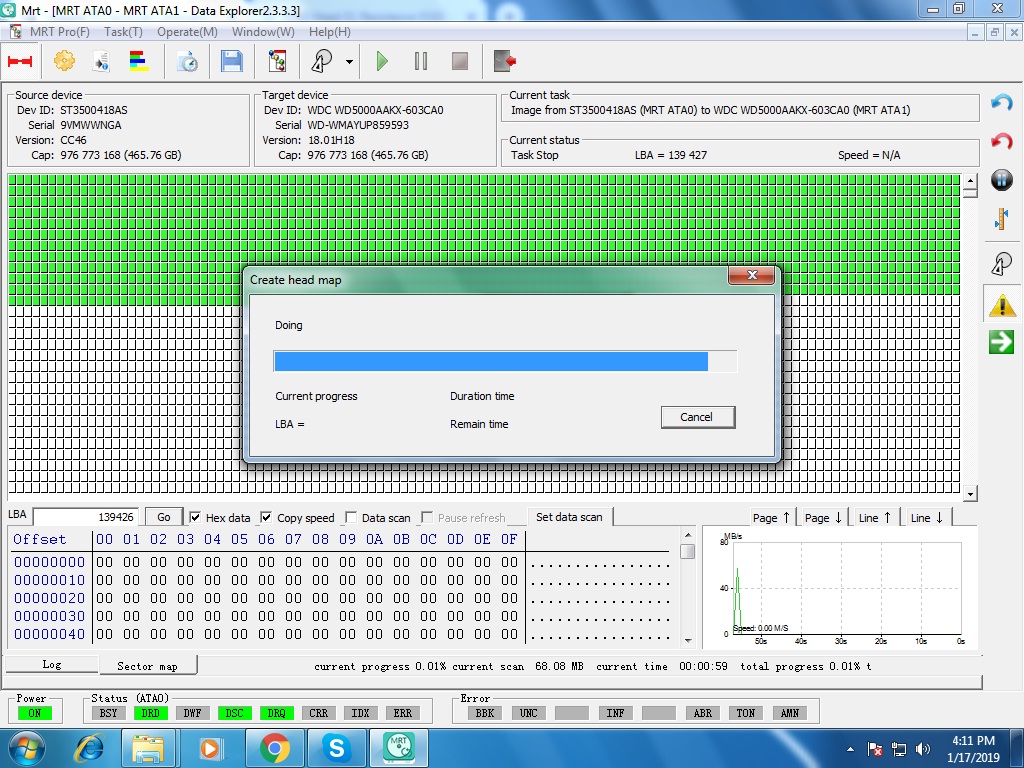

Try to start different LBA positions.
Other options
Remove fast copy option
Go error handing part (pic3)
Use hard reset and power reset . And use a skip block value like 100 or 100000 .
Go timeout setting part (pic3)
Increase default ms timeout numbers. It's very useful for weak heads/slow sectors . Select hard reset and power reset.
Also u can use backward reading if you wish.
