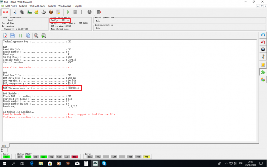

Hello
I need the LDR for a WD 1TB drive. Here is the full screen pic.
Your help is much appreciated.
File comment: WD 1TB 2.5"
Family Fblite
Versión: 00160094

 Post subject: Re: Need LDR for WD Fblite 00160094
PostPosted: February 27th, 2019, 7:59
Joined: February 20th, 2019, 23:54
Posts: 23
Location: USA
Thanks for the help, but..
Isn't the file I need an LDR_00160094.ldr file?
You sent a 11.rpm file.
Sorry for my inexperience with this issues, but I'm new in the field, and willing to learn.
If the file you sent is the correct one, how do I use it so the hard drive reports the correct size, and I can proceed and extract the info?
TIA
PostPosted: February 28th, 2019, 1:00
Posts: 23
Location: USA
Thank you pclab+ for your help.
Saddly, it didn't work.
There was an error writing the 0x11
Still reporting 0.00GB size.
And when performing scan from SA everything was error while Reading.
So MRT tech concluded that a head replacement is needed.
Now the question is: how can I chose a correct donor drive for this drive:
WD10JMVW-11AJGS4, DCX KA4RJC9G5, DCM HBMT2BK, Malaysia, Nov 27 2016
It originally came with a USB 3.0 PCB, which we replaced for a compatible SATA PCB (taken from a list of conversion donors on this site)
TIA
