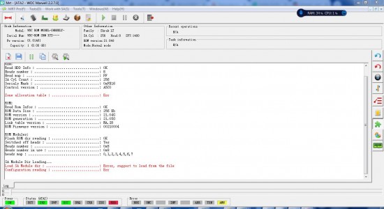

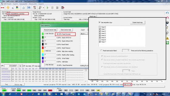

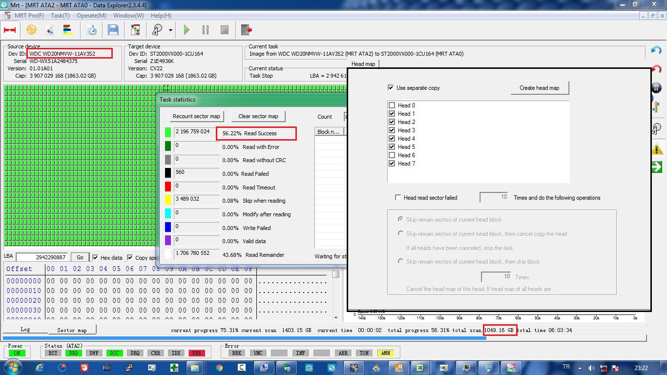

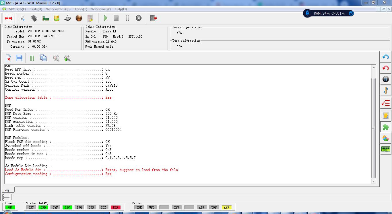

I had WD20NMVW-11AV3S2 drive 1 month before. H0 was bad, I have backed up modules, Rom , LDR. Stopped when I try back up modules by Track. Decided, H1 also dead . I told client that Head swap necessary. Client denied cost 1 month later. And today, I have controlled before send back drive to client..
Loaded from LDR, tested modules.
I checked Copy 1 modules fully good.
copy 0 modules mostly bad.
Head test All heads writing ok, only H6 reading error.
Writed all modules again fom Copy1 backup.
And somehow hdd again accessible.
And started to clone.
In DE H0 and H6 looks bad. But in WD panel head test said only H6 bad. I started cloning other heads.
All 6 Heads mostly good speed and no bad sector. But sometimes H2 and H4 did making thin sound like straching. I removed heads manually when I hear sounds. Reactivated when passed that parts. Again have readed normal. I cloned 1 TB data. (Drive 2TB) Anyway again stopped now.
I guess H1 stil alive as before. This look kinda damaged some parts of SA.
User area mostly look good . I am sure still good.
So my question,
I have original modules, LDR, ROM . But I cannot access to UA part. Any suggestion to access UA again unless headswap.

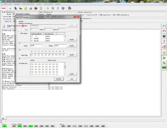

HddDonorMarket wrote:
Spildit wrote:
What does happen if you edit the SA regions in ROM and place values for copy 1 on copy 0 ?
Don't know this mean
this mean,
there are two copies like copy 0 and copy 1. you can boot hdd using copy 1 without loading copy 0 data.
so you have to point starting address of copy 1, doing ROM edit.

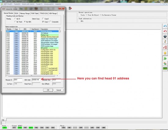

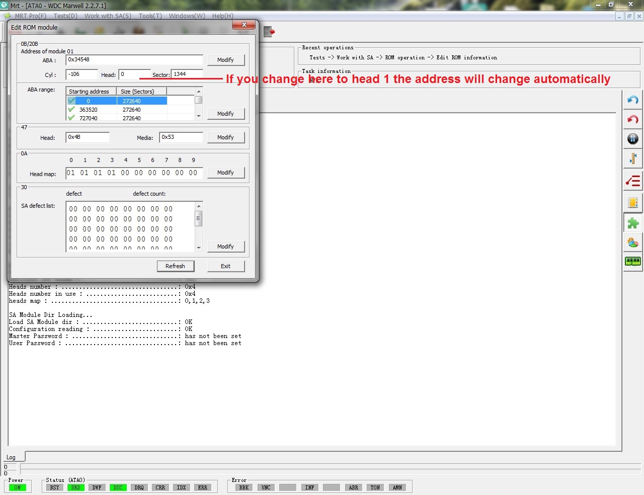

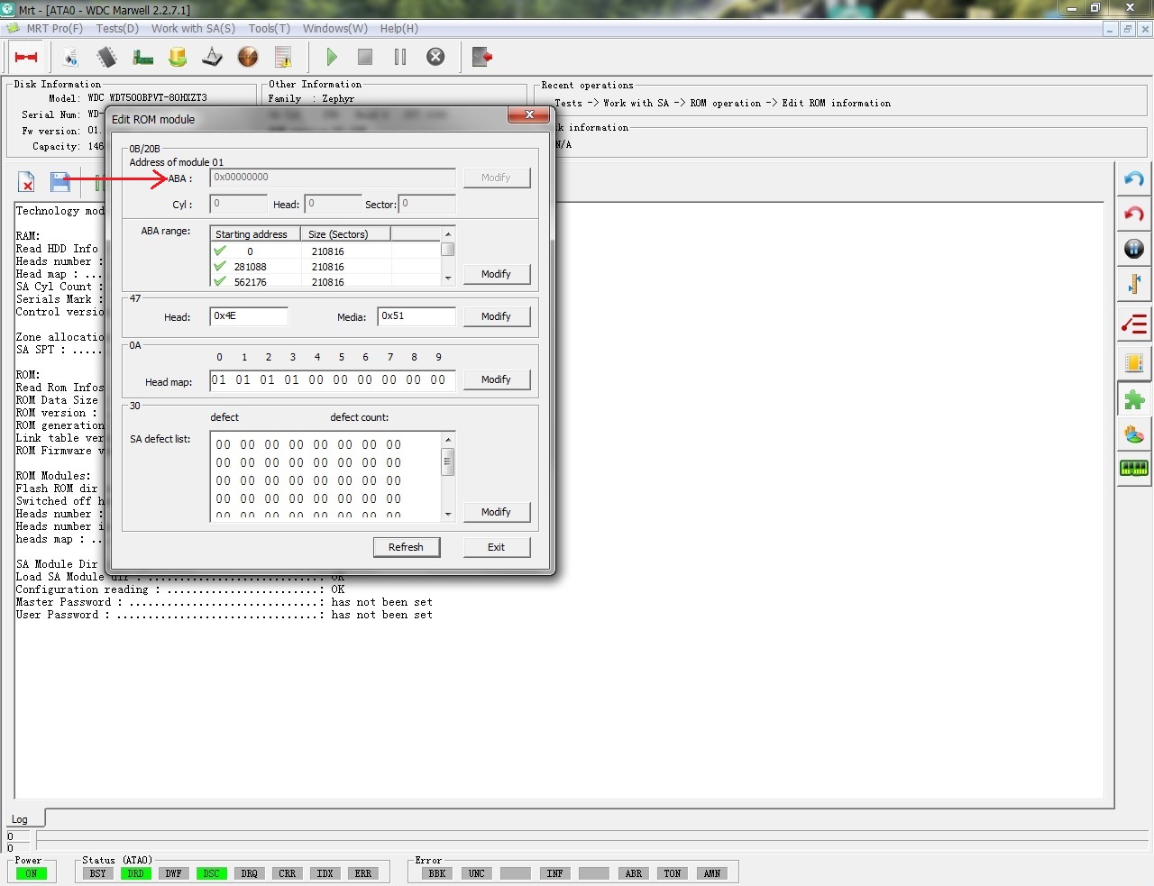

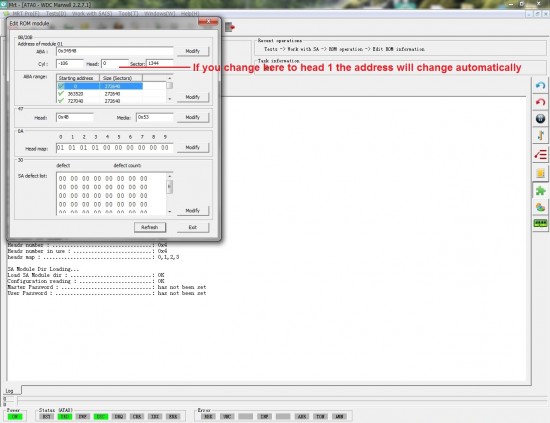

Most wd drives I tried MRT did not support that (it was not available),in drives that seemingly supported when I change address,module 20b will change but even if I will write in good hdd completely wrong address hdd will get ready smoothly with full access so I don't know what exactly effect it did.

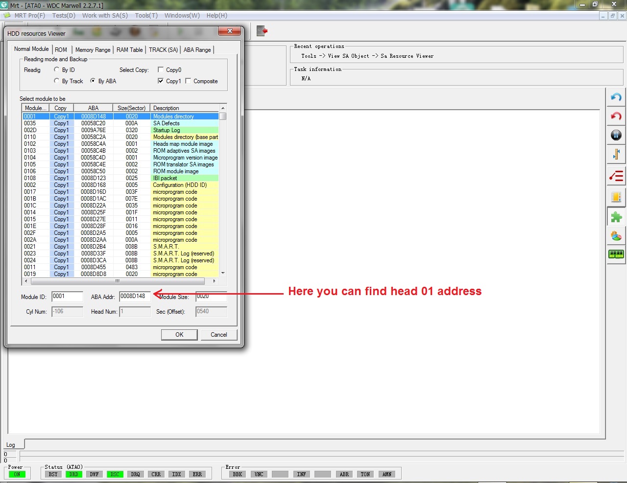

 Post subject: Re: WD20NMVW-11AV3S2 problem
PostPosted: June 19th, 2019, 15:20
Joined: February 1st, 2016, 19:51
Posts: 147
Location: Cyprus
Sorry,I got confused between ABA address of the directory (module 01) in ROM and ABA range of heads in ROM.
Changing head 1 ABA address to head 0 does work in MRT ! and if you write wrong address hdd will not be recognized.
