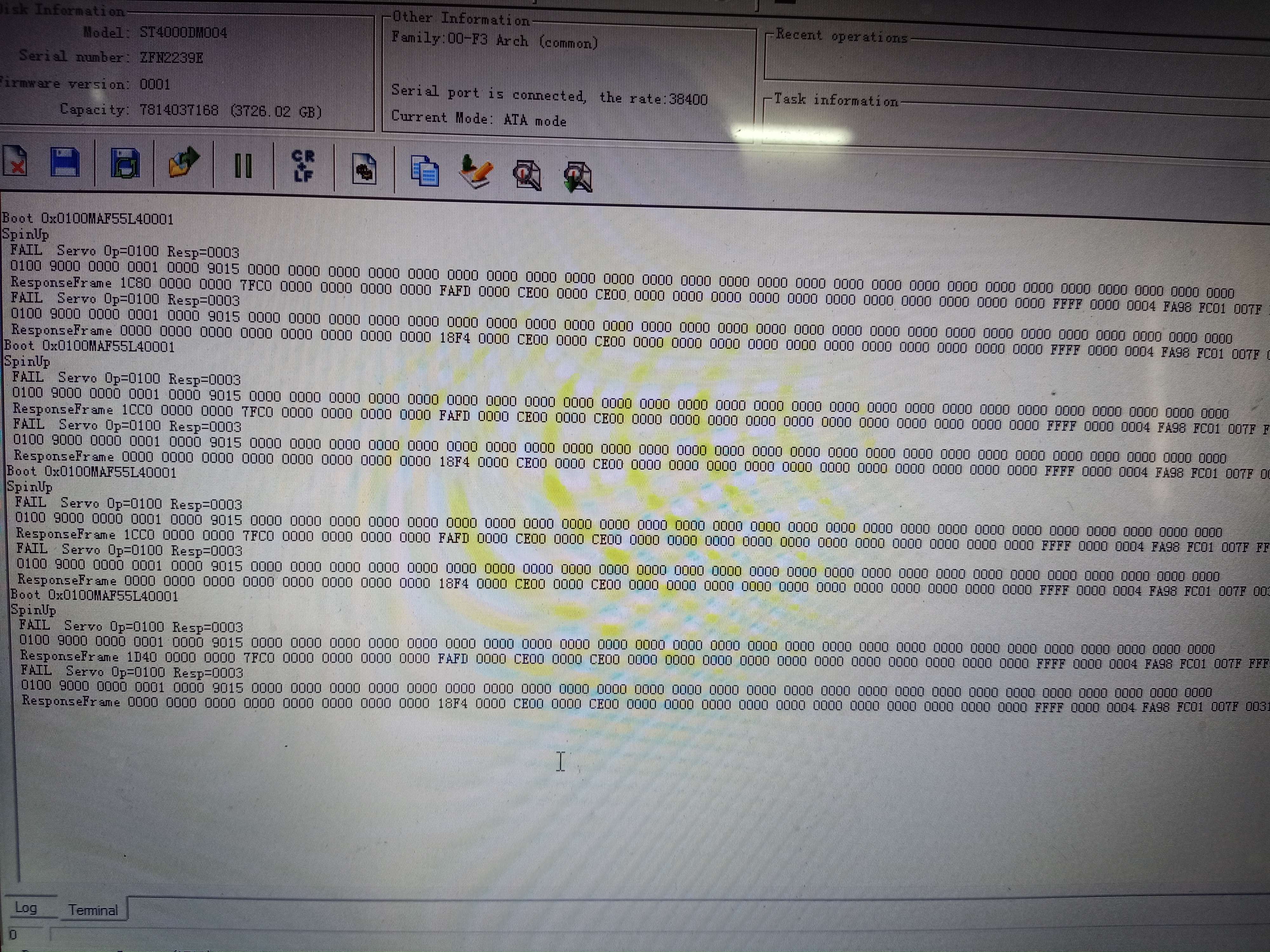

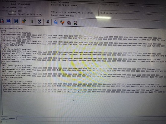

 Post subject: No click sound after head swap but terminal show heads gone
PostPosted: September 28th, 2019, 6:32
Joined: August 20th, 2015, 9:00
Posts: 58
St4000dm004
2cv104-569
001
Same terminal before head swap
After head swap
Spinup normally
No head move (as reference from sound)
Spin down
 Post subject: Re: No click sound after head swap but terminal show heads g
PostPosted: September 30th, 2019, 4:25
Posts: 347
Location: india
try by editing logical headmap in rom
