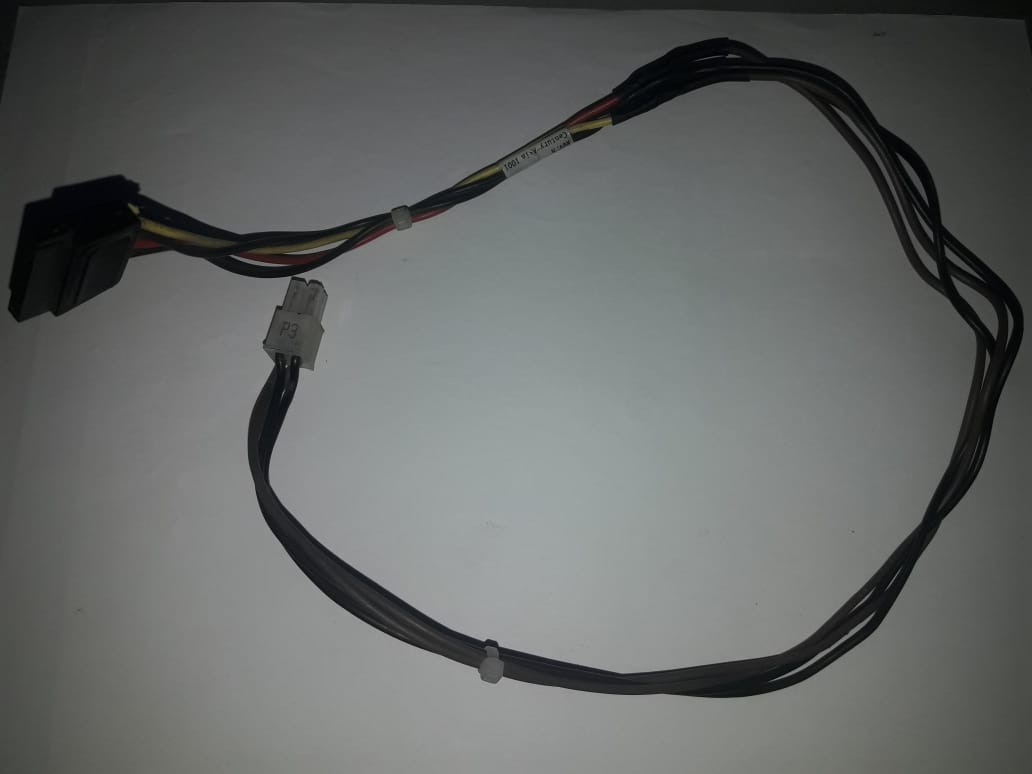

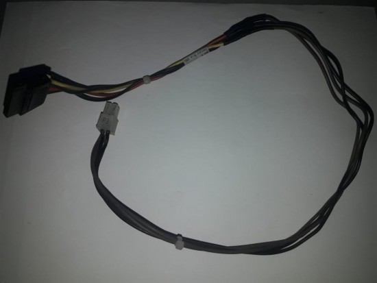

As @michael chiklis says, there is a problem of the 5v power output of the MRTLAB, in fact the source input is correct, but when you power the hard drives the output channels, the voltage of 5v drops between 0.1v and 0.5v and that is what makes the disks connect and disconnect.
You have to be very careful, as it may seem that the disk is bad and it really is the power failure of the MRTLAB. Also say that it occurs on very few disks and you can try to power the disk with an external power supply.
In the same way the application has many errors, but still it is a very interesting option with which many disks can be fixed.
I also face this problem but solved,for your kind information just change both SATA power connector of MRT card .

Yes, you can solve the issue temporaly by changing power cable (a new cable helps a lot when the issue on mrt card port is at the begin).
After few weeks/months it will get worse and so changing the power cable or data cable (or both) will not help anymore.
Also, i've noticed that when you clone in DE in this condition, another very annoying issue will appear. This bad issue will sometimes write zero bytes on destination drive and you'll see green square on sector map, but if you check on source drive those sectors you will find out that are not zero.
This is very bad because if you are not very carefull and expert you'll not notice this issue, this will partially screw your data recovery job.
I've noticed this issue few days ago because i'm working with a very slow Helios family drive which has a lot of bad sectors on surface, i was forcing to read few sectors by double clicking on few of those squares, i've noticed that few hundred of consecutive sectors where read as zero after i've saw that the relative jpg file was corrupt. Then i did scan those relative sectors directly on source drive and i saw that they weren't zeros, so i've cleaned sector map of that file and repeated the reading and finally i got a REAL good reading and of course a good file (this time i had connected destination drive directly to my pc sata port).
I don't trust this DE cloning so i'm repeating it, this time destination drive is attached to pc sata port since the begin.
I can't trust anymore my ATA 1 port of my mrt card until i will be able to fix (still waiting those components from aliexpress).
