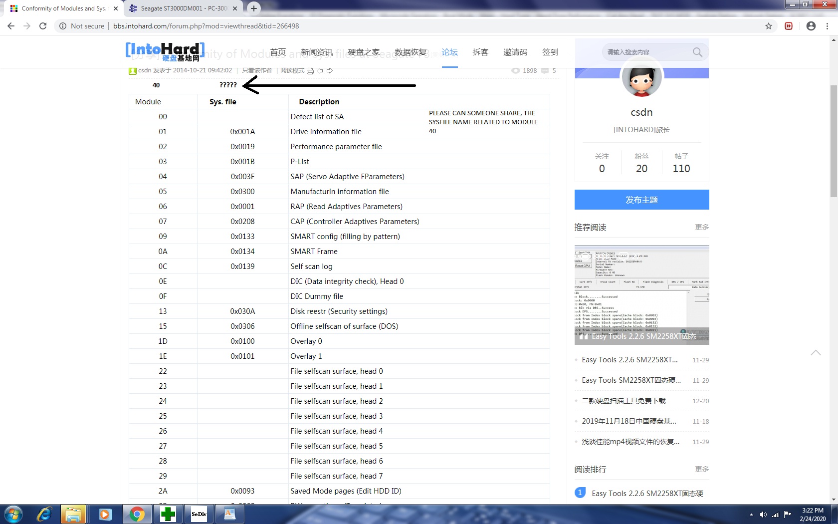

hi
please share the name of sys file related to module 40
