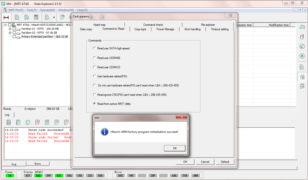

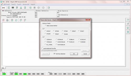

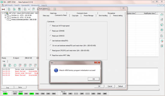

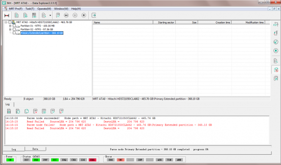

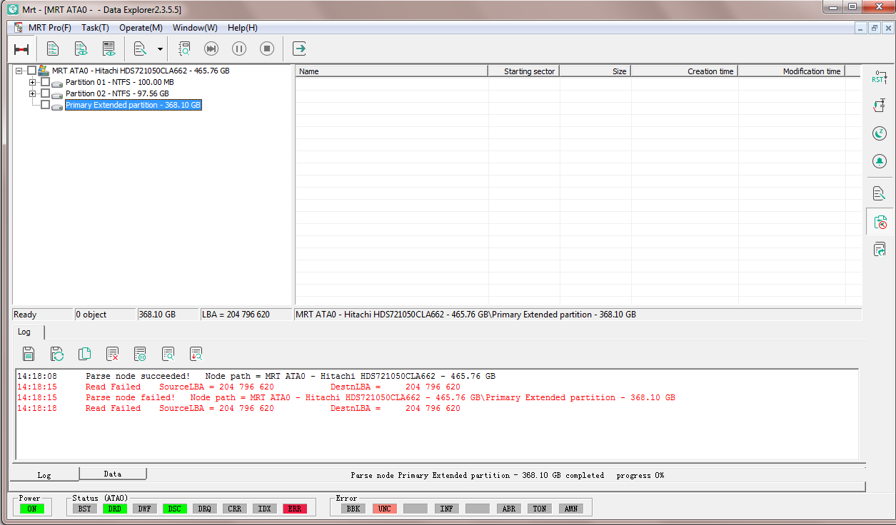

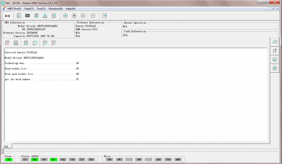

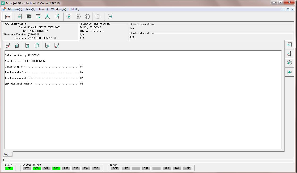

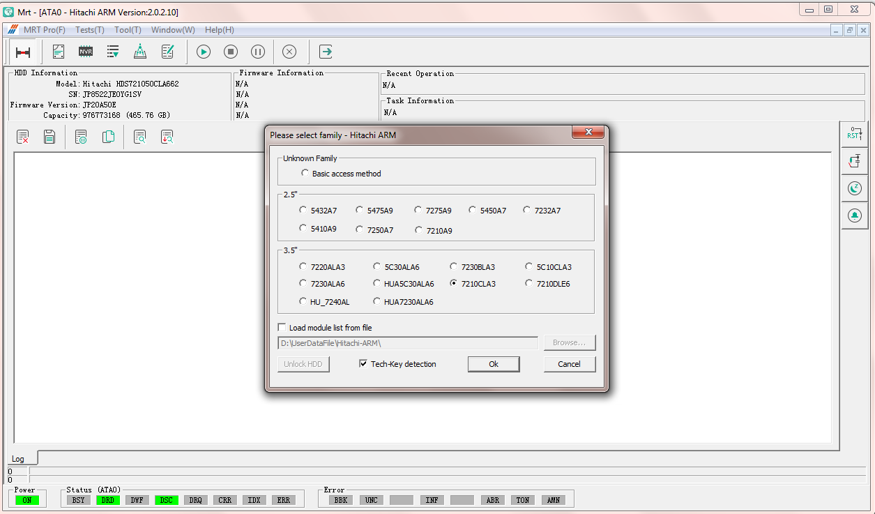

See the Attach Screens.
a. I could able to copy Part-1/2 data.
b. But Part-3 data could not copy.
Modules : Bad
HLR1 - Factory test Log Module (HLRC)
HLR2 - Factory test log module (HLRC.copy)
DDD0 - DDD Utility log Module
WRT0 - Marker at head 0
WRT1 - Marker at head 1
SA Test: Failed
WWNM_0
HLR1
HLR2
DDD0
WRT0
WRT1
RAM BACKUP: Error
ELG1
EVLG
PID1
PID2
PIDM
PDM1
PDM2
HLR1
HLR2
MFGP
AMPM
MFGT
DMP1
SDM1
SVLG
DDD0
DIAG
WRT0
WRT1
Head 0 - OK
Head 1 - very slow reading - problem.
Suggest best way to get the data for partition 3.
