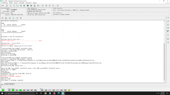

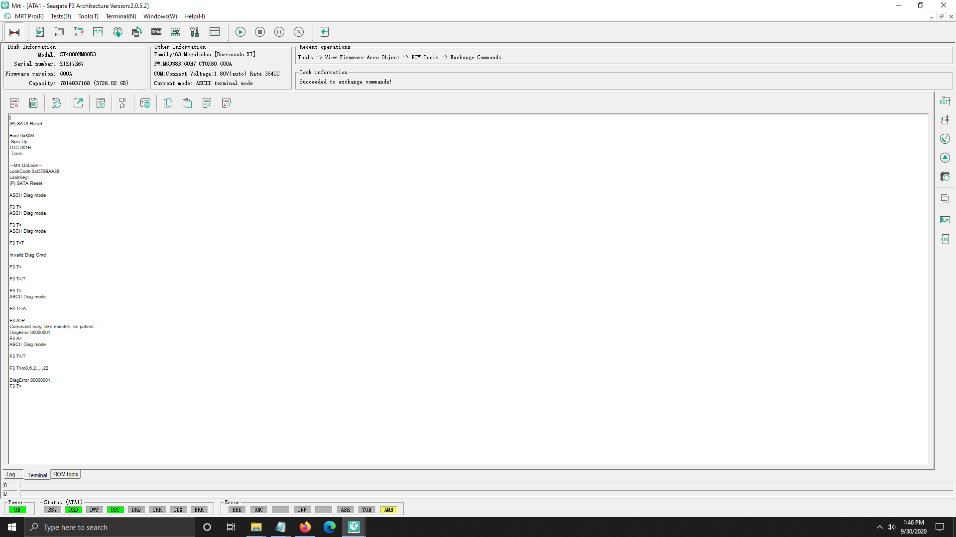

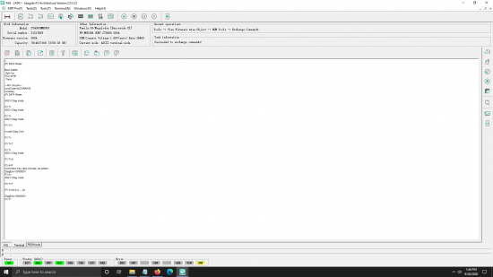

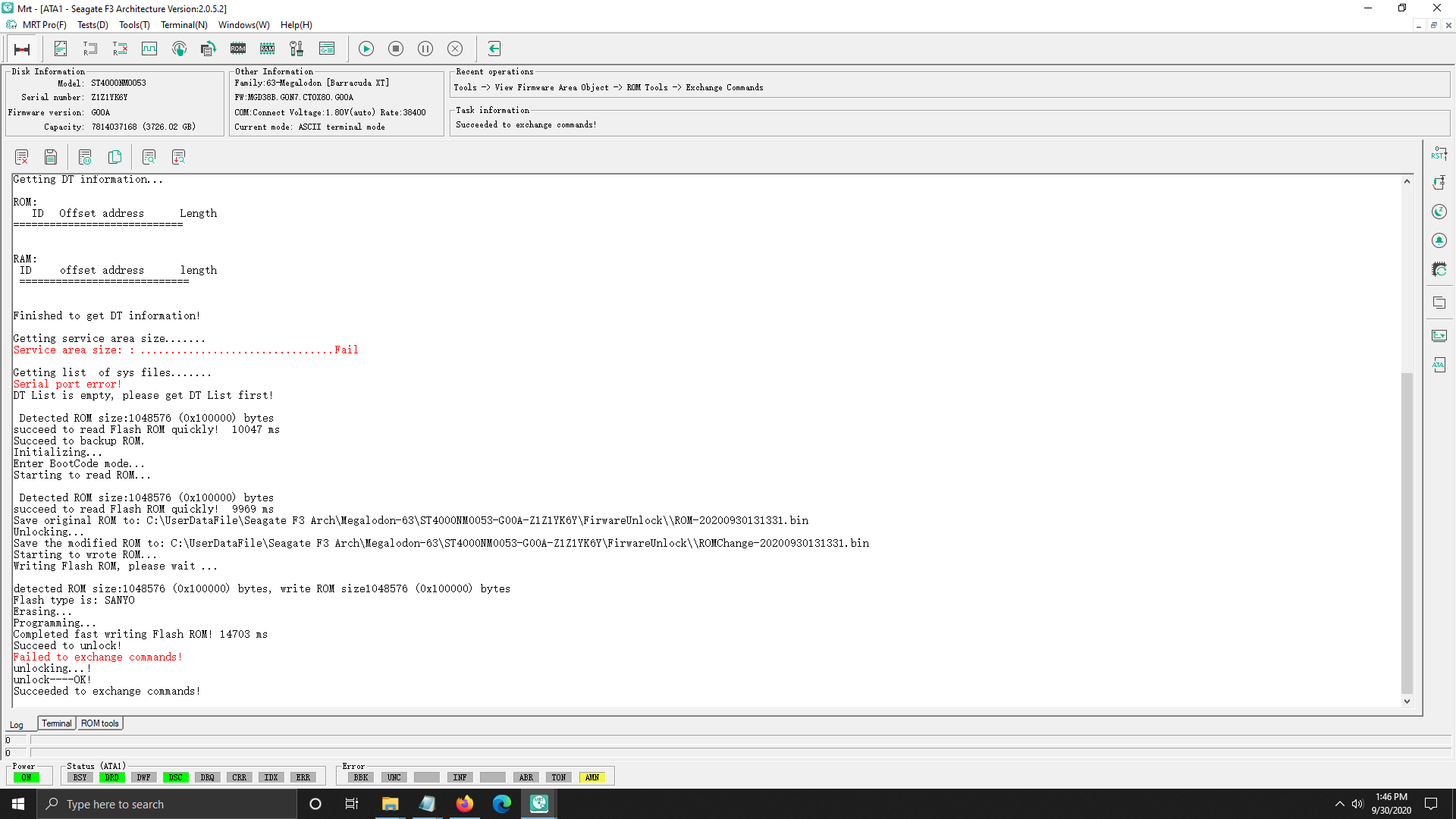

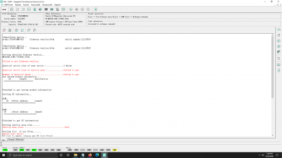

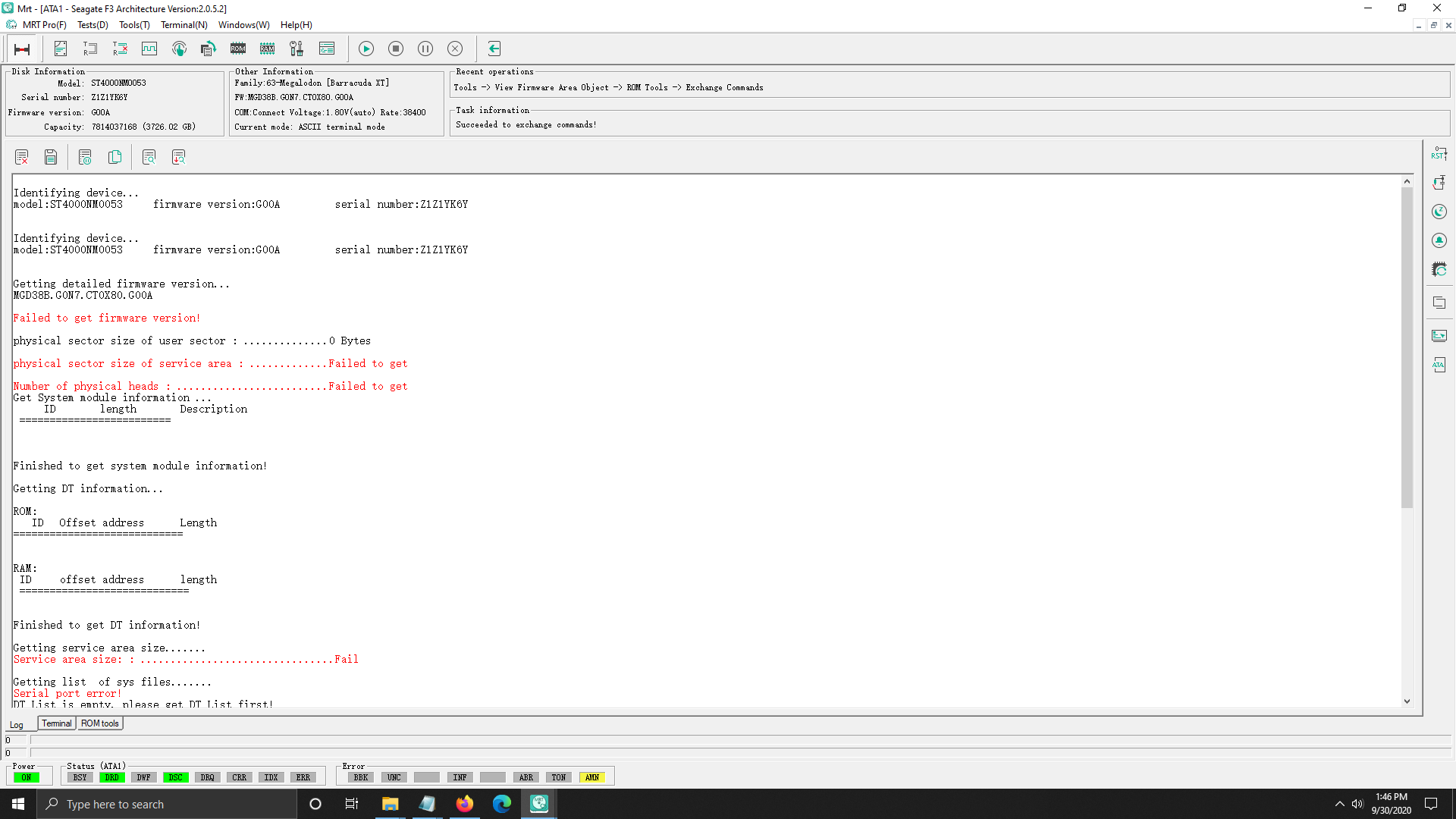

I'm having some issues with this drive (ST4000nm053) *Megalodon. I'm able read rom and unlock, but I get this error "DiagError 00000001" after executing commands. The only one that works is clear smart. I just want repair the drive, no data recovery. No clicking noises or knocking noises, runs fine. Any input is appreciated.

Hi
As you can see , the utility can't find modules or DT or sys files when entering....It is still locked I suppose....Or the unlock procedure was not finished correctly....or MRT can not unlock this drives yet...
In this state you can't do anything in terminal....It needs to be unlocked first.

This one requires another type of unlock... Very simple though.
Using MRT or another software? I also have PC-3000 but same issue there.
