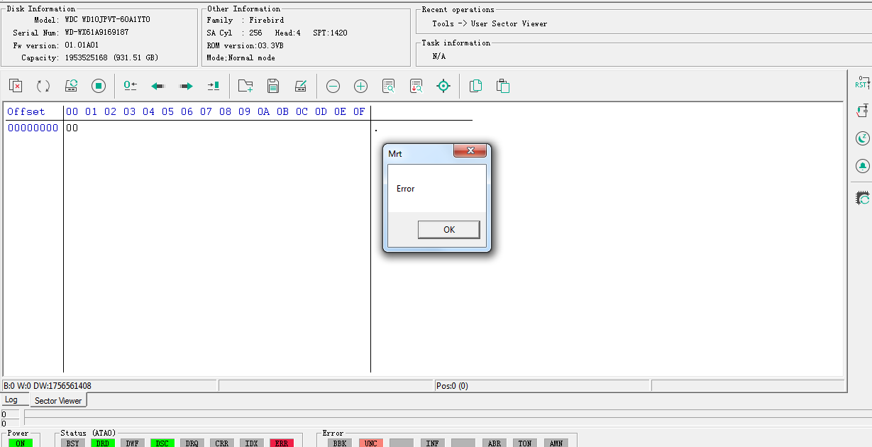

 Post subject: WDC WD10JPVT-60A1YT0 - Western Digital 1 TB
PostPosted: October 31st, 2020, 9:32
Joined: July 10th, 2020, 7:34
Posts: 51

See the Attach Image -
While Making IMAGE or DE it gives errors?
what is Best way to get data ?

Further diagnosis required.
Did you try to read random sectors ?
Yes few sectors read and few not read.
even try disabling head 0,1,2,3 - after few sector read it gives error on all head.
it seems user access area has problem?

Posts: 1726
Head/s problem and/or media degradation.
Did you try to read with every single head separately?
