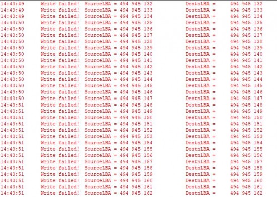

Hello Folks,
I was working a HDD Samsung M8E. Try to recover data from this faulty drive getting below error.
I am using MRT Express card.
[EV:364D RD_PROV_CURE:0001 RD_PEND_CURE:0000 WR_CURE:0000 RD_VIRGIN:0000]
Num Defects/Entries: 60
| 0 | 1140 | 0008 | 0000005F0 000080.0.0BE -> FFFF ADBEEF.0.000 |

Try to Image Head by Head but still same error. Kindly help me.....
Any suggestion appreciated.
Thanks and Regards,
Aloke
Author:  paul200310 [ January 10th, 2021, 2:04 ]
Post subject:  Re: Samsung M8E issue Update
Copy Head by Head but still all head same write error issue.
Thanks and Regards,
Aloke

I think it is a problem with destination/task settings rather than with the Samsung hdd. In samsung utility, go to Tools->User sector view and check if you can read any sector. If sectors can be read, the problem is elsewhere.
Rgds.

Author:  vx1 [ January 14th, 2021, 16:17 ]
+1
Your destination disk has a problem and needs to be replaced!
... write error issue...
Author:  saltwater [ February 9th, 2021, 18:08 ]
The destination disk is mounted by windows.
Modify sector 0 last byte from 55AA to something else
