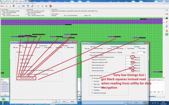

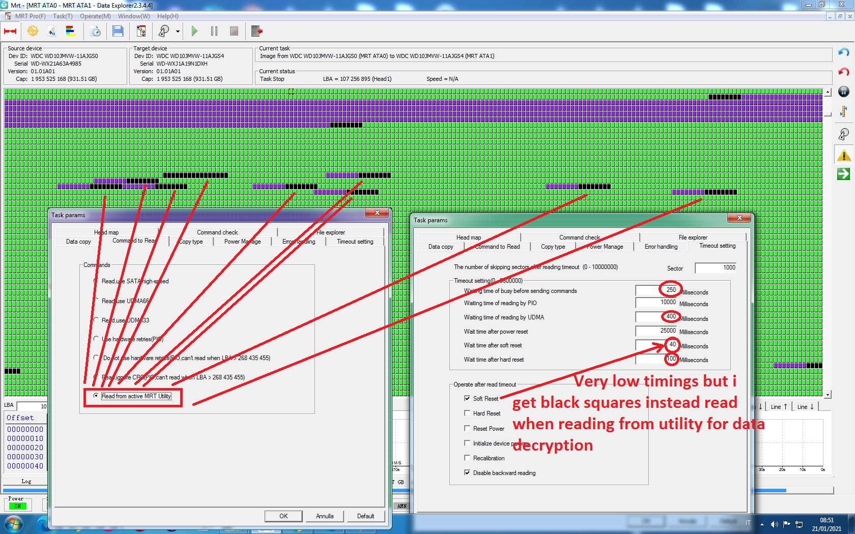

Impossible to jump bad sectors quickly when cloning WD drives while on fly decryption is turned on.
If i change timing settings to minimum i still get black squares and still slow reading.
The only way to jump bad sectors quickly is reading without decryption on.
I talked to MRT staff on skype and shown the videos, but they didn't understand.
As we all know, for example, they haven't understood yet the long path bug!
https://youtu.be/QfvnMKlYvKc
https://youtu.be/Q5pSD4HW458

When i read through sata/UDMA/PIO mode i can jump bad sectors very fast (they get coloured by red instead black)
