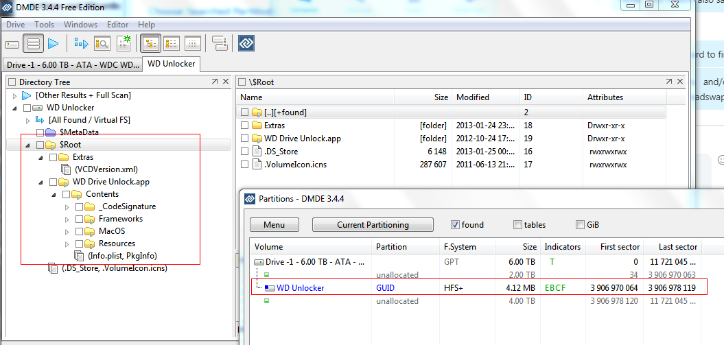

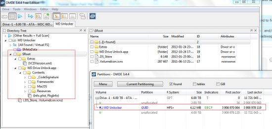

Head 0 bad. I have imaged all other heads data fully.
User data look like encrypted. I have checked target drive in windows after clone . I saw a WD partiton end of drive
It is now working automaticly (autorun not runing when plug in drive)

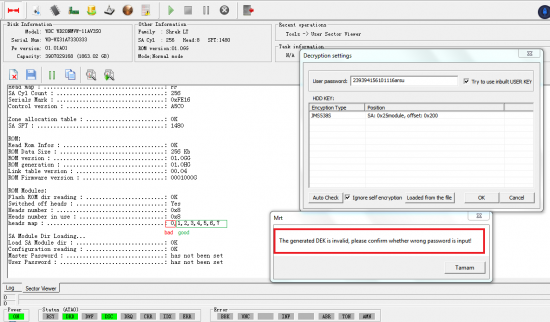

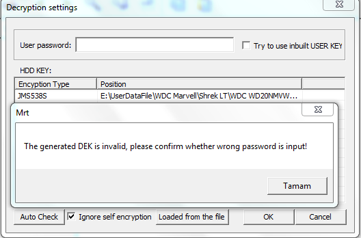

User have user password. Tried decrypt with this password. but there is an error like this.

I have searched google. Couldn't find a solution for this case. Also MRT tecnician joined . And said its WD security password. But how could decrypt this data?
What is your advices.

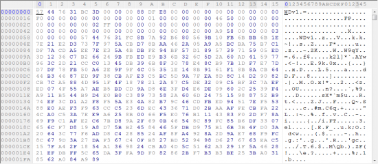

MRT doesn't extract EDEK correctly from that type of encryption.
I have made a video on how to manually extract EDEK from module 25 with an hex editor.
https://youtu.be/_qrs7PgStGU
The interesting part starts from 2m 40s

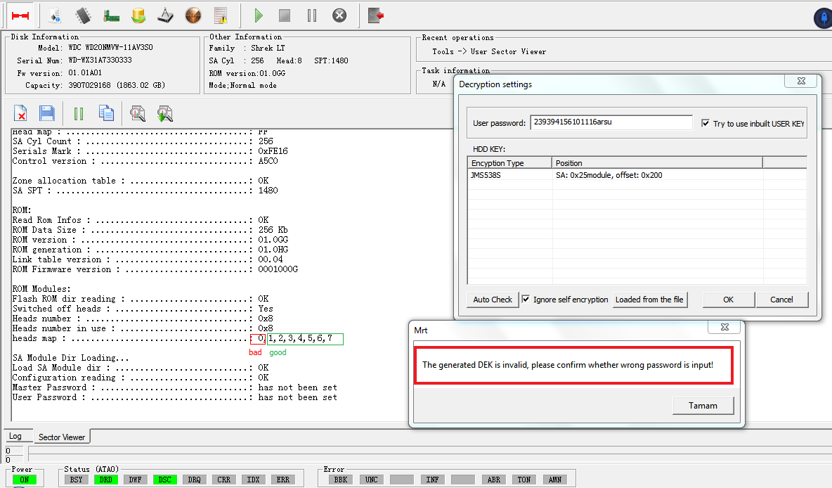

I have watched this video before. And tried before open tag here. And tried same thing as video again. Error same

Case solved.
MRT could not decrypt this issue
