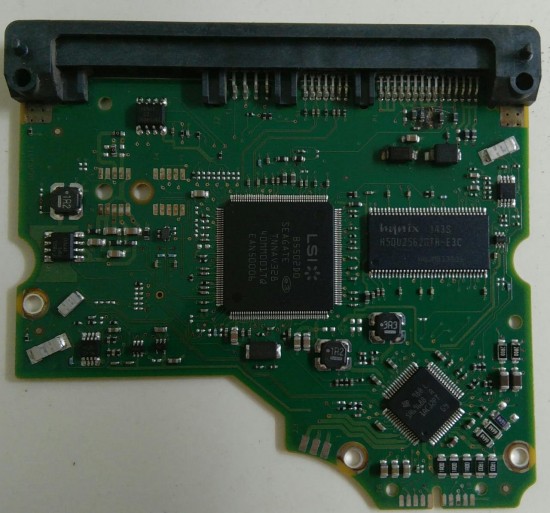

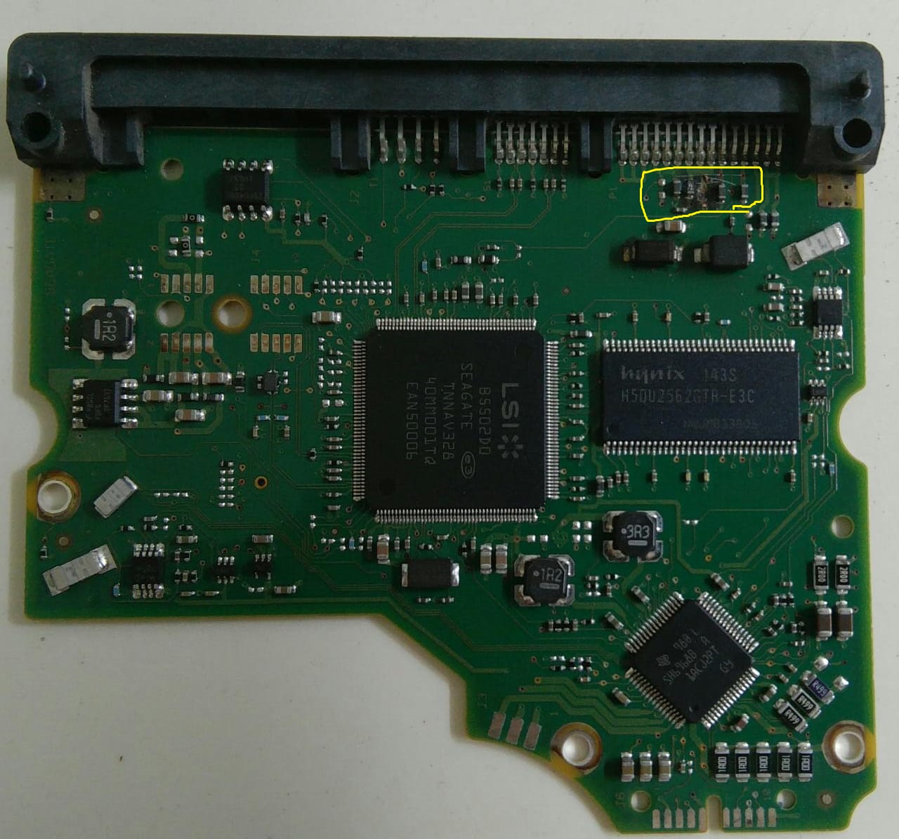

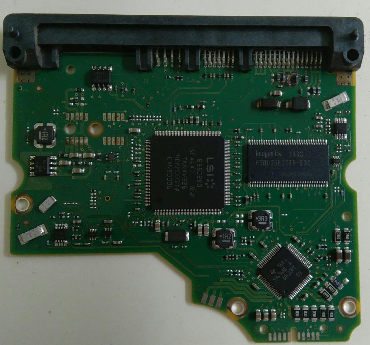

 Post subject: ST31000524AS - FW:HP64 PCB:100574451 REV B - (pcb is BURNT)
PostPosted: September 10th, 2021, 5:39
Joined: July 10th, 2020, 7:34
Posts: 52

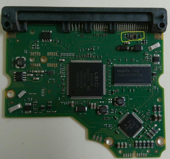

See the image (PCB upper right side)

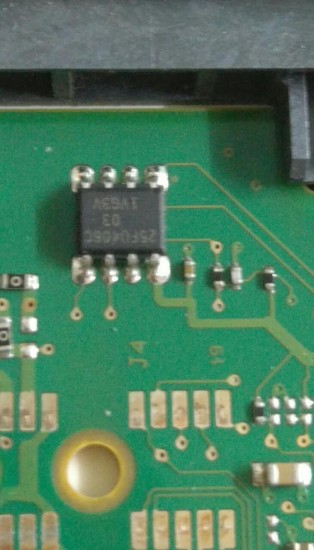

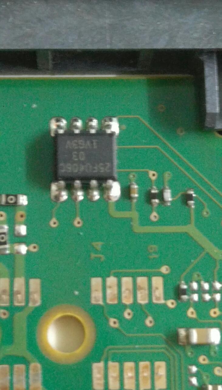

ROM is BLANK - (ORG PCB)
any way to Re-generate ???

Normally to fix this PCB you would remove the shorted 5V TVS diode and run a wire from the diode's cathode pad to the +5V pins at the SATA power connector.
http://www.users.on.net/~fzabkar/HDD/5V_TVS_fix.jpg

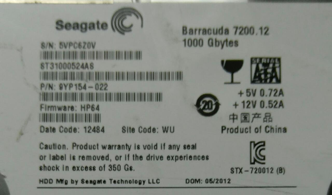

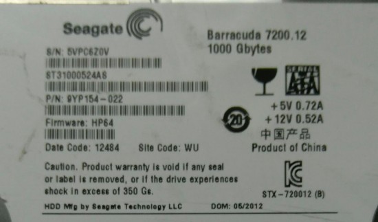

HDD front cover image and Video link https://youtu.be/0WPWAZzETJI
Thanks for the reply.

Yes - Externally Read the ROM - IT IS BLANK.

Oh, i missed that, in fact i didn't think you would post a video with donor rom, as it is really pointless unless you want to check if your tool reads rom properly.
On the other hand, how did you try reading patient ROM? Have you tried external readers? MRT won't get anything from a damaged pcb even if ROM is fine.

1. Tried Damaged PCB - Successful But BLANK. ( it is clear, INTIALLY ORG ROM is BLANK).
2. Tried Good PCB ROM READ - Successful.

Have you tried external readers? Yes
with desoldering the patient rom?
coz you may not be able to read it in circuit if the power rail is shorted for example.
soldered it to donor pcb?
