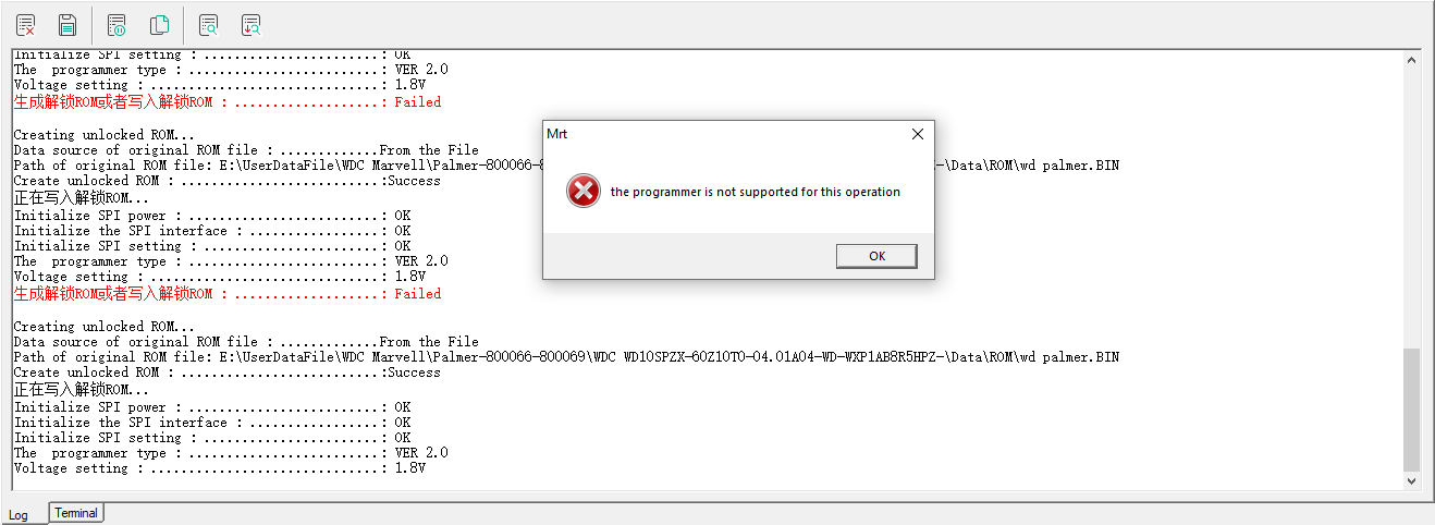

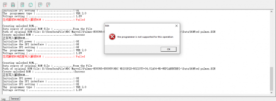

PostPosted: January 14th, 2022, 10:25
Joined: June 26th, 2019, 8:55
Posts: 43
Location: Indore, India
I am Having this error , Any Solution ? Does MRT Strictly Requires Programmer 3.0 .
I have Programmer 2.0 .
Please Help .

 Post subject: Re: MRT Software Update Advance Announcement 2021.09
PostPosted: January 15th, 2022, 4:55
Posts: 411
Location: Romania
Did you connected the ver 2.0 programmer to the MRT board?

DR-Kiev wrote:
Programmer has no much matter since you can desolder ROM read it using different pcb or cheap programmer, patch it as ROM file in MRT , write and solder back.
That is the problem.......In the last version of the software, when you try to patch from file, not from programmer, it still asks for programmer to be present.
I have talked with them and they say it's a "strategy ". They prohibit use of other hardware with MRT software.....
In other words, if we want to patch from file we will need the ver 3.0 programmer. Shame on them. It's not fair.
www.datasave.ro
PostPosted: January 18th, 2022, 2:44
Posts: 43
ccc wrote:
But Some are saying that it is working on there PCs with old Programmer without any errors.
ruivo2 wrote:
MRT Unlock Rom Palmer pcb 800066
Very nice work MRT Lab!
Follow link;
https://www.youtube.com/watch?v=ncxHp4BvWKM
HERE , In Above video it doesn't ask for any Programmer.
PostPosted: January 18th, 2022, 3:03
Posts: 411
Location: Romania
It was the first 2171 version of software that was working without asking for programmer.
www.datasave.ro
