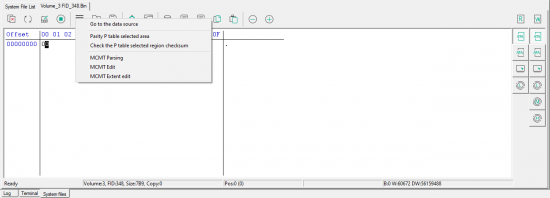

Seagate F3, update to 2.0.7.0:
1. Added MCMT parse function.
2. Added MCMT edit function.
3. Added MCMT Extent edit function.
Where are these functions in MRT 2.1.7.x ? I can't find them
 Post subject: Re: MRT Ver 2.1.7.1 Software Update ?
PostPosted: March 26th, 2022, 1:11
Joined: June 26th, 2019, 8:55
Posts: 43
Location: Indore, India
Here

EnigmaSpace wrote:
Here
Thankyou
