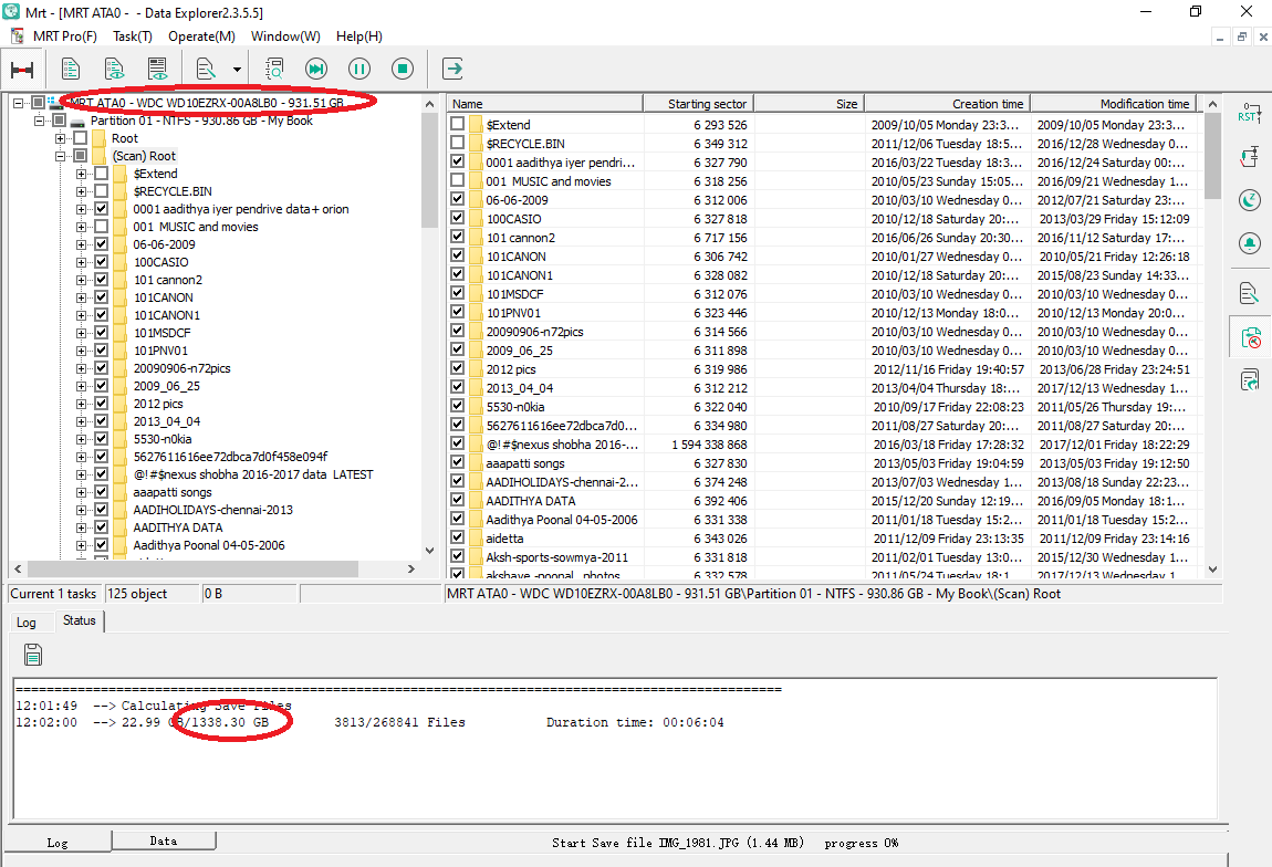

First made Image of External USB drive on equal size Clean drive i.e. 1 TB to 1 TB
Next done SCAN Root and selected the files it is showing 1338.30 GB
Still could not figure our 930.86 GB holds 1338.30 GB
see the attach file.

It's probably previously deleted data. They won't work.
only (Scan) Root - This is counted.
(Scan) - Deleted file - Not counted
(Scan) - Lost file - Not Counted.
 Post subject: Re: Funny problem - Western Digital
PostPosted: March 11th, 2022, 11:16
There are several possible causes. Could be mishandling of folder junctions, a botched-up file size, files it thinks aren't deleted that really were, or it could just be the MRT software itself miscalculating the total.
Personally, I'd switch to something like UFS Explorer at this point if your image is fairly complete.

Personally I never use Mrt after imaging, Use UFS or R-studio instead.
