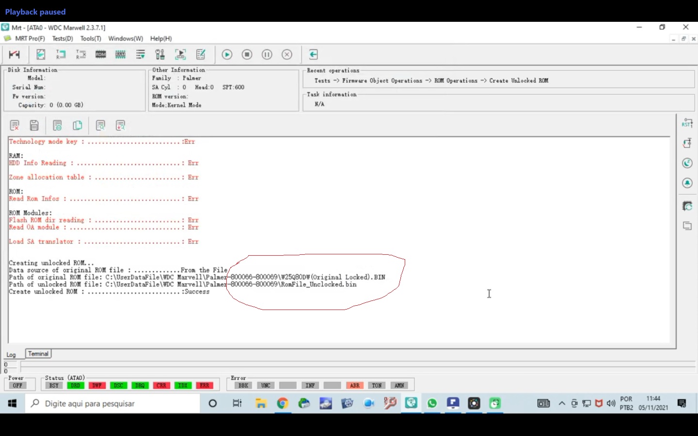

Hello Engineers
In the instructional video about unlocking ROM 800066, 2 files are uploaded.
I could not unlock the ROM and I do not have a file like the tutorial video to unlock the ROM,
Please if anyone can help me and give me the file
Thankful

Hi. You need the original Rom from locked/original pcb. That's the first file. The second file is generated by the software.
Good luck.
